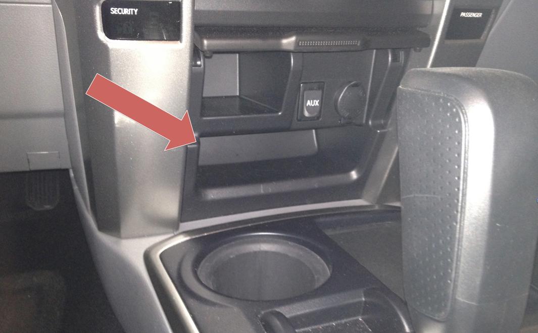

Quick question; I am installing my CB soon It's a Cobra 19DXIV and wanting to place it in the most bottom section of the dash. Basically right below the "cubby" section you routed your extension. If you can remember, can you tell me how much space was behind there, I believe i just need a few inches (that's what she said, lol). i would like to cut out the back and slide it in. Thanks and let me know your thoughts.
Okki,
Basically, in the picture here.
I'll have to dig through some pics, but basically you only have the space of the indicated area and nothing more. there is a bunch of air channels behind there (to route to the rear center heating/cooling vents). I'm not sure how big your unit is (HAHAHA) but if you can't slide it into the space you indicated, you are likely out of luck. that's why I ended up mounting my control unit in the center tunnel closest space available.
Okki
EDIT:
dug up some pics... judge for yourself, but I think you may want to look for an alternate location or a different CB unit. you have a little left-right wiggle room, but nothing in terms of depth.

Sorry for the delayed response. Was out of town on business and had zero internet except iPhone. Thanks for digging up the pics, I truly appreciate it. Looks like it's going to be center console then like everyone else.
