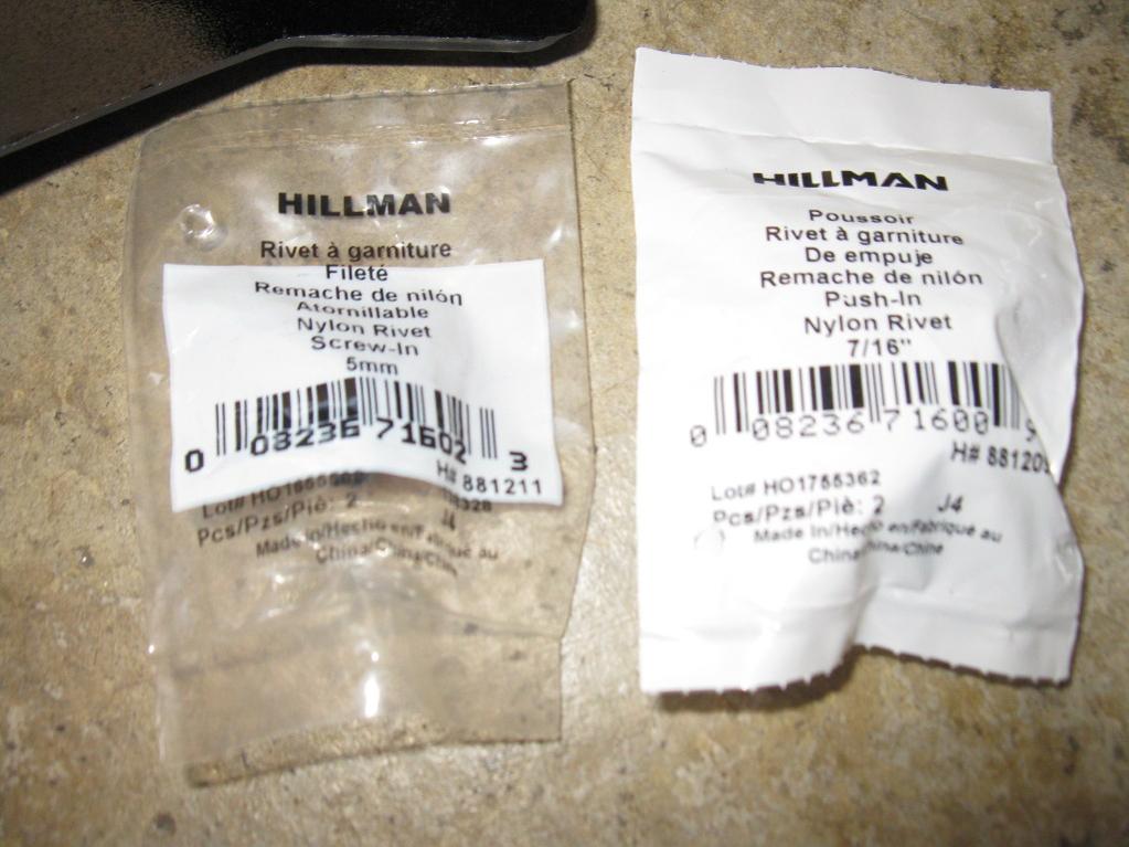

Installing the TE front mudguards:
For the mud guards you will be missing some clips. I ran down to Lowes and for just over $2 I got 4 clips to lock the mudguards in place. The screws keep them on the truck, but the clips keep them from being able to sway back and forth. I used a 5MM screw-in and a 7/16 nylon rivet. I wasn't sure which one would fit better, so I got some of each. The 7/16 rivet is the slightly snugger fitting option, so I would probably use those on both holes.
