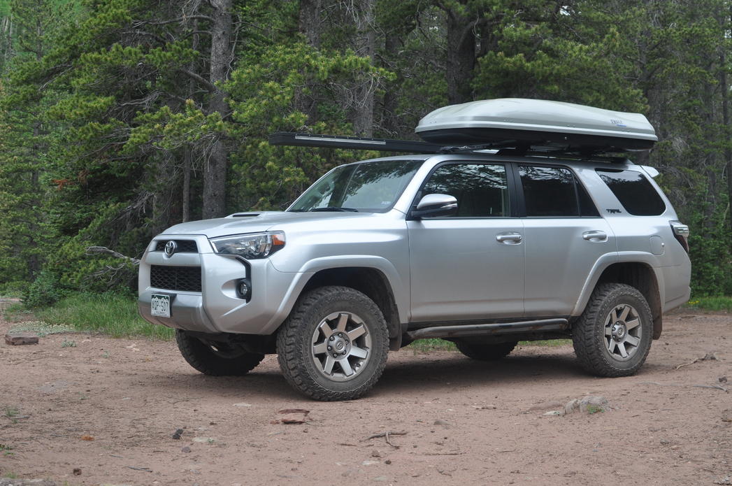

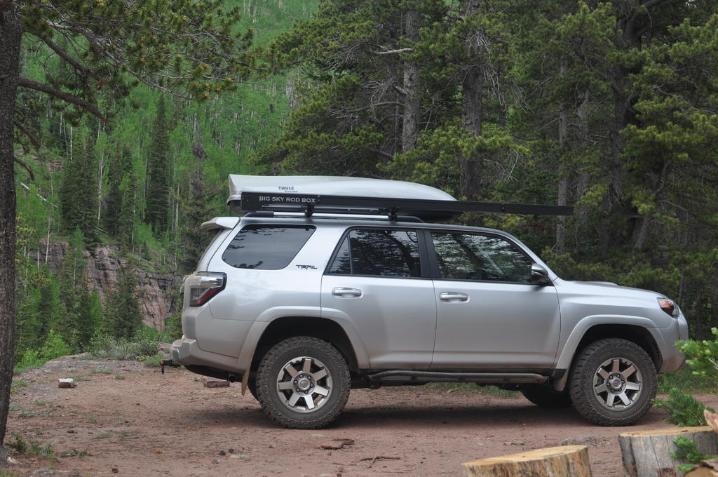

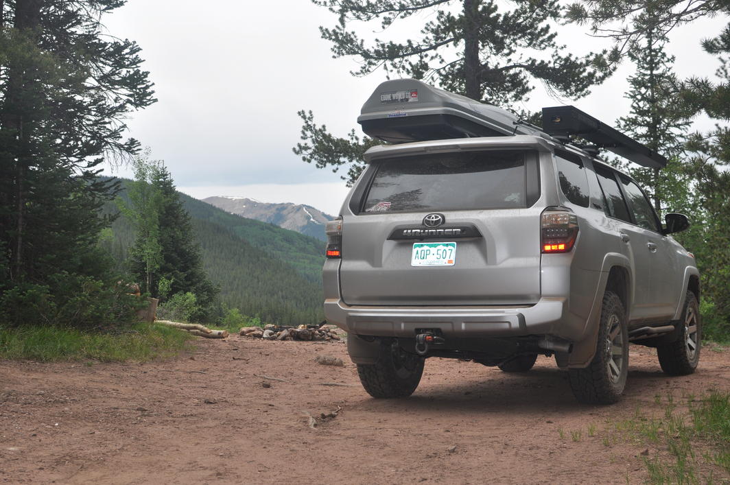

The OME 895E springs gave me a little over 1.5 inches of rear lift coupled with OME nitrocharger shocks. Slee Offroad did my install, and actually called it a "low lift". Rides great, no complaints at all.

Here's a few (car had a pretty good load of gear in the back at the time of the pics):

Nice rig! Thanks for adding the photos. Does the rear sit much higher without the load?
Also, how much is the front raised?

Front has OME 883 coils which gave a similar amount of lift as the rear. I've had probably 250+ lbs loaded in the back and really didn't notice any obvious sag at all, but haven't actually measured to see if it did drop. Really has been a good set up for my needs, which consists of daily driver and weekend "overlanding" (for lack of a better term) duties.
