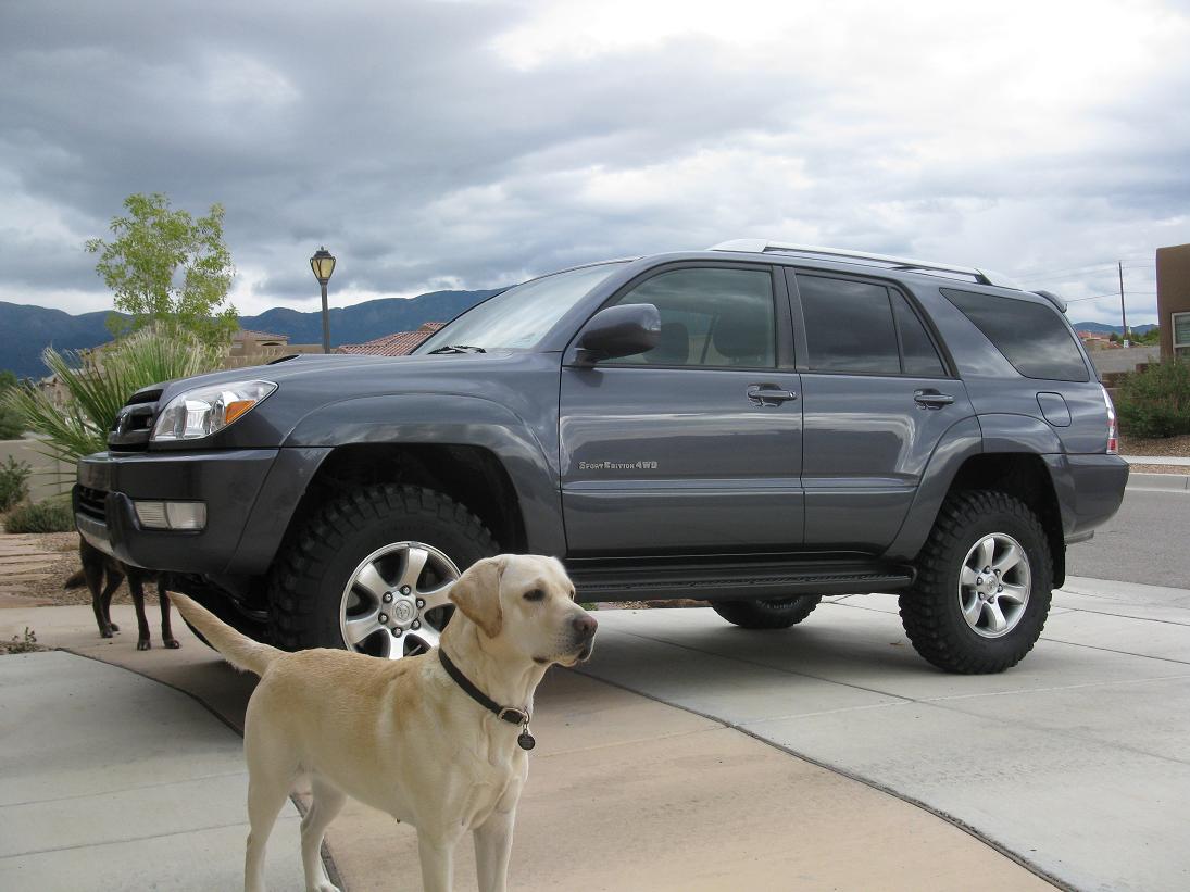

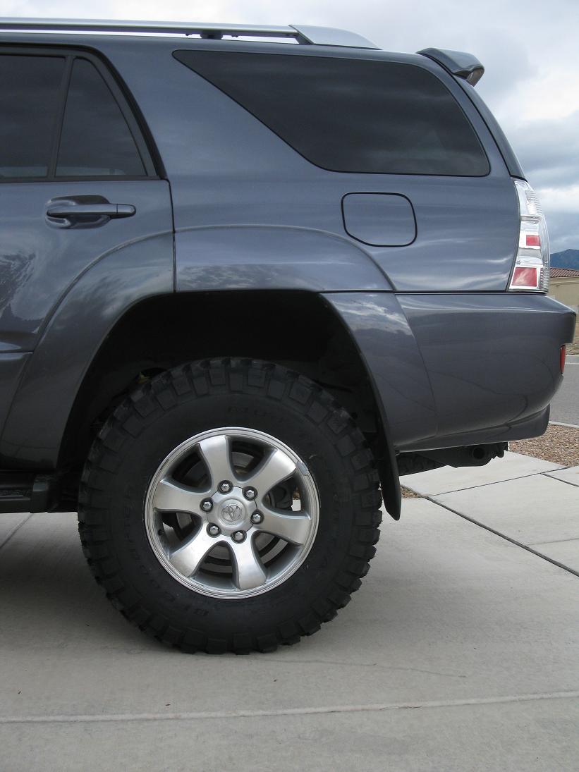

Just wanted to let you know that I easily fit 33" tires (255/80/17) on my 2003 4x4 V8 sport 4runner with a 2.5" OME susp. lift. The 285/70/17's are also 33 inch tires in height but are too wide so that size rubs. I'm not using spacers. No rubbing! This girly knows how to tire shop....love my BFG KM2 muds! Next step, Shrockworks bumper w/PIAA's and sliders in black semi-gloss.

That looks soooooooo good!:bigok: Love tall-skinnies. It's the 255's and no spacers that makes that work. If you decide to do spacers you'll have to trim some.
Beautiful lab too:D
