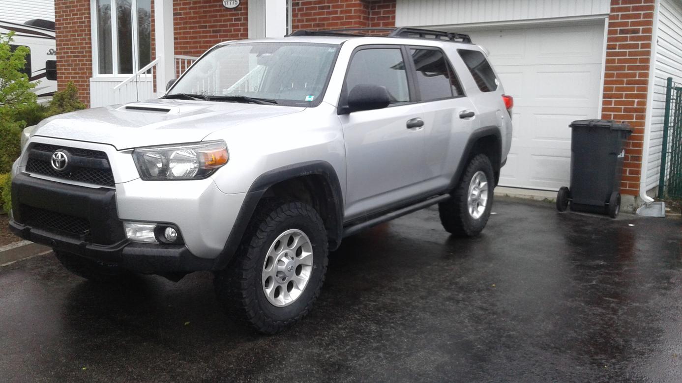

I have bilstein 5100 all around, 112620 in front and Toytec Superflex in the back. I also installed BFG KO2 275/70/R17 last week. I really love the look and the ride is stiff, but coming from a 28 years old diesel Land Cruiser it's still a comfortable ride.
