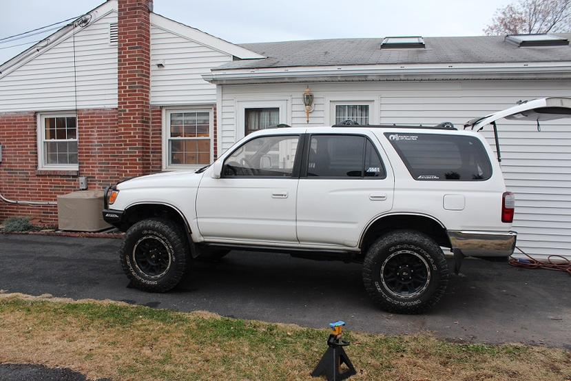

In my experience the 890s like to sag once you start loading them up. Th truck sat level when I had no weight in the back, but after the drawers and a sub box were built the truck sat 1/2" lower than the front. Of course you can lower the front to keep it level, but I wanted to retain my full 3" lift in the front.
As far as ride quality, nothing you choose will give you a "good" ride, but imo it rode how the truck should.
Here's how the truck sat with the 890s and +120lbs

Exactly how my 4runner sits with a tool bag, gym bag and other stuff. U can just tell it sags just a little lol. 890 and 891 both give 3" lift correct ? Air bags for coils ? How does that work
