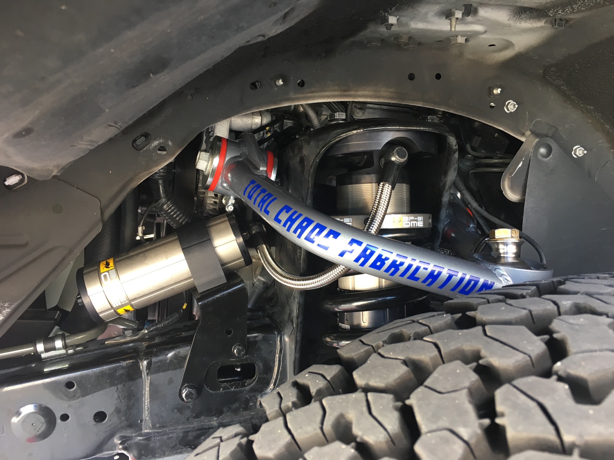

I just had my BP-51's installed a couple of weeks back. I ordered from Toytec and had an issue during the install with the driver's side reservoir mounting bracket (would not fit due to KDSS lines) - the one they sent me was a mirror of the passenger side bracket, but I was able to custom fab a mount that ended up working out perfectly. Before deciding to fab the bracket myself, I called ARB to see if their technicians could advise a solution, and they stated there is still no kit that is made specifically for the 5th gen 4Runner, just the FJ.
All details, I'm loving the ride and performance of the OME's so far. Not sure if this helps answer the question at hand!

I'm curious what you all have your compression and rebound at? I know the settings "could" change based on rear springs, load, front weight blah blah blah, but would still like to hear a few numbers from folks and your experiences off road at those settings.
For the Front, I'm at Rebound 6 and Compression 8 - Pre-load is also set to 12mm from the original 20mm
Rears with Light Coils: Rebound 4 Compression 7
Why? I don't know. I changed them up a bit when I was on Mojave Road last November messing around in the sand and haven't touched them since. I've since added a front bumper and ditched the Gobi rack. Need to pull them off and re-adjust the pre-load for the bumper and battery.
