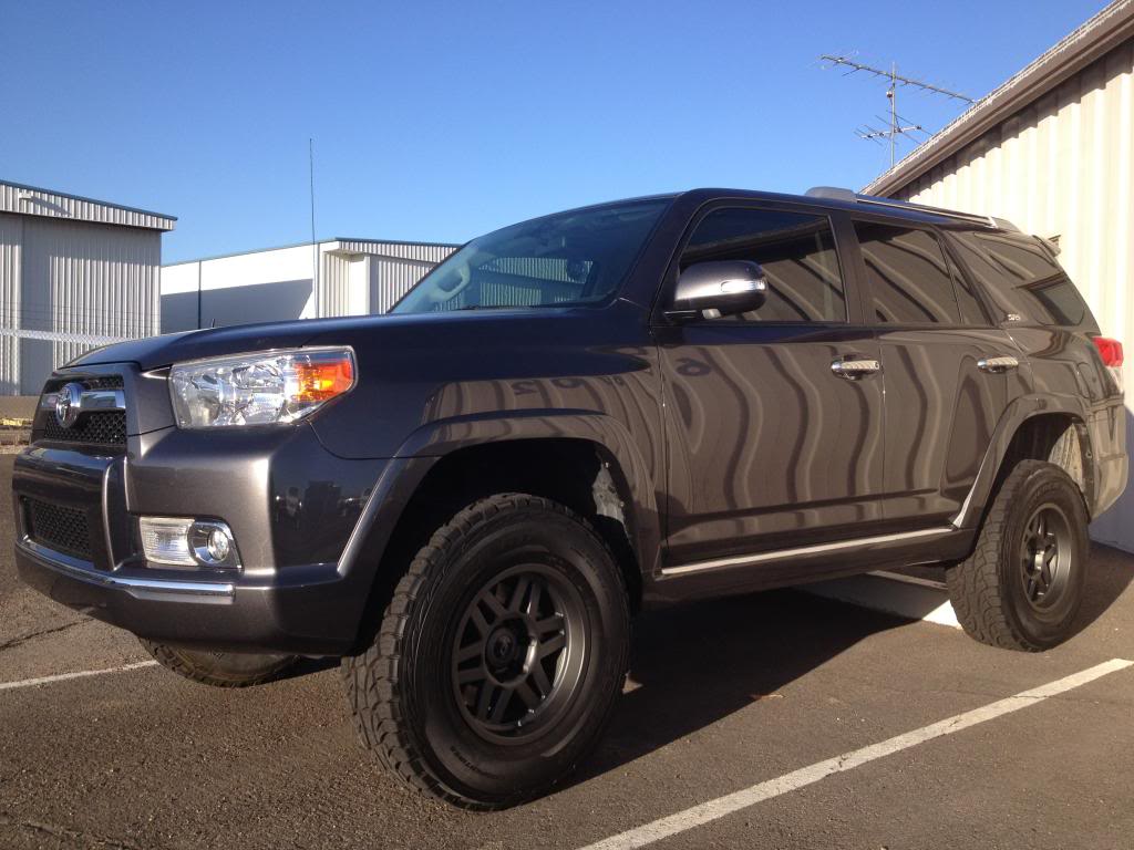

I never measured but closer to 3". Just to clarify part numbers
884 fronts
889 rears
90010 front shocks
60080 rear shocks
