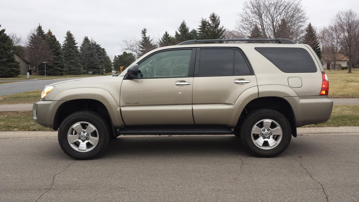

So Me being me I forgot to measure before. After with 265/65/17 on drivers side I was at 37 1/2 front and 37 1/4 rear. Was not happy with the high nose. I havent driven it much as I need to reclamp my CV boots now but it is settling DS 36 7/8 up front and just a hair over 37 in back. Thats wheel well to ground. I will remeasure center wheel to wheel well later. Using a level the stock side steps are almost bubble center, at the window well it is dead level and roof edge reads level. I think the roof slopes back a bit so it appears more reverse rake than level. I am wondering if I should have gone 895s to keep a little rake or I may just end up sticking a couple trim packers in the back, I dont need much. I am not going to do anything till it settles all the way. Stock UCAs, passenger side sway bar may be contacting the coil during some slow speed bumps, it could also be the sway link on that side though. It has play so I am replacing it.
Ride is AWESOME. No nose dive, solid in turns. Not at all jarring. I find it reassuringly solid.
