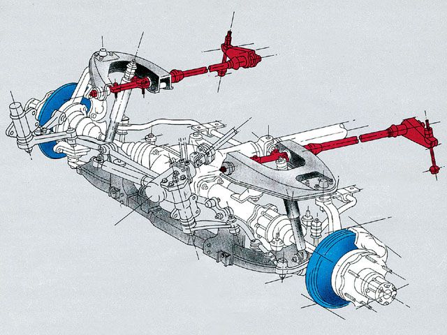

Best advice I can tell you is search and search and search. I dont have any experience with second get 4runners but the back is leaf springs. So do what you would do with a jeep, longer shackles or those flexing ones would be best for articulation. longer travel needs longer shocks. For the front a simple lift would be the torsion bars and adjust as much as possible. Total Chaos makes some good kits for the front. Baja worthy and gives you up to 10 inches of travel if you switch to coil overs. Other kits drop most of the front diff and suspension ending up with lift but about the same ground clearance under the diff. If thats not enough go with a solid axle swap.
