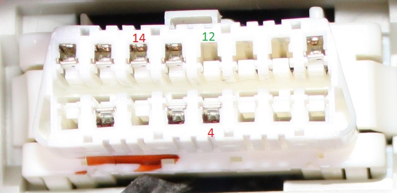

The procedure is the same - it's the pinouts that are different.
03/04 models used the ISO communication protocol and pinout 14
05 and up use the CAN communication protocol, and pinout 12.
Which pins do I need to use then? Is there a different pin placement?
I think this is what you're looking for.
Also, sent you a private message.

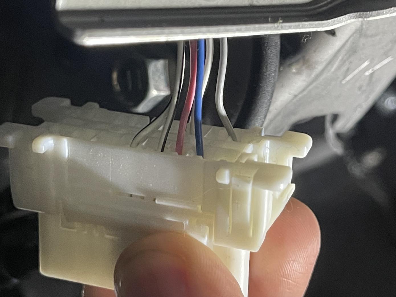

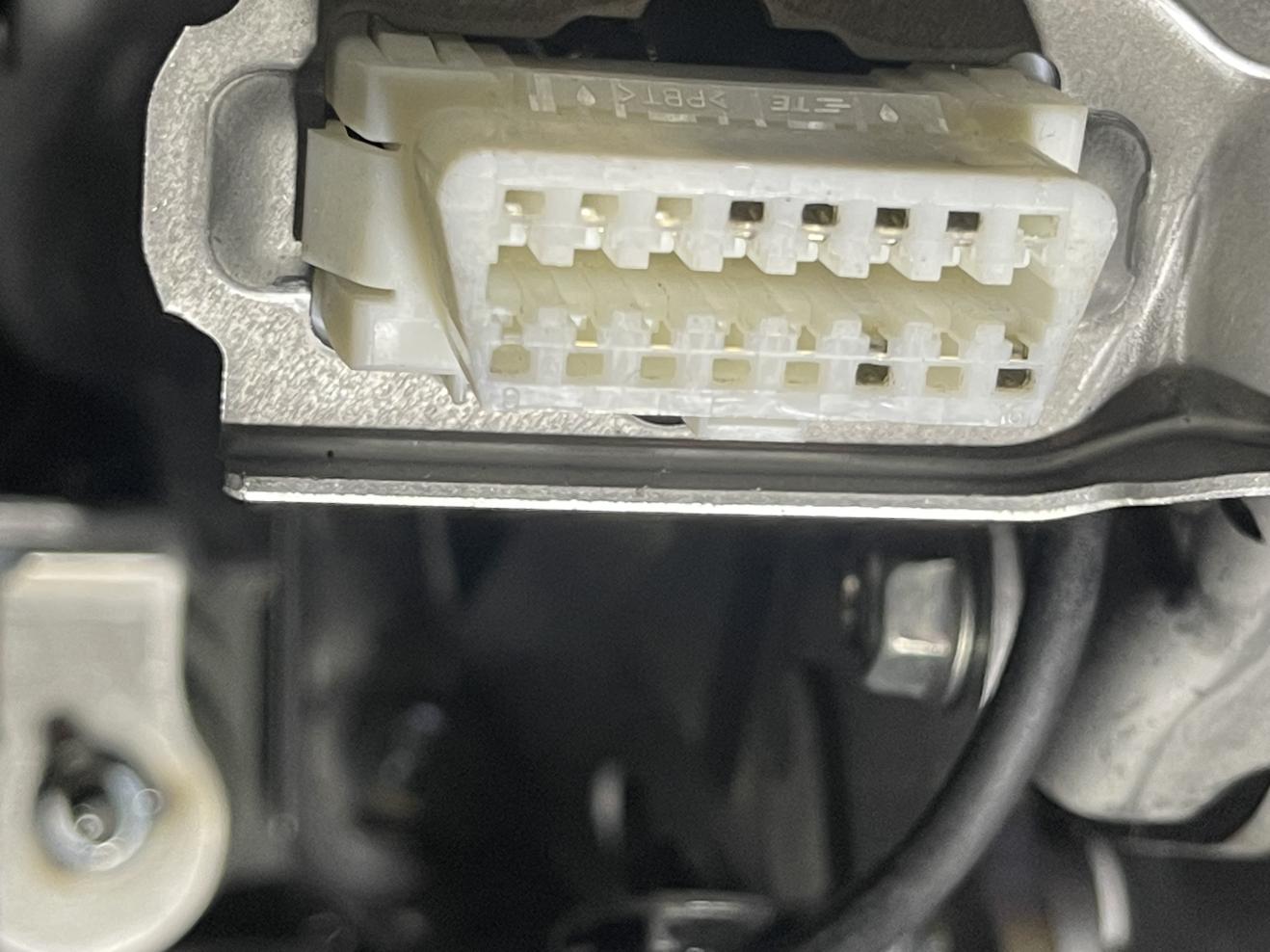

I’ve got the VSC light on. I tried to do the Zero Point Calibration, but my OBD connector pin configuration is very different than all the ones I’ve seen in various forums. Can anyone tell me how to find the TS and CG pins? Maybe tell me the colored wire behind the connector so I can match it on my vehicle. Notice I only have 6 pins/wires, while others have 9-10.
2021 4Runner SR5 Premium

does anyone have pin layout for a 2012 4runner SR5 OBD2 port? I'm afraid ....one says #4&#12 another says #4 & #14 another shows #4&#13... PLEASE HELP (zero point calibration with downhill assist)
Praying I didn't ruin my truck.F#@&.......
