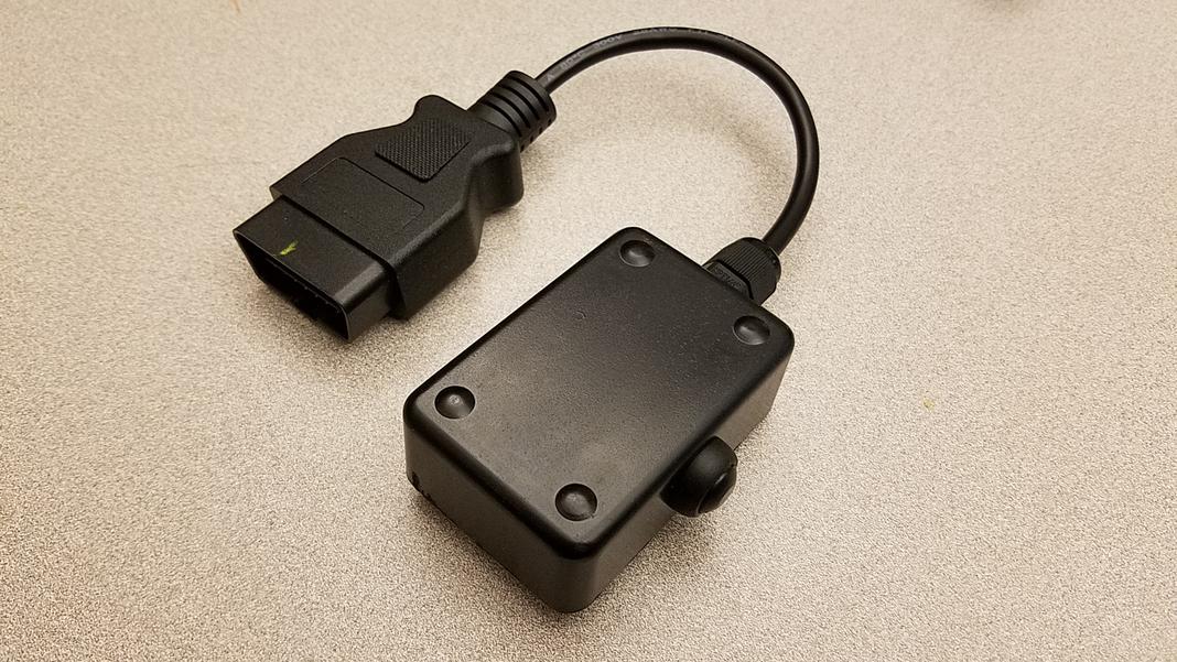

Would there be any interest in a custom-made device you could plug in to the OBD2 port and push a button instead of having to mess with paperclips and stripped wires?
I made one for myself and I suppose I could make a few more if someone was interested.

What you need is a little something I call "The Zero Hero." Plugs right in and works with a thumb button instead of messing with jumper wires and such!
Message me if you're interested in one, I keep parts around and build them to order!
