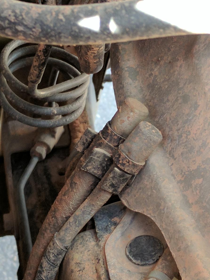

Actually noticed this earlier today on my '02 and had a similar question, but wondering what each of them were for.
There's really no reason to extend the transmission or transfercase breathes. They are on top of each other. If you get water that high. Your whole interior is going to be soaked and under water dude.
Rear axles with elocker has 2 breathers. One for the axle and one for the elocker motor. I extended both to the gas tank.
I'm going to say. One is for the housing and one for the add system or whatever you call it.
It's like the same for the elocker axles. 2 breathers
