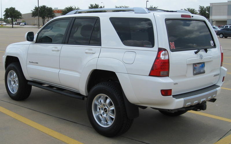

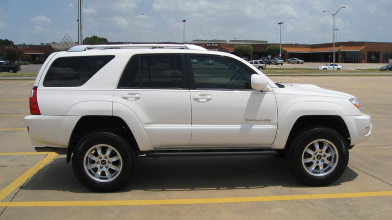

Over the last few weeks I've finally gotten it to where I want it. Of course there is a few more things I'd like to do to it.
I'm running the OME lift, TRD Wheels, Michelin LTX AT2 in LT275/65-18 and DeMello Bolt on Sliders.
what was your mileage when the xreas started leaking and how were you able to tell. on one hand I love how my 08 urban runner rides but on the other hand I can't wait to swap out the suspension for something that can really be lifted.
Looks great! How do you like the ride compared to XREAS? I'm actually about to rip mine out as well to run the Bilstein 5100/OME combo.
Also, how much lift did you get front and rear? I'm still a little worried about the 895s lifting the rear too much as i'd like to keep it around 2" rear lift.
Seems like I got 3 inches in the front and 2 inches in the back. The ride is very stiff now compared to what it was. 3 of the 4 x-reas were leaking when I bought it so it was probably softer than it should have been. I thought the ride before was comparable to a Crown Victoria as it would soak up almost any road imperfection. Now it's tight and not too dissimilar to my wife's IS350, but I prefer a sporty ride over a mushy one.
