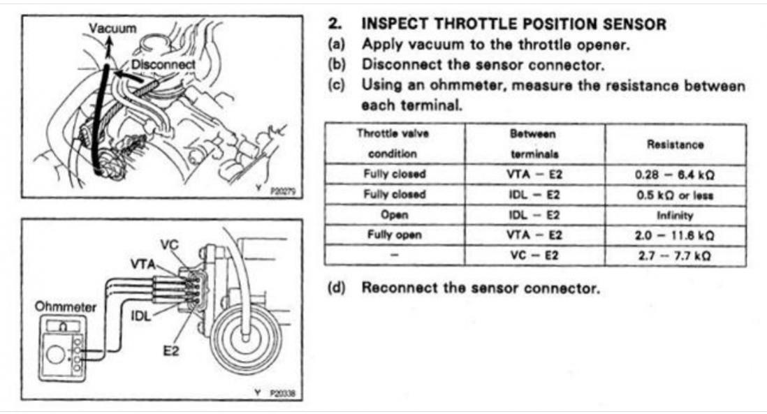

Cleaning the throttle body might take care of it also cleaning the maf but tps sensors do go bad. You can test the tps by applying vacuum to it and then checking the resistance.
