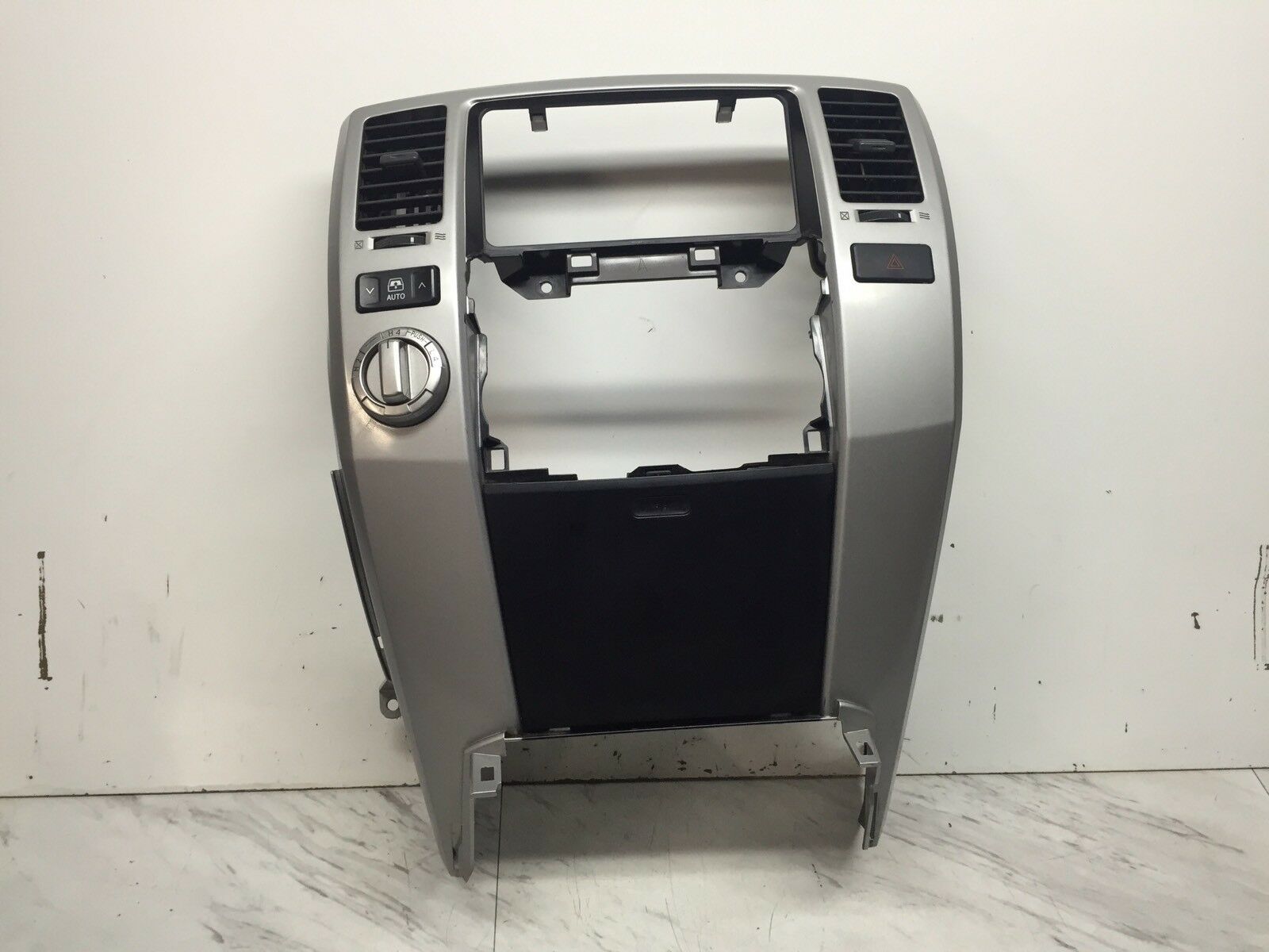

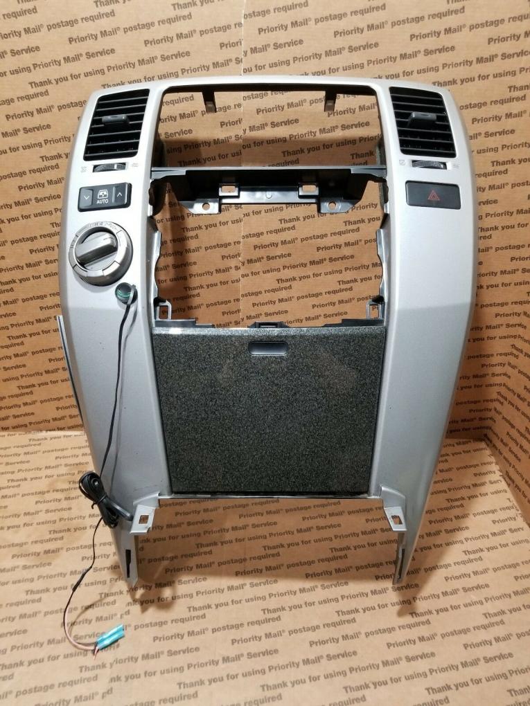

So it does look like if your 4R had nav or the basic, non-JBL system, without RDS and all that crap, the dash bezels ARE different. So I need to buy a new dash bezel to resolve the gaps that I have.
You can see the differences in the attached pics. The first one was with nav or at least non-JBL/RDS.
The second pic is what I have that had the JBL system with RDS but no nav.

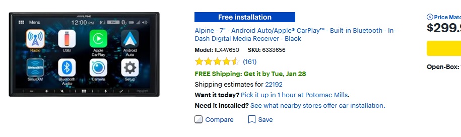

what am i missing? i can get a 7" Alpine android auto unit for $299 from best buy with free installation. whats the difference between what you are getting and what this is?

my bad, im a noob, lol. my question in general is the same across a couple of forums that people are ordering no name head units from online when you can just go to best buy and buy a name brand android unit for 2-300 bucks with free installation! i get if you like to do the work yourself but youre also getting a warranty whereas these no name brands might not stand behind their products as much. i just got my 4runner today and this is the first thing i need to do so just learning.
ATOTO support has been great so far. Little slow due to Chinese New Year but they are responsive and have a support website as well. The HU is also well liked by the FJ guys. I'm not overly concerned.
Yeah I meant a limited with Nav. I don't think there's any other way to close that gap around the unit.
Yeah, that is the only solution with this particular head unit. Not a big deal, just extra $$. Console bezels aren't cheap on ebay or elsewhere. Most I'm seeing are over $150.

The ATOTO A6 Pro is an android tablet which has been customized for use in automobiles - you can use it as an android tablet OR you can have Apple CarPlay or Android Auto. All the other name brand stereos that are limited to their own UI with the option of using Apple CarPlay or Android Auto.
