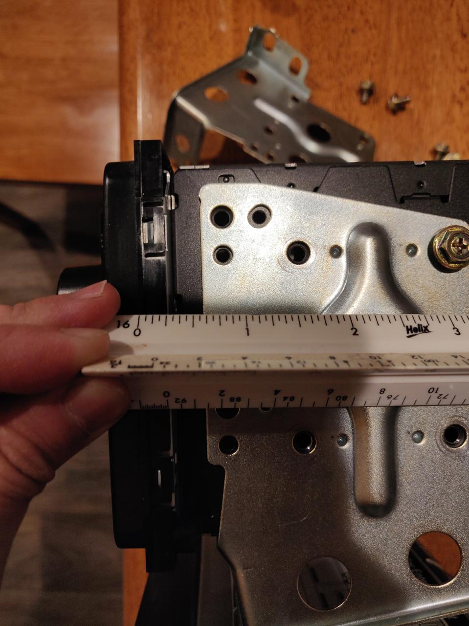

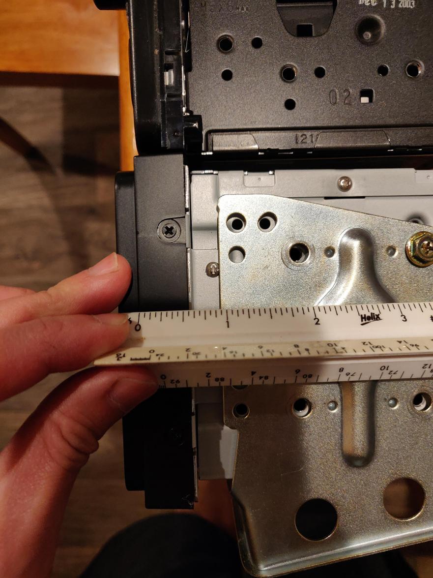

I have the non-JBL and the A6 Pro Toyota version still didn't fit perfectly because the Atoto unit sticks too far out on the stock brackets.
Interesting. I had no problems with the stock brackets from mine (JBL unit, non-nav) when I did it. All my issues were otherwise noted and resolved with factory parts off ebay.
I emailed Atoto support and they said the A6 Pro Toyota version is not compatible with the 4th gen 4Runner.
I'm really confused. I'm going to return it and go traditional name brand headunit.
