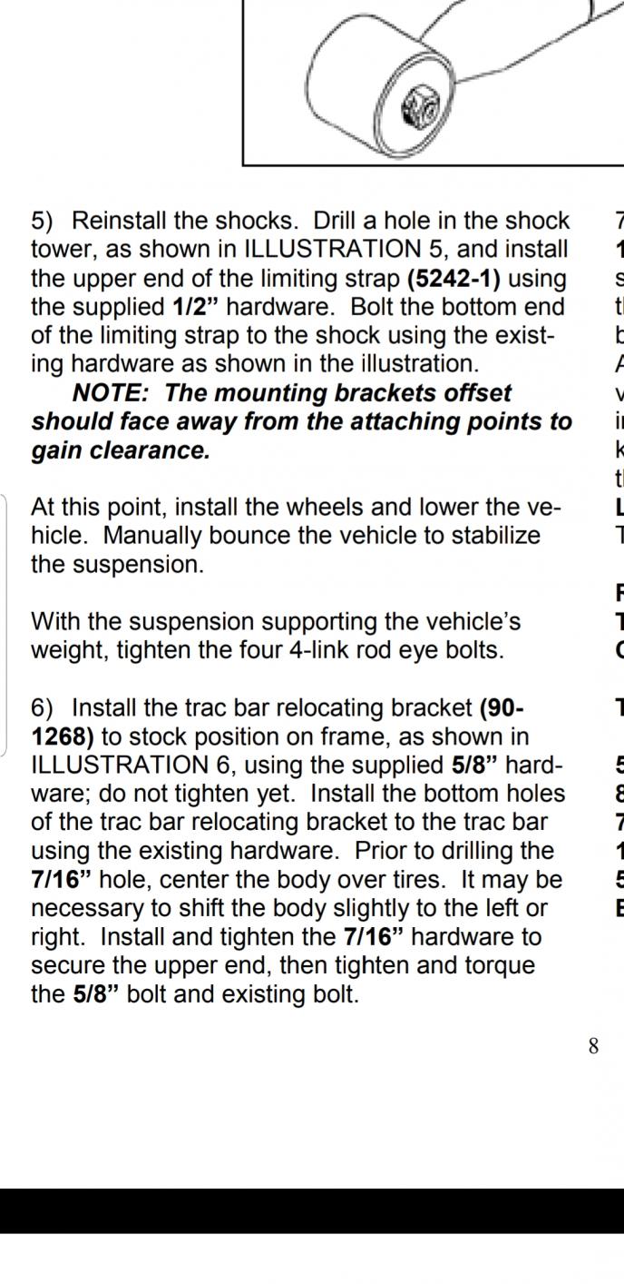

Did you install the limiting straps? In the instruction manual, it says to install the side with the offset bracket on the lower shock mount, but the straps included didn't have an offset bracket like it showed in the instructions. They are flat brackets and won't mount there because it hits the shock body. I called ProComp about it and they said they only make that one kind. That's even after I quoted from the instruction manual that says to specifically use the offset side, and it shows it in the picture. But the person I talked to swore up and down that they never made that kind.
