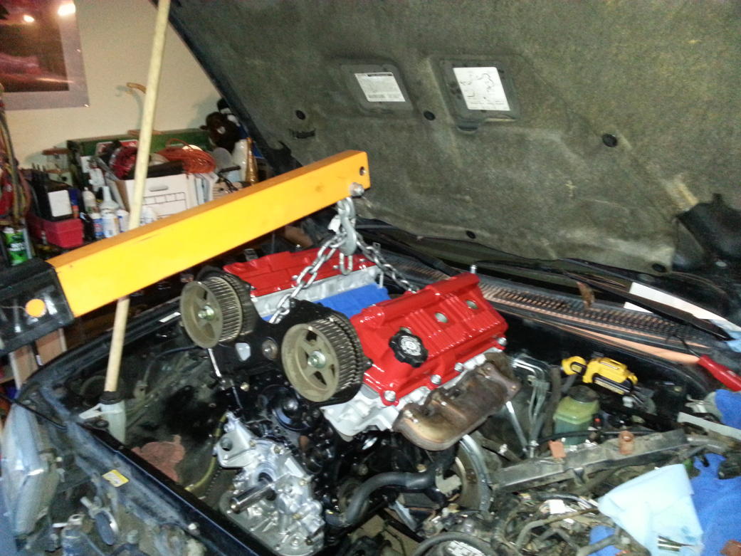

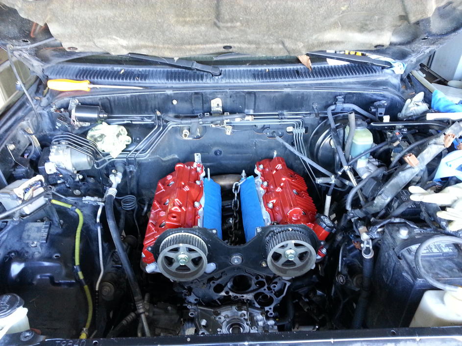

Teaser pic
Here is a few pic when i installed my engine.

Man, that looks awesome.

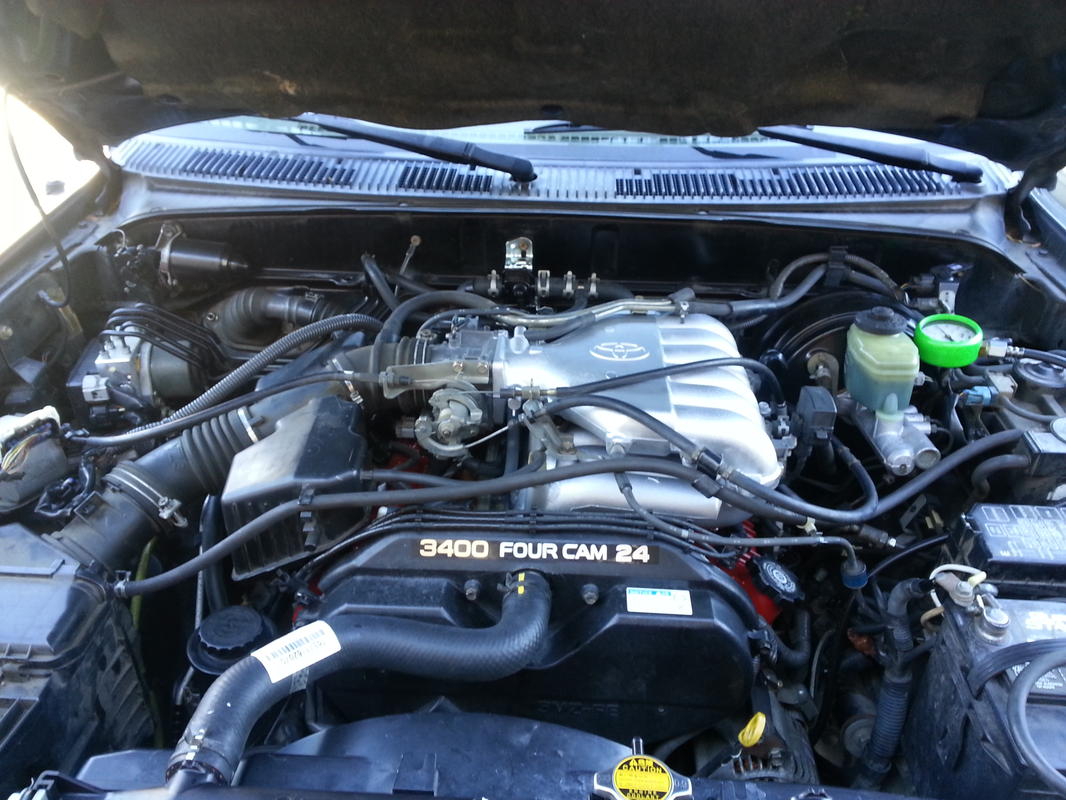

Very good point Brian,i bought a 4Runner for the wife to drive and the current engine had 245k with a blown head gasket. I was really planning on rebuilding the old engine with Toyota parts but after adding up all the machine work and parts it's almost 4k not including labor to install it.I was looking for ever for a decent used 3.4l but most of them had 150k or more and after doing the math it was a close call so i decided to buy someone else's rebuild.I replaced all the hoses involved in the engine and even got a new radiator,i broke the heater control valve while swapping out the hoses and that added to the cost.Not including the labor i was into it about $3200 when i got her back on the road.
The engine was a long block i had to re-use the VC and oil pan,i cleaned and painted the rest of it to give it a new look.
