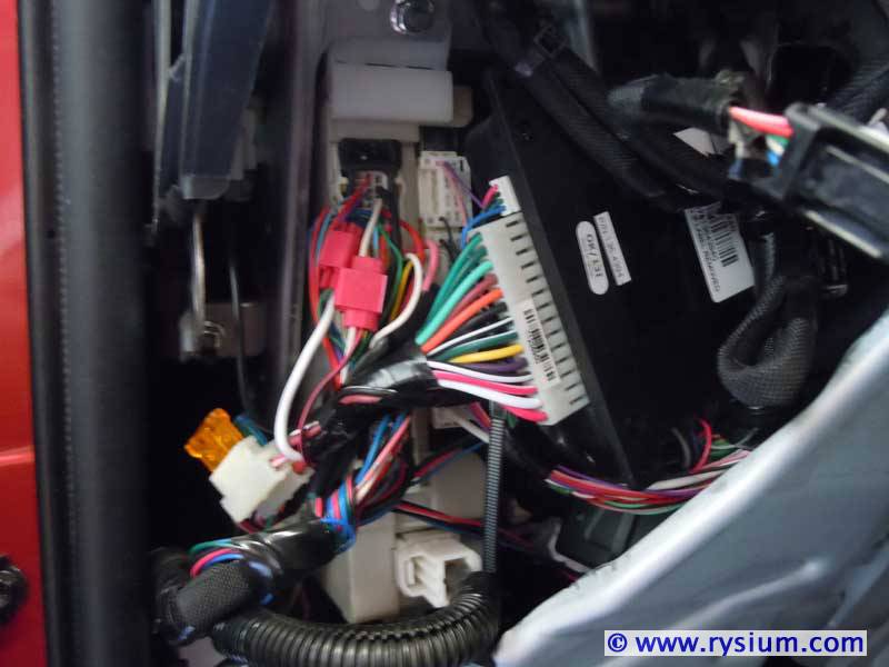

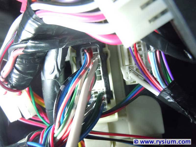

Because 2C plug is simple next to impossible to access I focused on the front plugs - 2D and 2F - these were accessible, kind off. The alarm installer put whole bunch of wires to 2F plug so I went for the lowest hanging fruit, plug 2D. This is how the front of ECU looked like when I took out panel trims:
The black box to the right with whole bunch of wires coming out is the alarm thing.
When I moved it away I could see 2D plug. This is how it looks like with pin 8 wire installed:
Pin 8 is first column from the right, third from the top. Later I installed pin 15 in the same plug (on the picture above you can see it is empty).

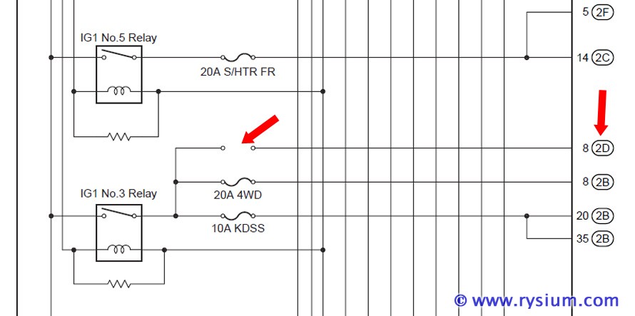

This is the schematic of the plug 2D (It is mirror image of what I see on my pictures)
An this is the location of the fuse for pin 2D 8
On electrical diagram "RELAY LOCATIONS (Driver Side J_B Assembly Inner Circuit) (2010 4Runner)" both pins are shown confirming my observations:

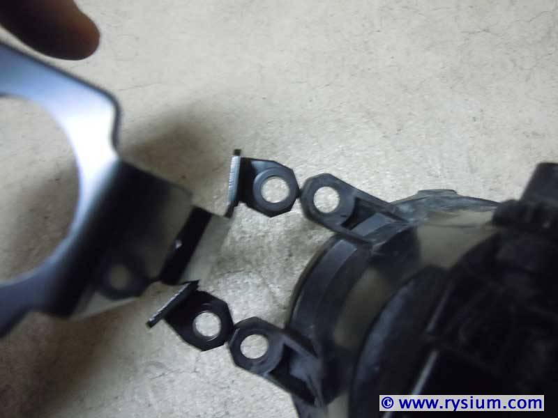

As I wrote before, the Toyota installation bracket was not exactly the same as original factory Fog lamp. Very close but not 100% plug and play. Here is the comparison between stock fog lamp and Osram LEDFOG 101

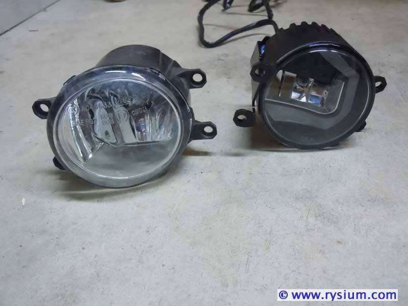

From the front:

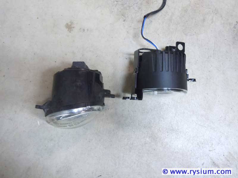

From the side:
As You can see the stock lamp is longer on one side than Osram. Toyota bracket set came with chrome (plastic) filler to compensate for that.

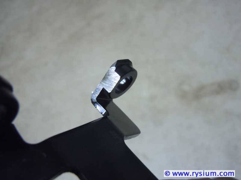

Here is the bracket problem - the inside one acting as a hook (original Fog lamp on the right, Osram bracket on the left)):
Fortunately it was easy to fix with bench grinder (the metal is very soft):

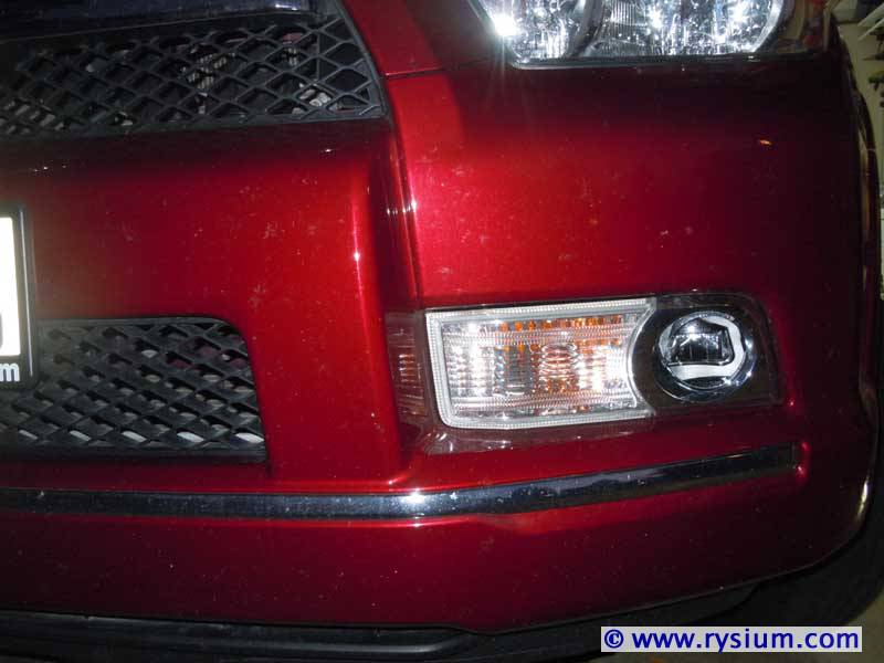

This is how the lamp looks like installed:
I would say it looks pretty decent. The last thing I had to modify was swapping wires in Fog lamp input to Osram control box. Yellow supposed to be +12V and black should be ground. The plug fits mechanically to 4Runner Fog light plug but polarity was reversed. It was very easy to swap contacts in the plug in in Osram cable (did not change original 4Runner plug).

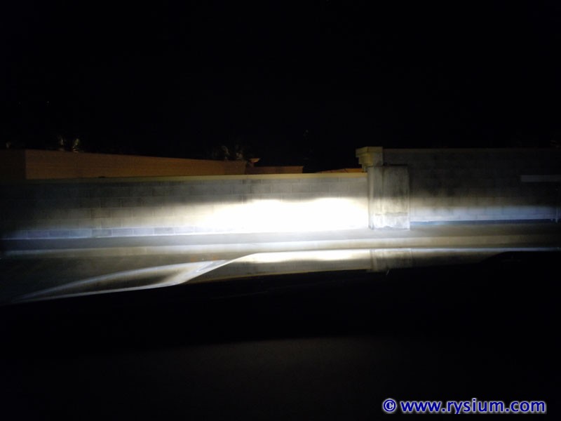

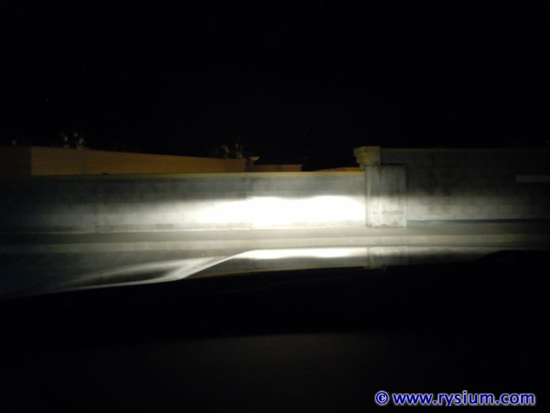

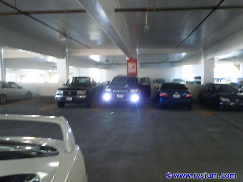

Now how good are these lamps: I would say DRL are very good - bright and blinding. It would be illegal to drive with them on at night. Fog lights is hard to tell. I wish they are not so fricken white - yellow LED would be much better solution. But it's winter time in Sacramento, so I'm sure we will have some fog to test my new lights.
Not the best pictures to show, as it is difficult to take a picture of LED lamp showing how it really looks in real life. Sensors in digital cameras see the world a little bit different than human eye.
Anyway taken yesterday comparison on the wall with Fog lights OFF
and ON
I really don't like the color of LED fog light - it is not as blue as it shows on the picture but for sure is less yellow than the halogen headlights.
Now for the DRL I like them very much. Picture taken this morning (it is a bit blurry but gives the idea) with just LED DRL ON
They are very visible almost kind of blinding which is the whole idea of DRL.

Before I shut up for good the last piece of information. I checked how OSRAM Fogs work as "turn lights" (one fog lamp turns on when the signal is turned on). Absolutely useless !!! :puke:
Osram fog light is aimed to far (doesn't light up the area near the bumper) and it has limited lighting effect to the side of the truck (there is a visible cut-off at about 30 degree to each side).
92 Merkury Sable I used to have 18 years ago with the bumper mounted halogen lamps did much better job than "Hi Tech Osram". I'm glad I did not splice flasher wires - it would create additional mess for no particular reason.

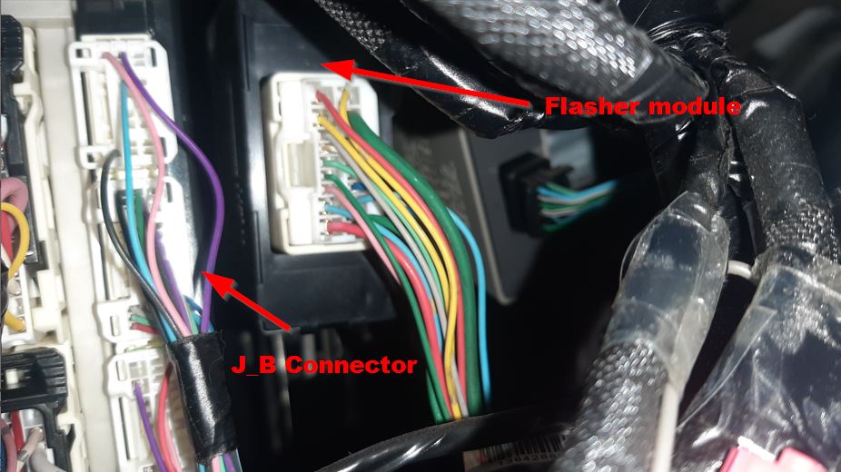

Question About Flasher Relay
I found flasher just in front of ECU. It is stand alone flasher, not embedded inside ECU. It has plug with all wires accessible. It will be easy task to disconnect DRL wire.
I also confirmed that Fog Light relay is inside ECU, so either I can plug my FOG connector to one of the connectors near the lamp or go inside the cabin for ECU contact. I am not sure yet.
Now I noticed I have a knee airbag. I guess I will have to disconnect the power from the battery before taking out the lower dash trim, correct?

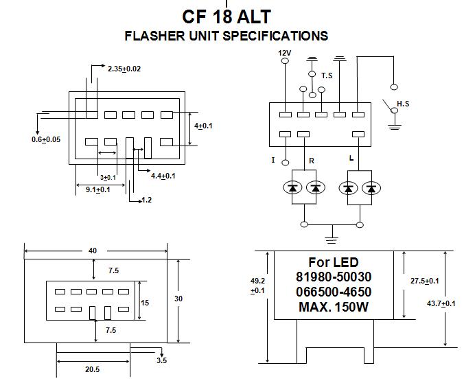

Does anyone know if this flasher unit can be replaced by the VLED CF18 unit? URL: CF18 ADJUSTABLE FLASHER 8 PIN - Flashers - Shop Products
I have a 2012 Limited and want to use LED bulbs and many have stated this flasher is embedded in this ECU, but apparently not. Seems the have the same part number as what the VLED unit replaces. Just wanting to confirm.

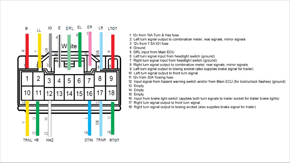

No, it is not compatible. 2012 4R flasher is 18 pins connector with 15 pins used. The connections are:
1 12v from 15A Turn & Haz fuse
2 Left turn signal output to combination meter, rear signals, mirror signals
3 12v from 7.5A IG1 fuse
4 Ground
5 DRL input from Main ECU
6 Left turn signal input from headlight switch (ground)
7 Right turn signal input from headlight switch (ground)
8 Right turn signal output to combination meter, rear signals, mirror signals
9 Left turn signal output to towing socket (also supplies brake signal for trailer)
10 Left turn signal output to front turn signal
11 12v from 30A Towing fuse
12 Input signal from hazard warning switch and/or from Main ECU (for lock/unlock flashes) (ground)
13 Empty
14 Empty
15 Empty
16 Input from brake light switch (applies both turn signals to trailer socket for trailer brake lights)
17 Right turn signal output to front turn signal
18 Right turn signal output to towing socket (also supplies brake signal for trailer)
The flasher you linked to is for earlier models (not 5th gen) with less functionality (DRL, trailer etc.) hard to find more info about CF18 but my guess this flasher (8pins) is for this diagram:
Alright thanks, looks like resistors is the only option for LEDs. These trucks are a lot more ECU controlled than I thought.

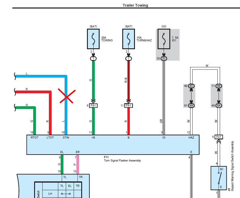

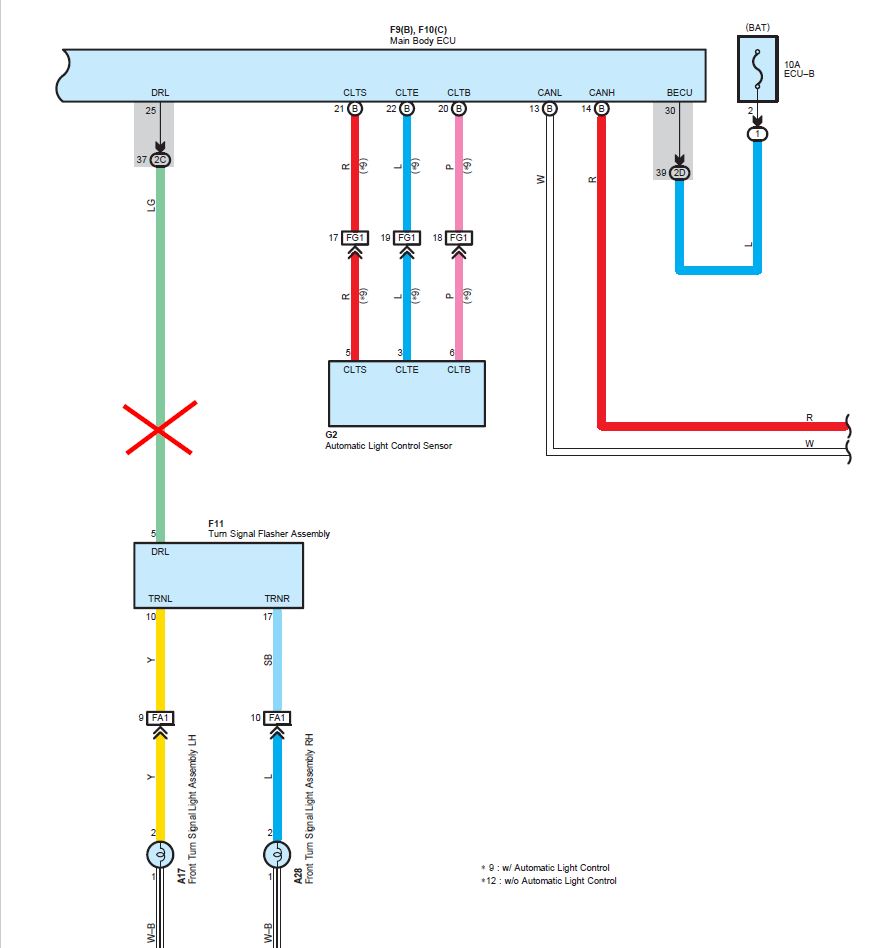

After some reading I finally decided to "cut the wire". I located turn signal flasher under the instrument panel to the right of J_B Connector
The plug wiring is as follow - look at the connector from the front side (not from the wires side)
The logic in the flasher is that when contact 5 is pulled to the ground then DRL is activated meaning front turn signal will be steady on. That signal is controlled by Main Body ECU which has it's own convoluted logic when DRL is on (based on the switch light position, parking brake, gear selection and who knows what else). To disable DRL it is enough just to cut the "light green" wire going to pin 5
I don't like cutting wires, so I de-pined the plug from position 5 and wrapped the pin in a heat shrink.
While I was already inside I decided to fix the trailer blinkers. 4Runner has US standard where trailer turn signals are red and act as a brake lights too (like old US cars). That is not going to fly in Poland - trailer has its own stop light (red) and turn signals (orange).
Trailer's "Stop in Blinkers" functionality is activated when pin 16 receives 12V. If pin 16 is open, trailer turn signals work like they should in Europe. To disable the "Stop in Blinkers" functionality in trailer's turn signal it is enough just to cut the blue wire going to pin 16.
So I de-pinned position 16 in the flasher's connector and put a heat shrink tube over that pin.
All tested fine, no more "weird" front turn signal behavior. By the way these Osram LEDFOG101 still work flawlessly.:clap2:
