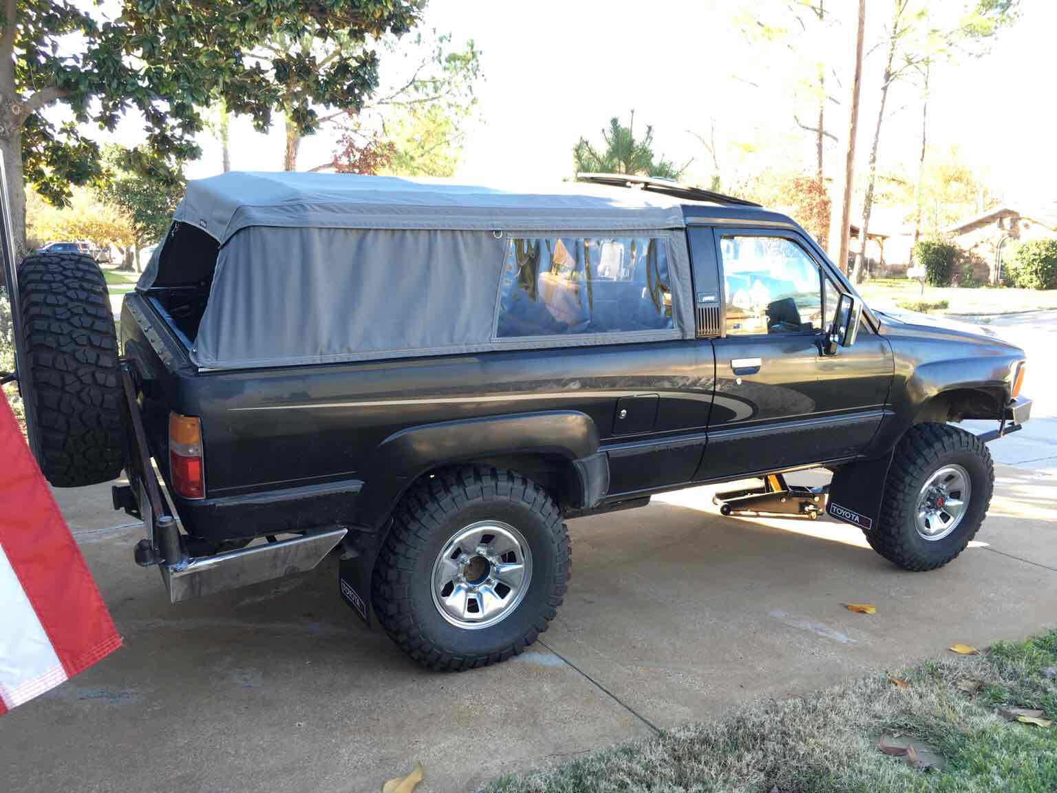

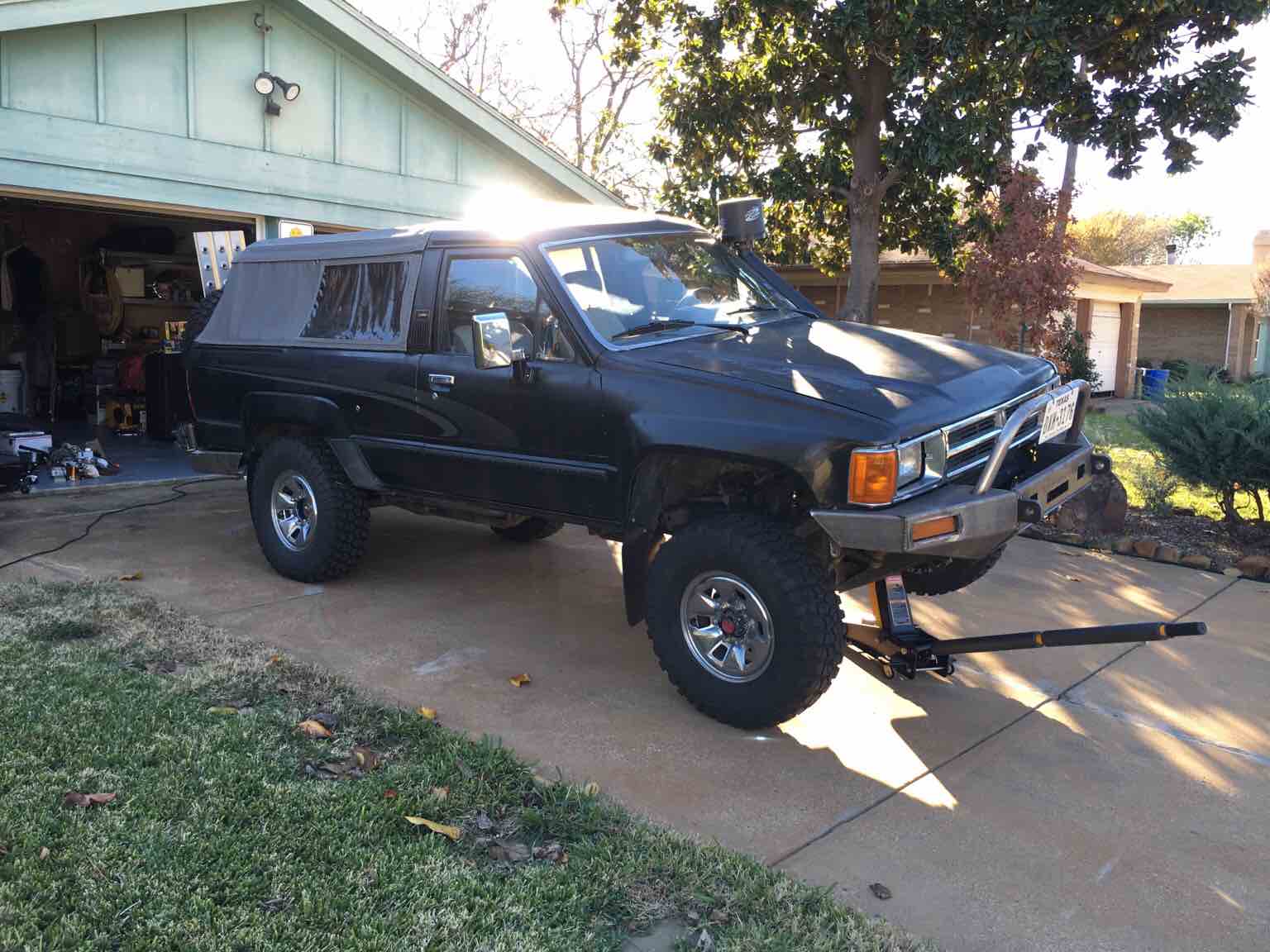

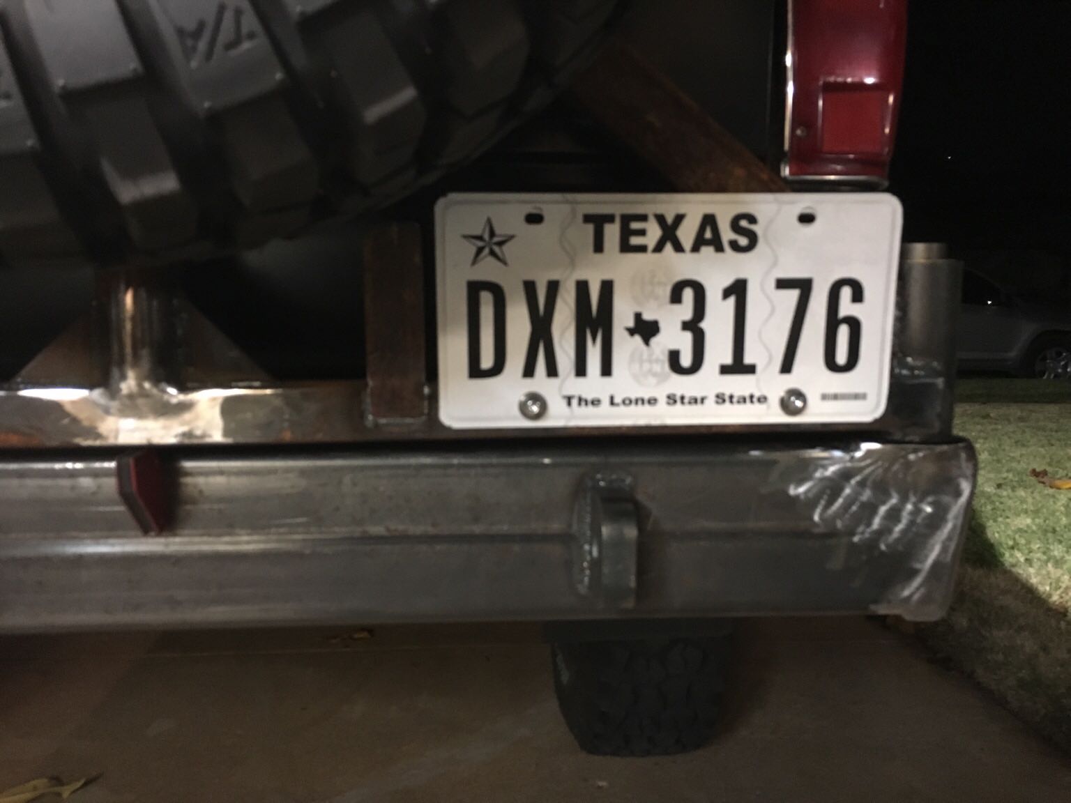

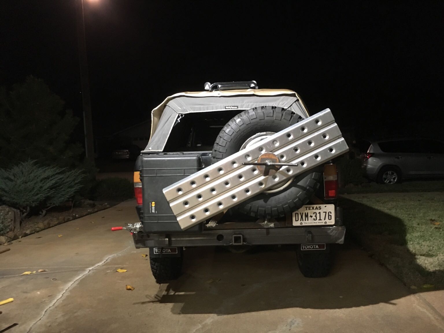

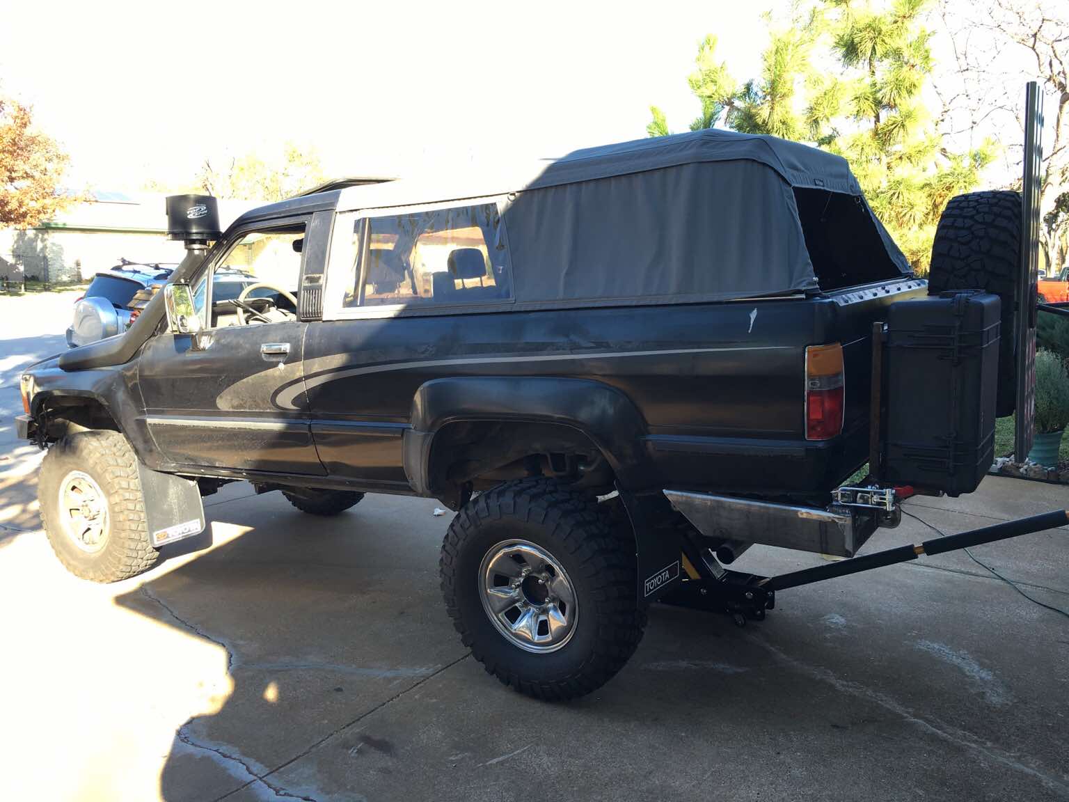

Done! There are some touches that need done, but the main construction is over!! ImageUploadedByTapatalk1449184435.349251.jpg

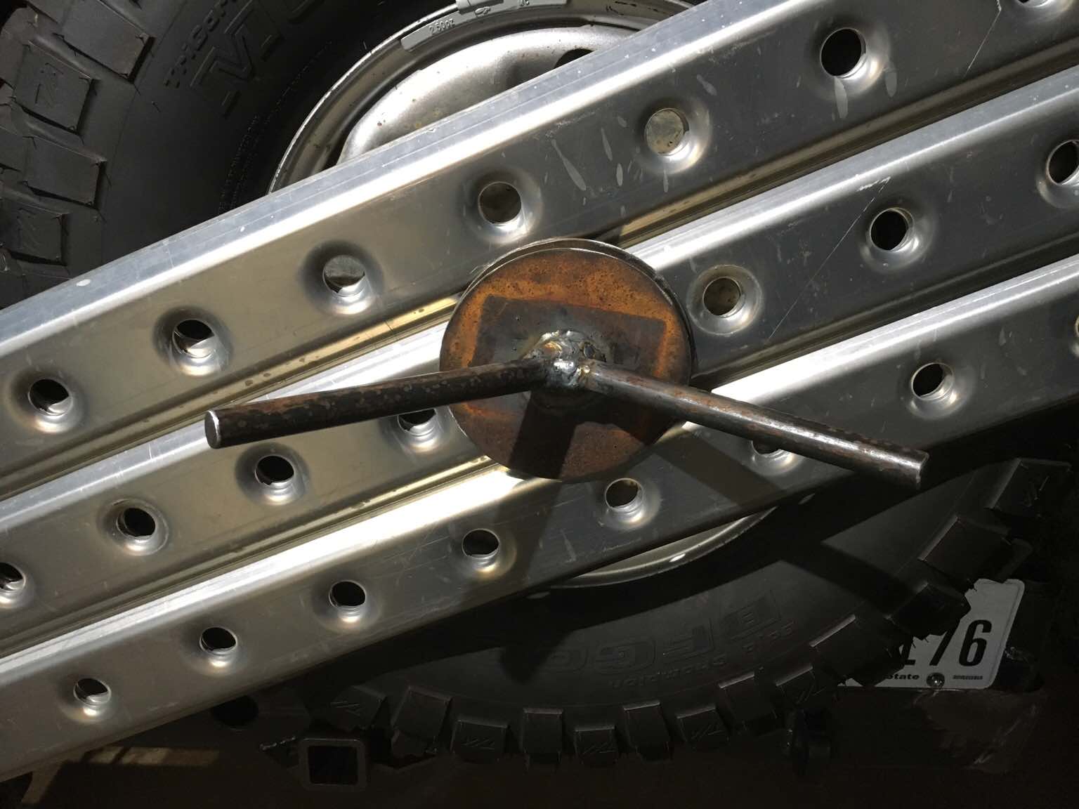

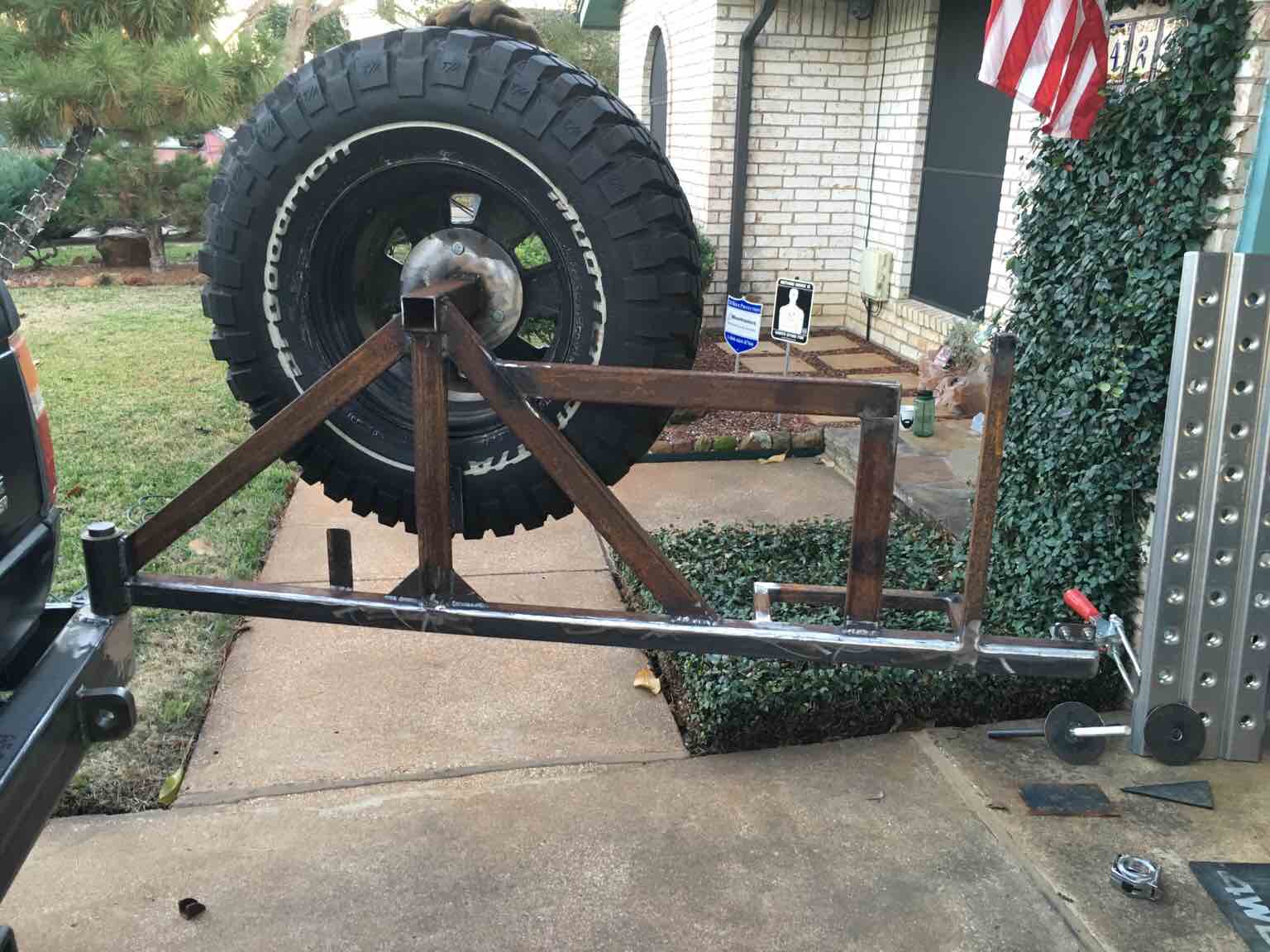

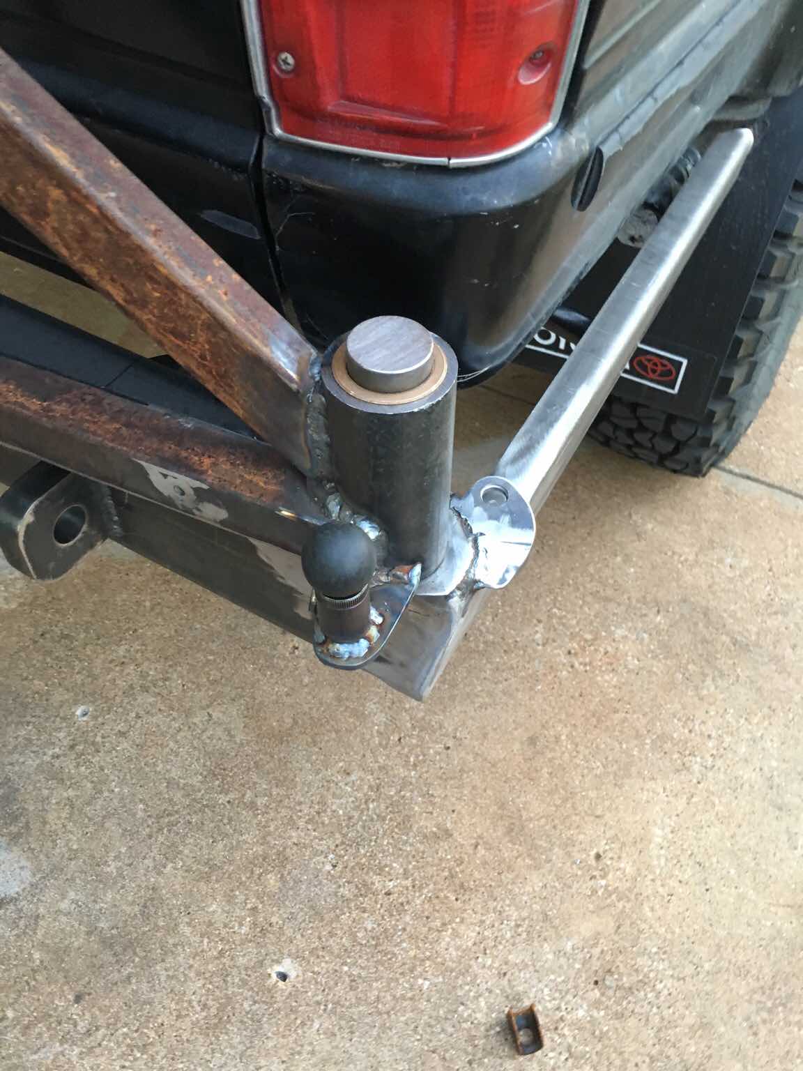

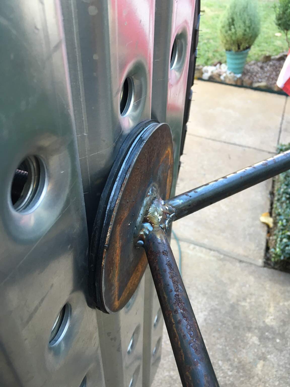

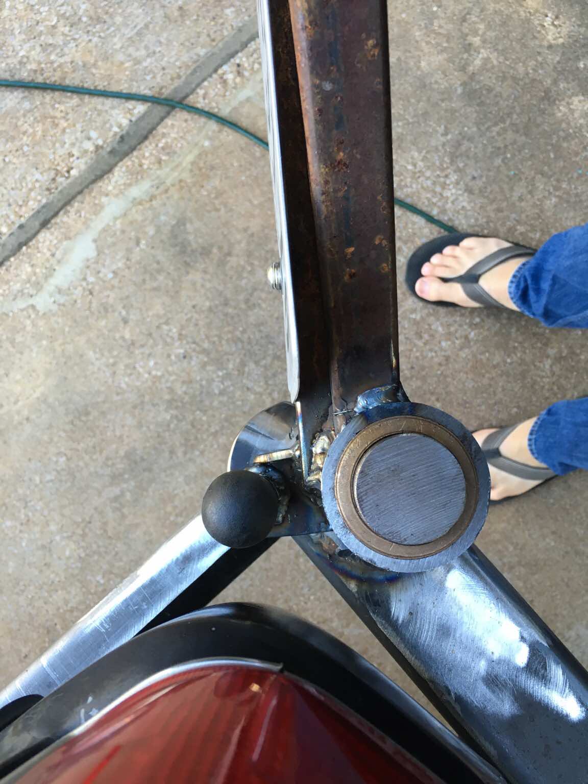

Well as I drive it has a SLIGHT wobble on bumps, but on the bumpy roads of Honduras that will be worse. To alleviate that should I do a side tube brace off the side plate of the bumper with a second spindle? ImageUploadedByTapatalk1449267539.228526.jpg

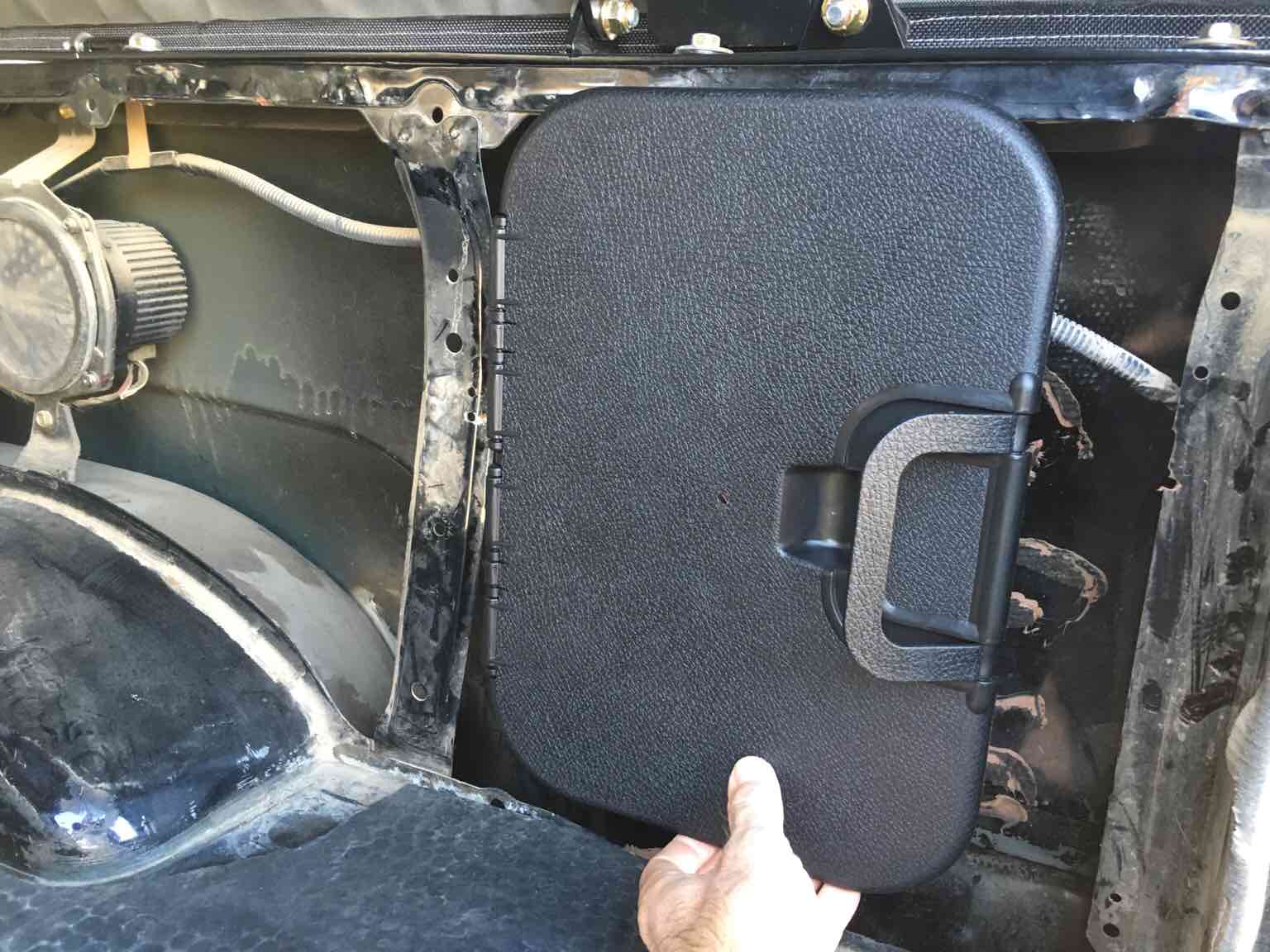

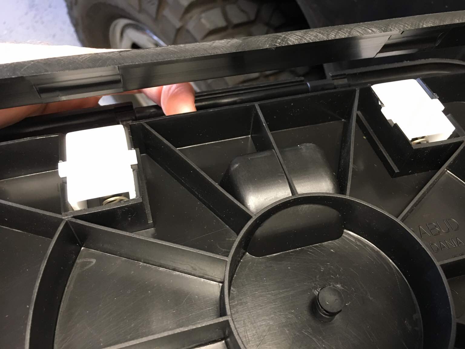

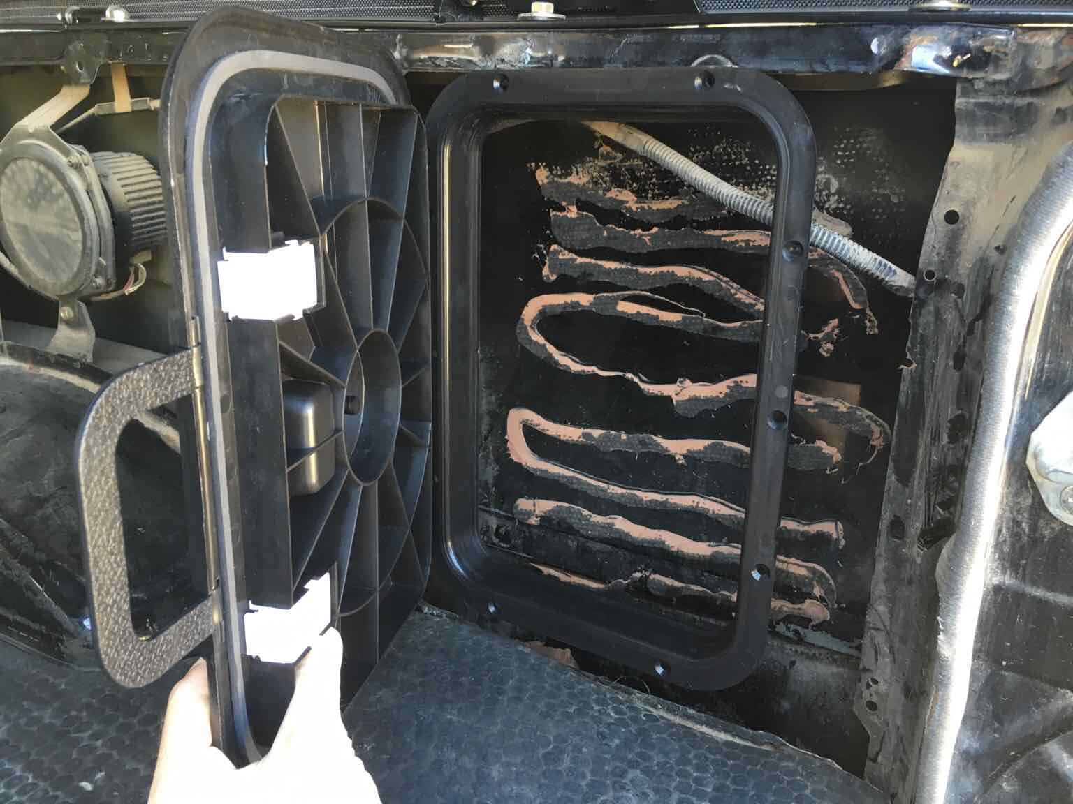

Using the same key is a great idea, but I'm not sure how one goes about that. Guess order matching locks at Toyota? I'm thinking just matching tool box locks from HD to keep things simple. My key chain is already loaded down so one more key won't make a deference. Lol.
Maybe use the stock fuel door lock from an '80's toyota? You'll have to order it from Toyota with the proper key number from your truck, but that shouldn't be too hard for them to do.
I know O'Reilly's has door lock cylinders, but would think the fuel filler cylinder would work better as they are shorter than the doors. Pretty sure its the same hole you'll have to dremel into the doors to fit the cylinder in there. Might need to check the thickness of the door material though, if its thicker than the fuel door, the clip may not go back on.
Unfortunately the door is to thick. You'd need a threaded shaft type lock. ImageUploadedByTapatalk1449427176.482824.jpg

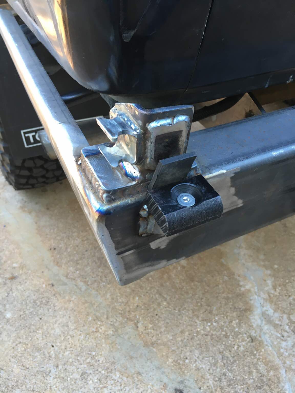

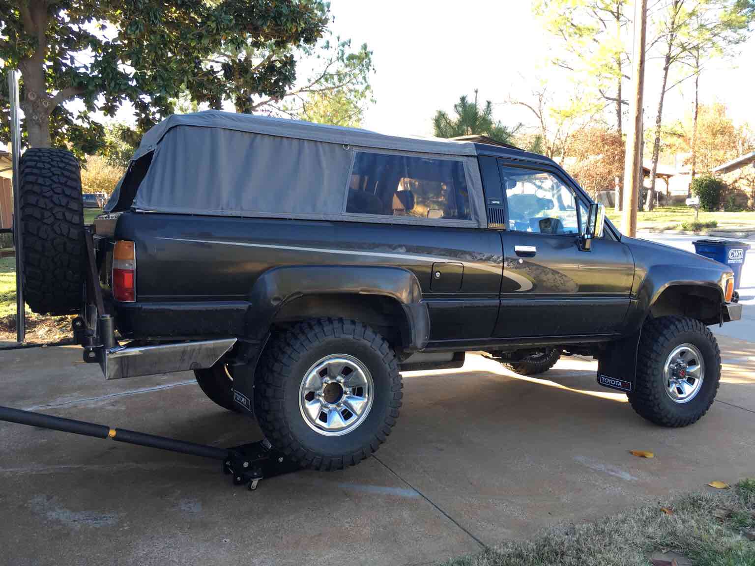

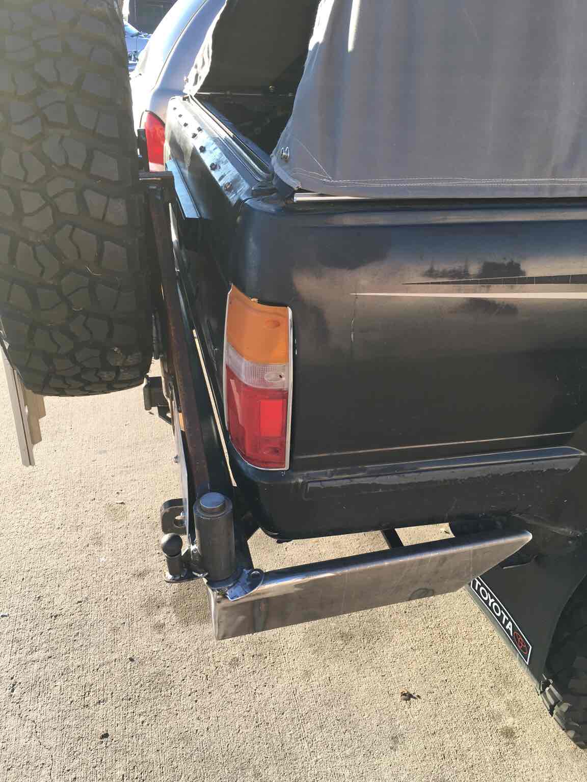

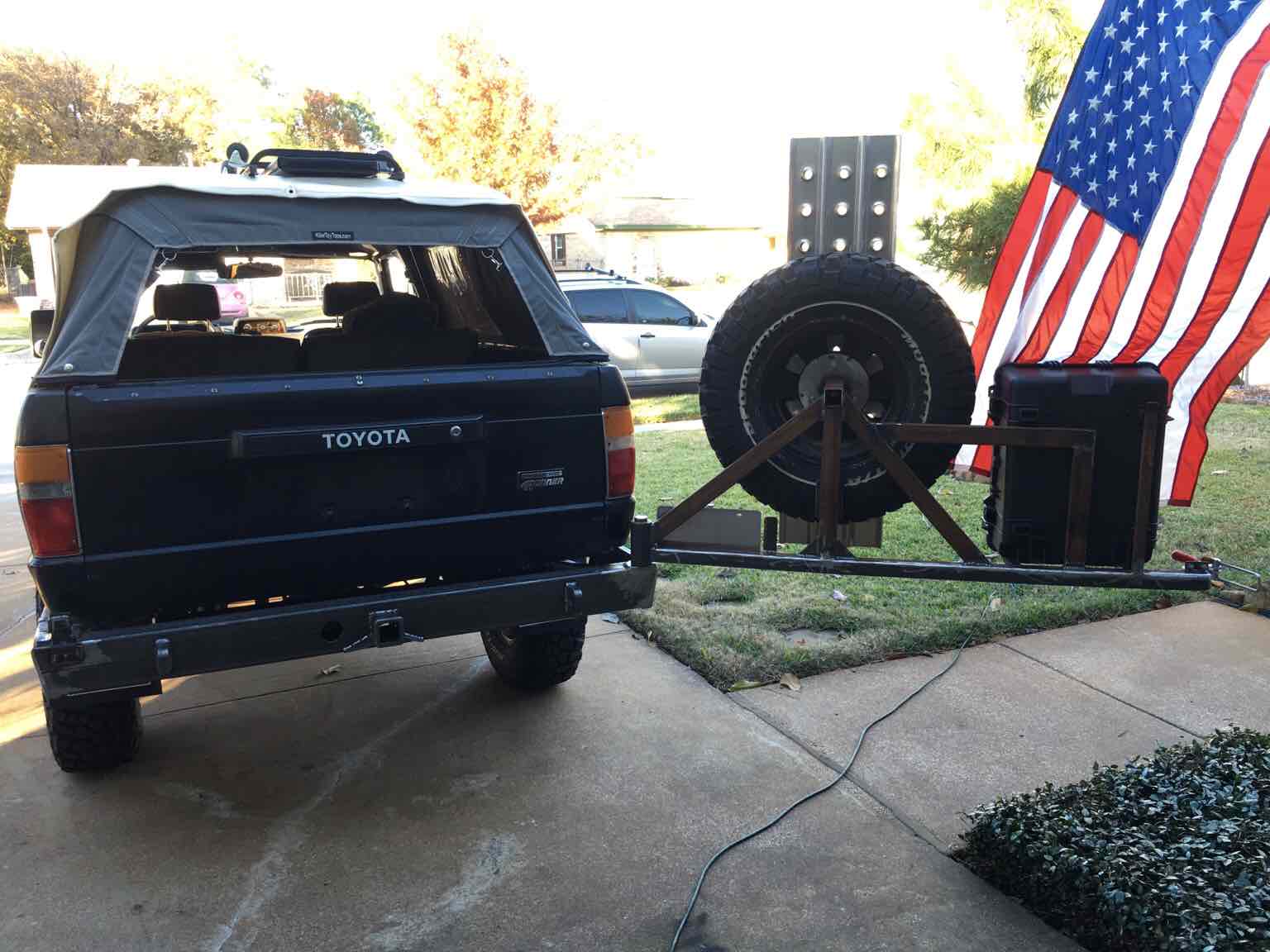

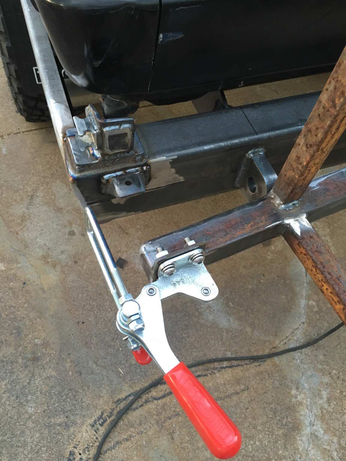

Did some flex testing to see if the rear bumper swing out moved and seemingly nothing, which I'm happy to see! [emoji16]ImageUploadedByTapatalk1449436949.211139.jpg

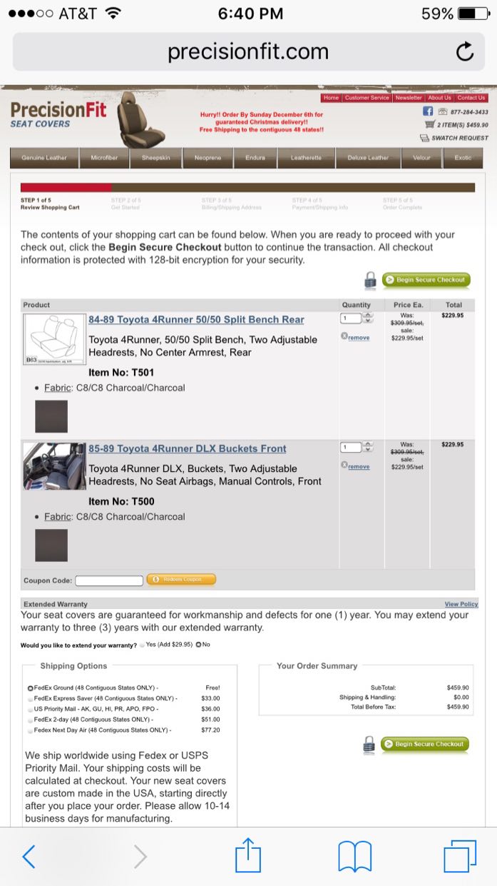

Anyone have experience with this company for seat covers or have another suggestion? ImageUploadedByTapatalk1449448872.018609.jpg
Wet Okole! Loved mine, they are in a buddy's truck and still going strong after 15 years or something like that! About the same price too as the ones you're looking at, probably similar in quality if they're charging that much.
The Wet Okole's fit really well, are made of wetsuit material and are great if you are planning to get them wet or dirty a lot. Pull 'em out and throw 'em in the washing machine once a year, and they'll look brand new (and smell good too!) every time they're washed!
