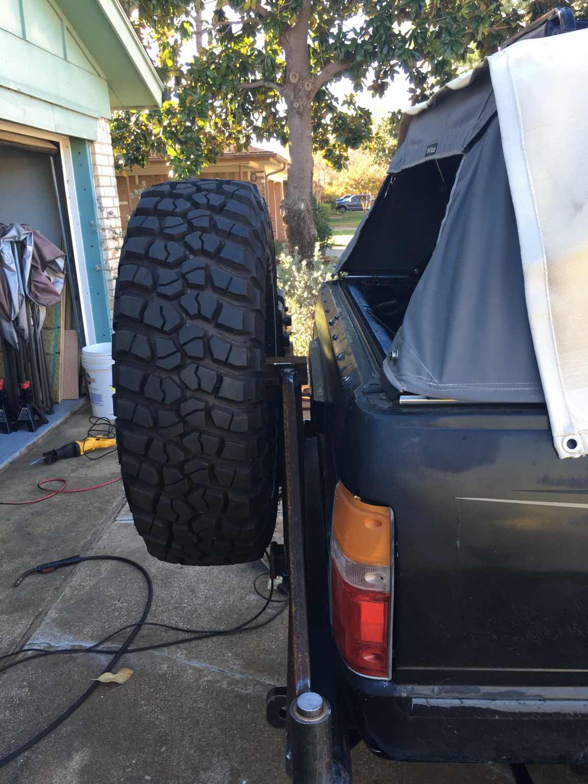

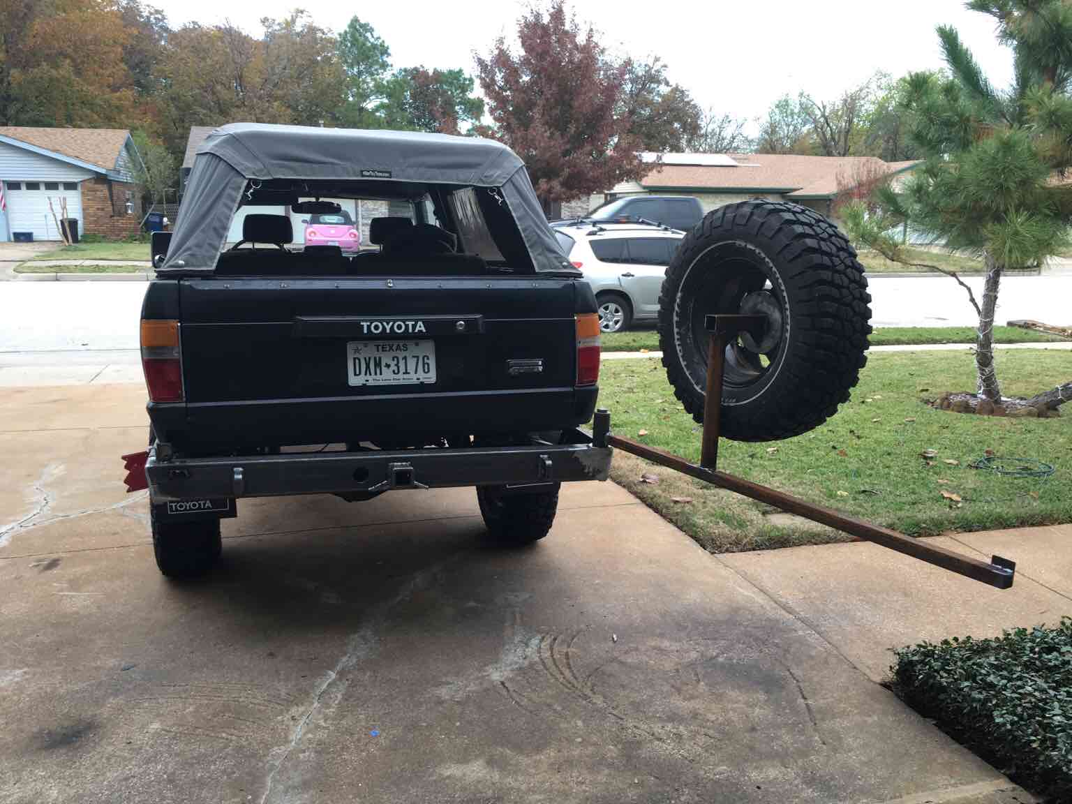

Started doing some planning for the tire swing out today till it started to sprinkle at least. Working on the best way to set up the spindle and think I've got the idea. We'll see. :D

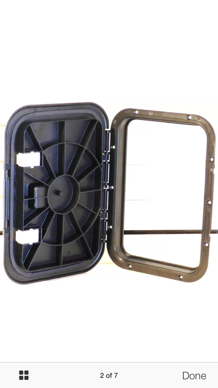

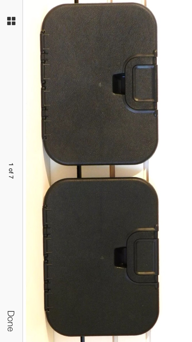

Ordered these doors to build storage compartments for the back of the 4R. ImageUploadedByTapatalk1448913438.513359.jpg
Nice! So using the spaces in quarter panels? I like that. KidV and I are thinking that, too. I happen to have polycarbonate sheets so I might just make custom ones, but painted black so contents are not visible.
Yes I'm going to use the spaces in back and cover the side panels all around with black poly. Then put what I'm making into that.
Boat Access Hatch 10" x 14" set of 2 Inspection Deck Plate No Scuff Black Nice!
The best deal I could find online in black pvc. Going to make aluminum boxes to bolt to them and then bolt to the side panels. I'll post up as I go of course. Also I'm going to add locks, but my rig will be in HND so security is a bit more needed.

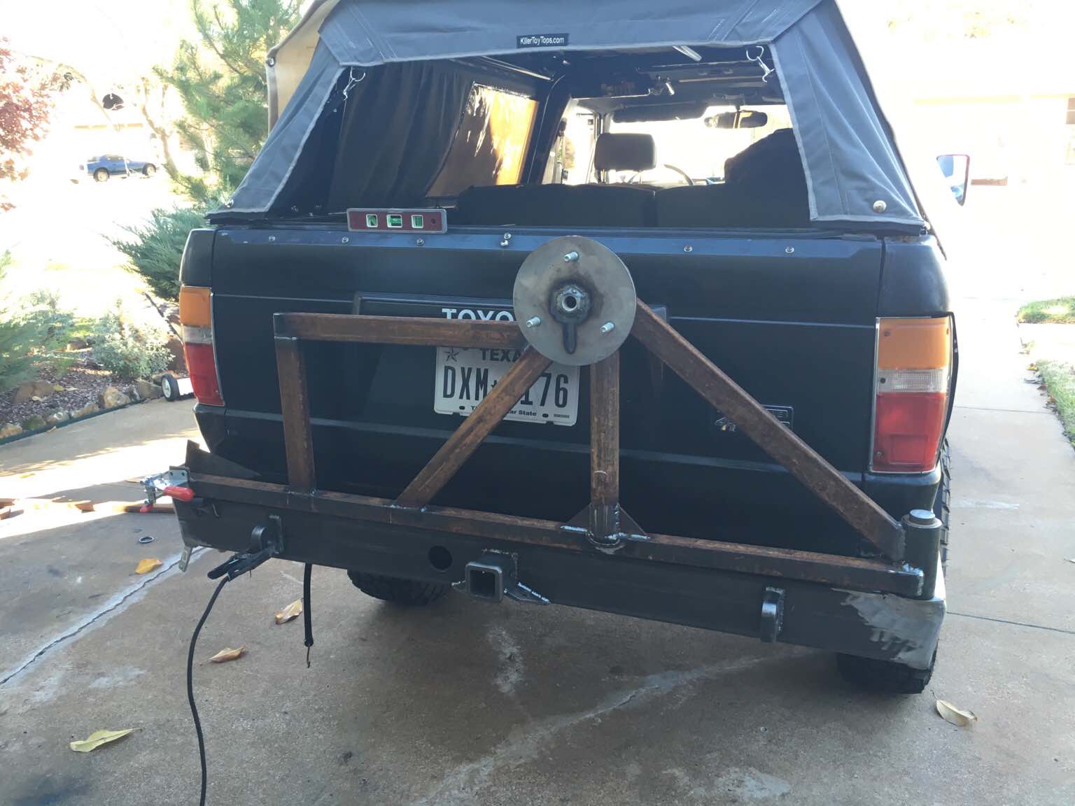

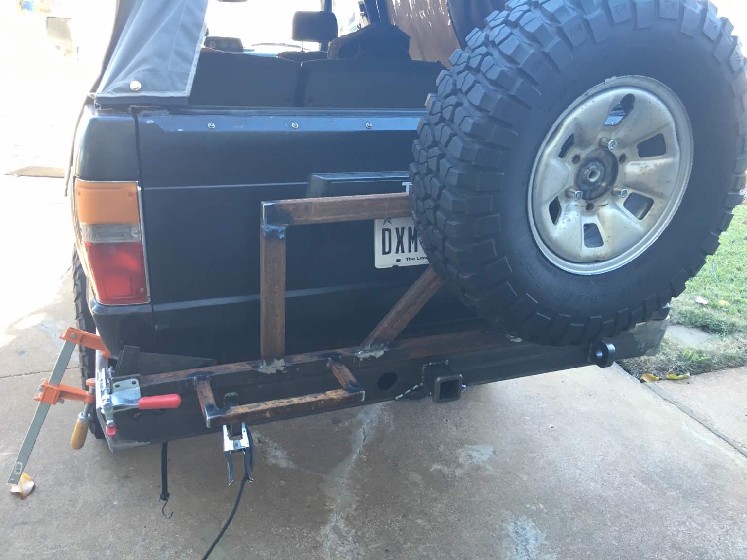

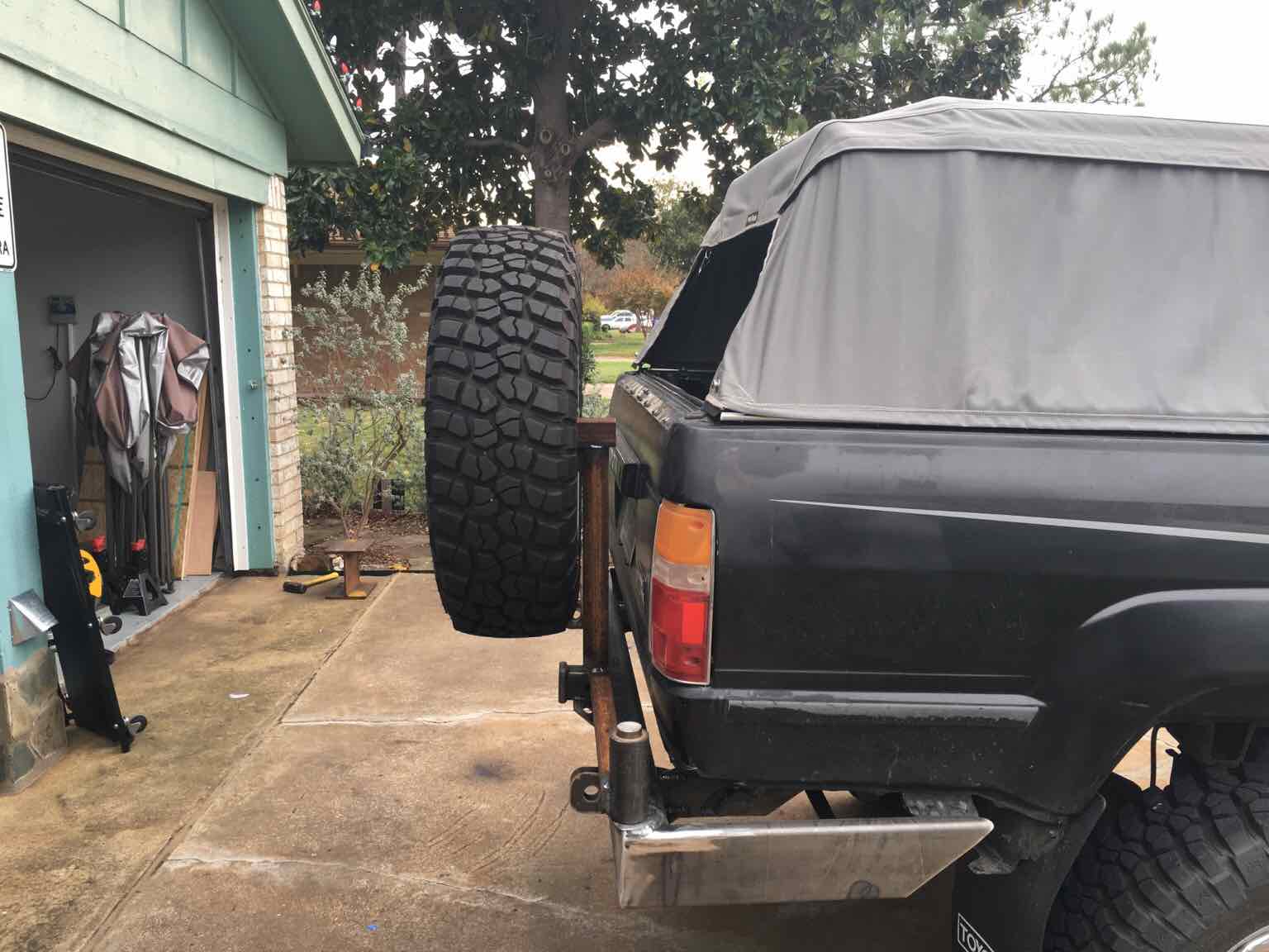

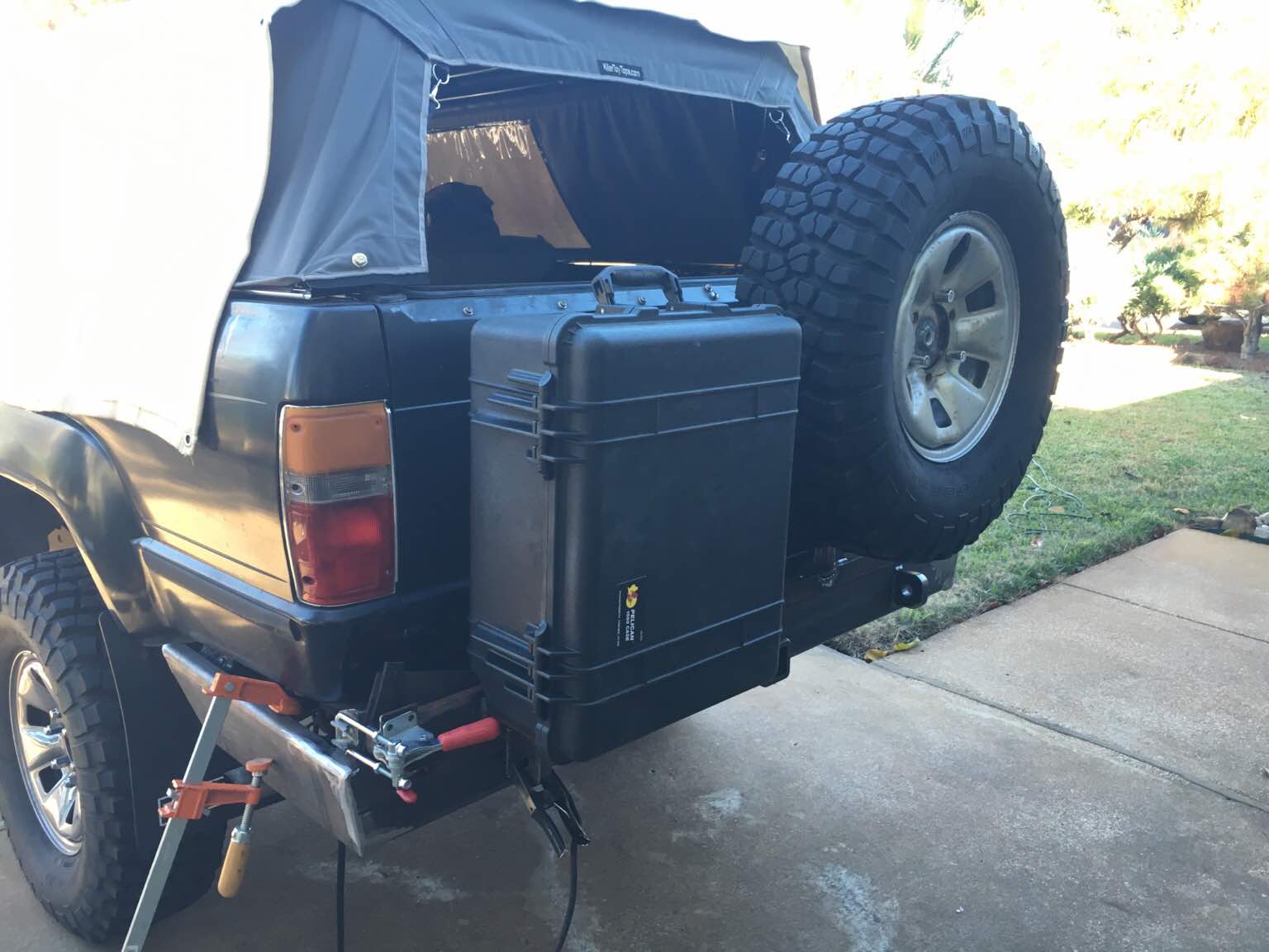

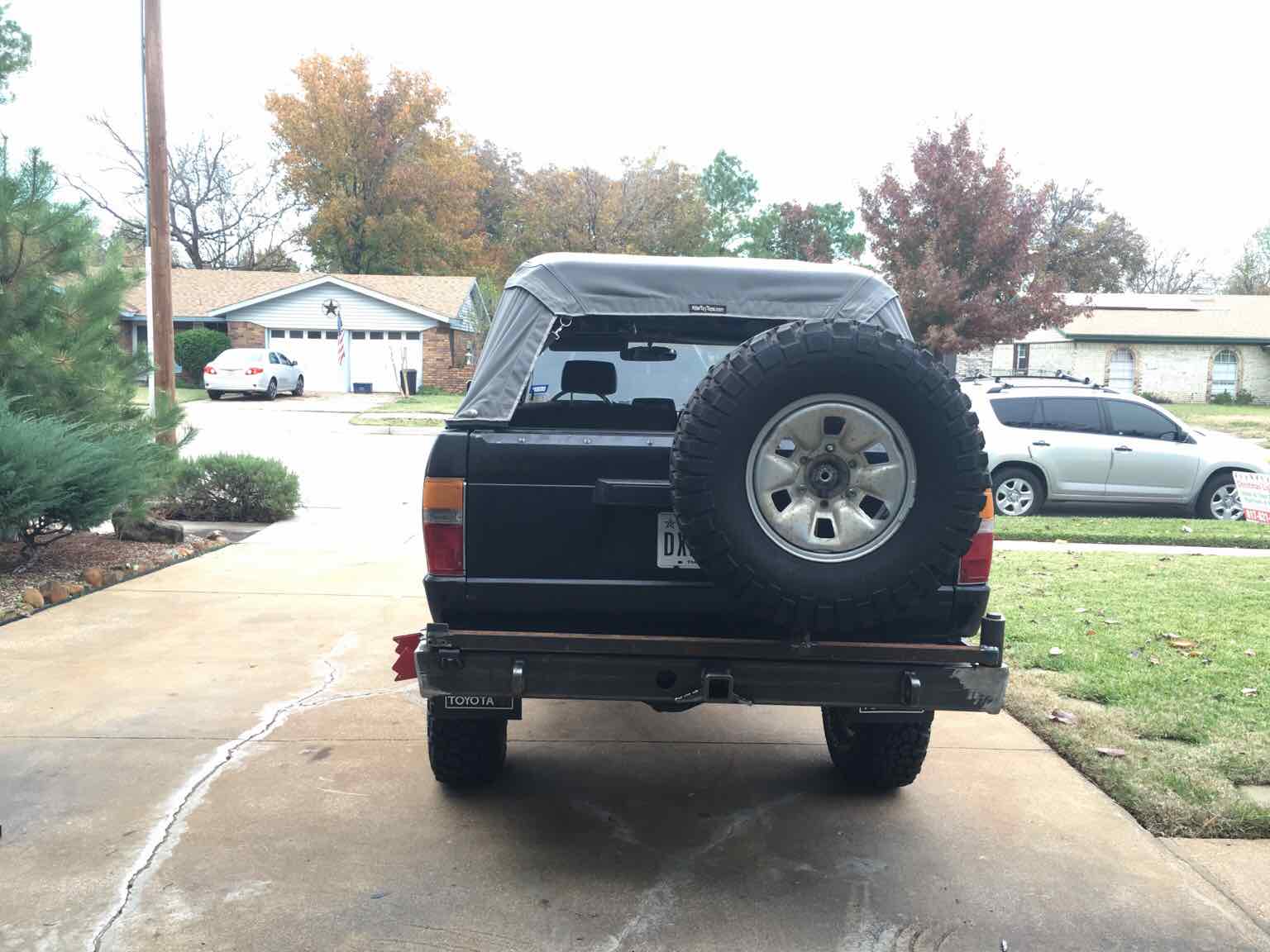

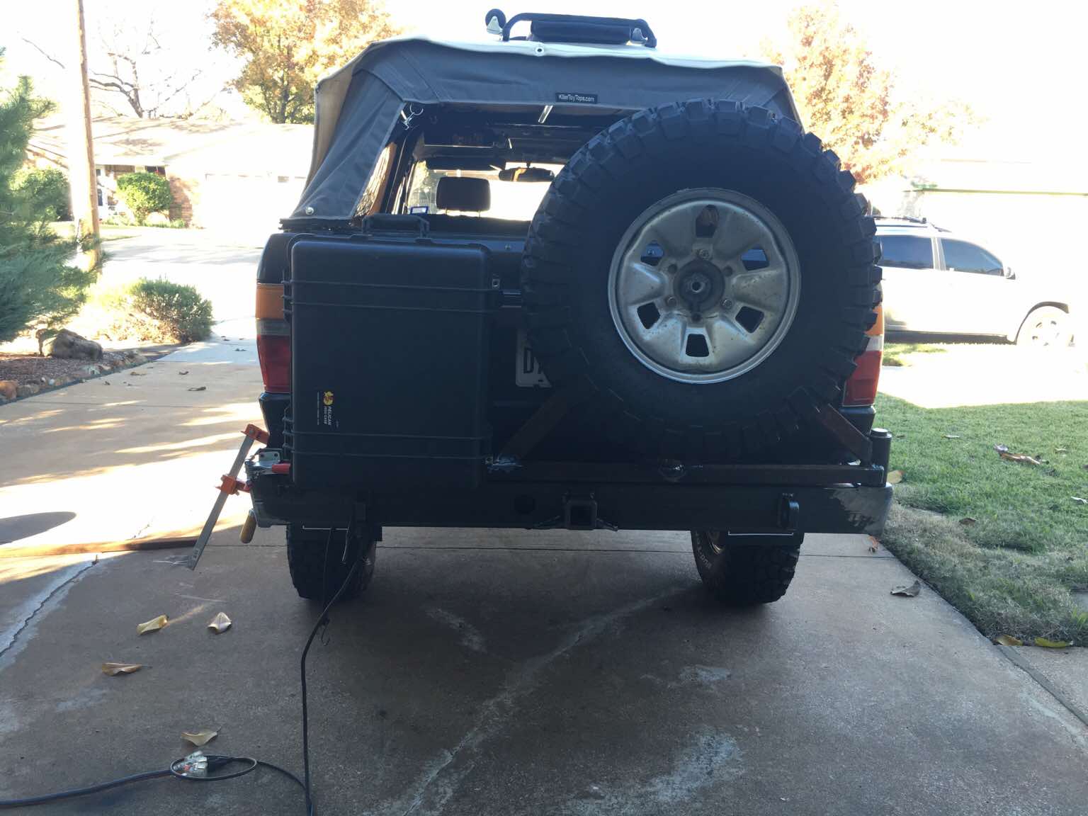

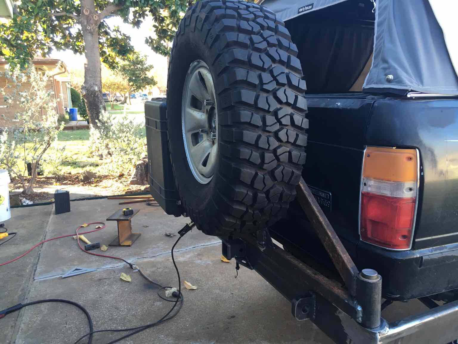

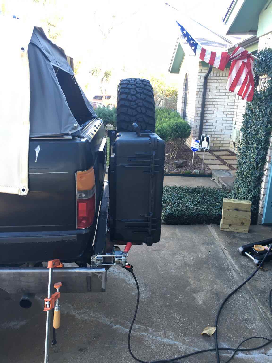

Ok more done. Slight vibration in the swing out if you smack the tire good. I'm not sure if this is normal as I've never had a swing out before. ImageUploadedByTapatalk1449089999.168802.jpg
