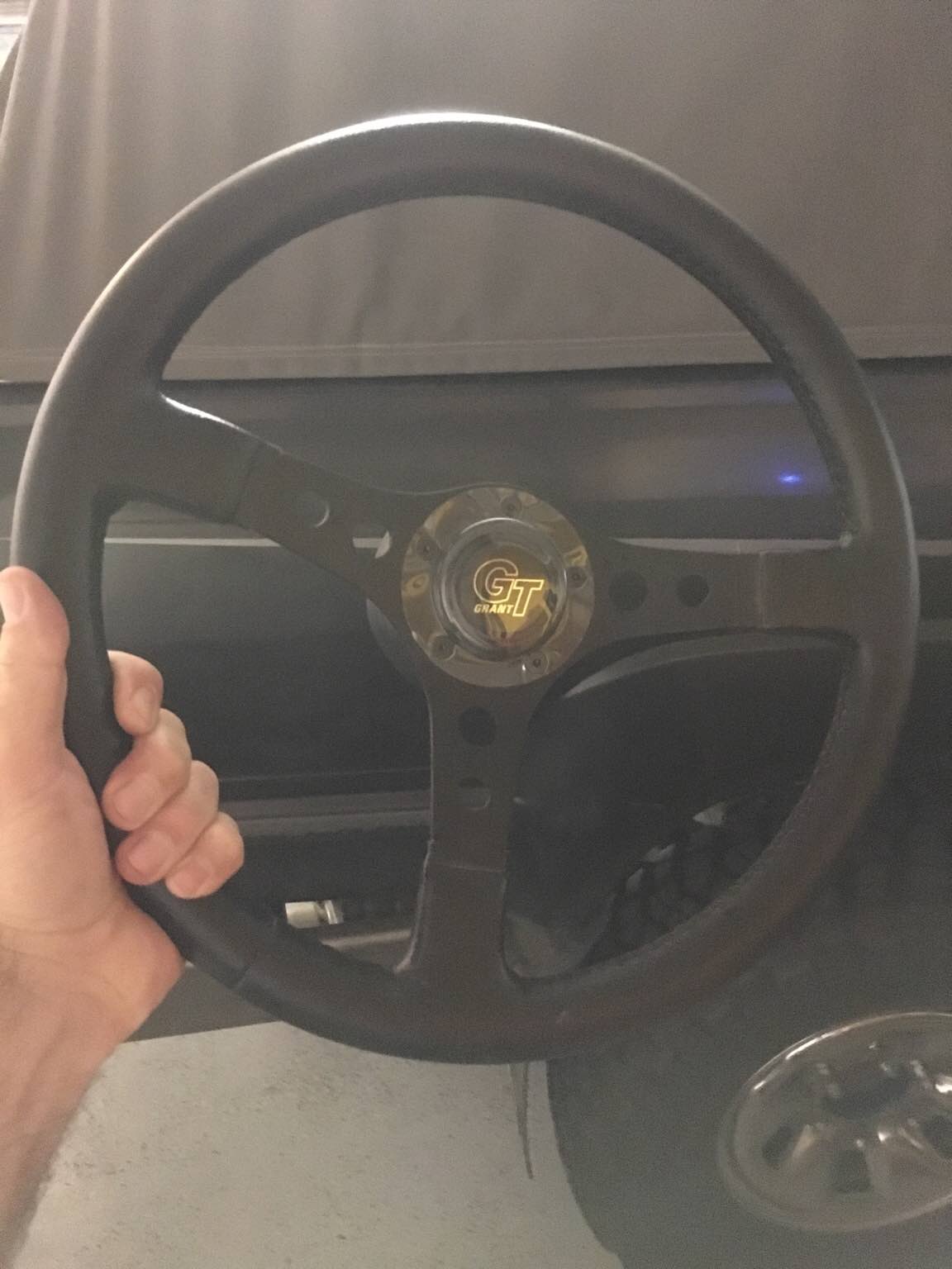

Steering wheel came in, but waiting for the mount. When with 15". ImageUploadedByTapatalk1449784894.107154.jpg
