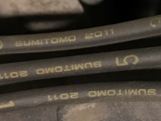

Wait what? Which wires? I have been looking all over the JDM engine to try to find a date code to see how old it is. No luck so far.
The spark plug wires in your picture say "Sumitoto 2011", the same picture that shows where the wire insulation wore through. It's a manufacture date. The original wires on my 1999 said 1999. In 2012 I bought new Toyota spark plug wires and they said 2012 on them.
