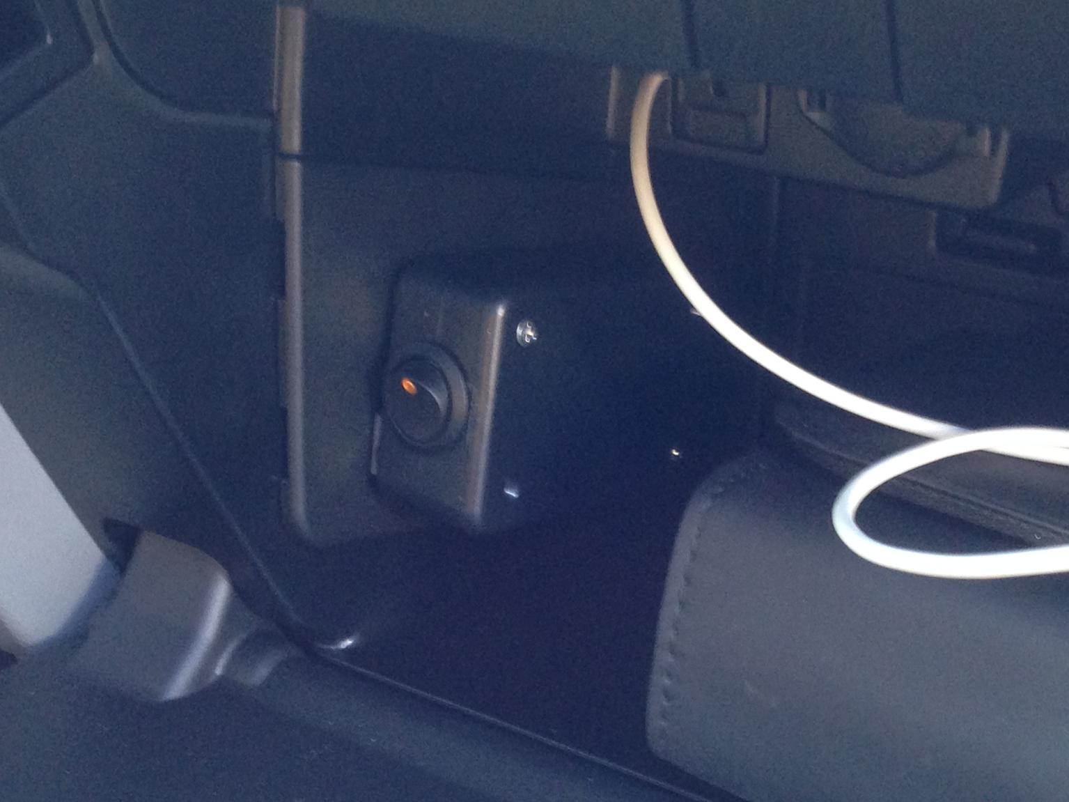

Here's what I did with mine...mounted Switch to Module, then stuck it in GloveBox.
