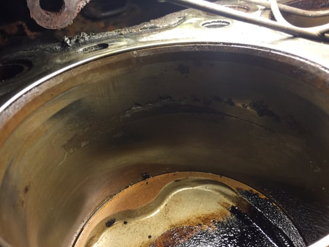

I had a crack in the cylinder which was causing the engine to burn antifreeze. That was causing my P420 code. I installed a spare engine I had rebuilt. No 420 code since then. I’m glad it didn’t ruin my CAT.
