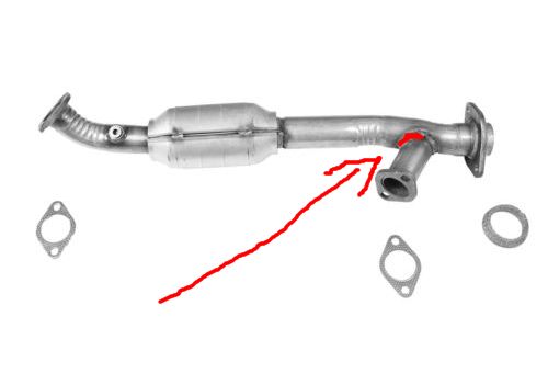

Adding an update to this after 1 year and 25,000 km later, the P0420 and P0430 codes have come back intermittently in the last few weeks.
Had the truck up on my buddy's hoist tonight and found a very tiny hairline crack at the y-pipe, bottom side. Marked in red in pic below.
You literally wouldn't notice it without a magnifying glass or running an exhaust leak test. Simple weld job fixed it right up.
I was somewhat surprised that tiny leak even that far from the downstream O2 can suck enough oxygen into the system to throw these codes.
