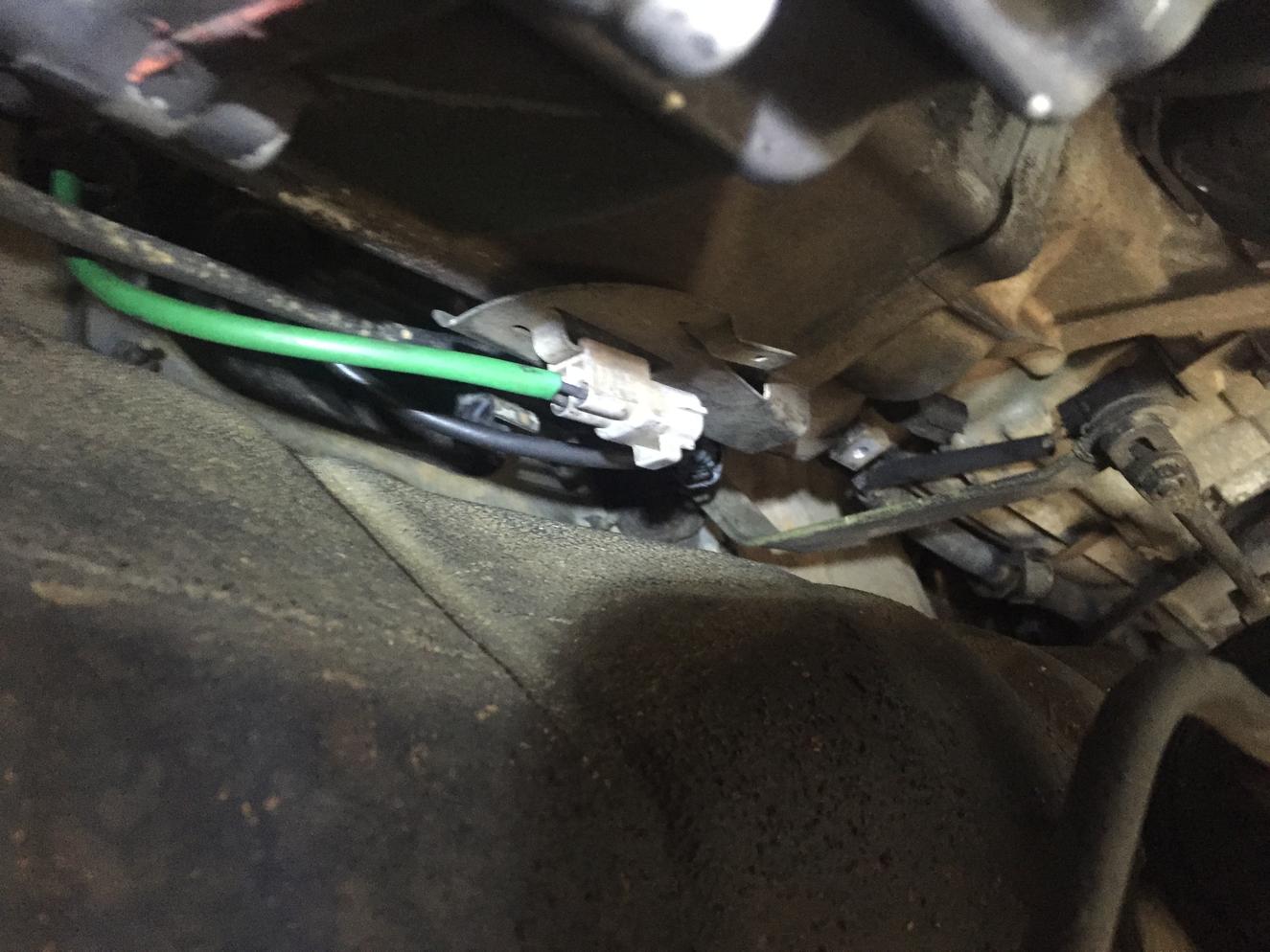

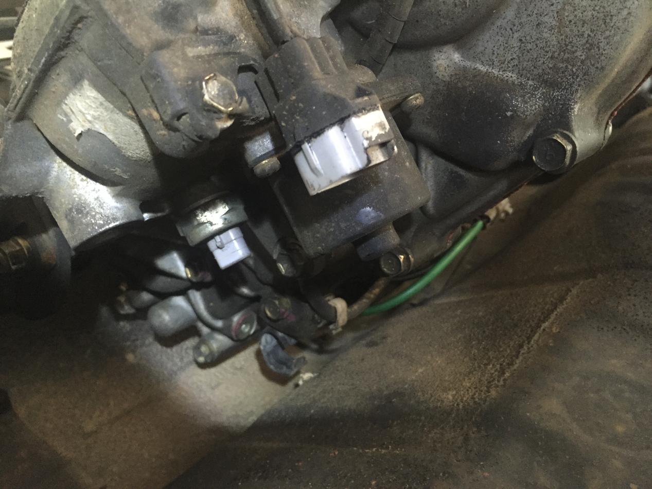

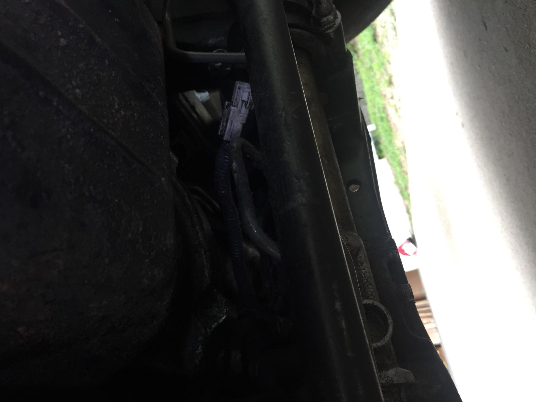

Gents just got me a 96 for a steal with the locking rear diff, of course that didnt come without some issues. Like the absence of the wiring harness that will make you get a CEL P1700 and no 4WD shift lift and I am sure there are other things not working as well... my question I pose to you is does anyone know the name of said harness? I do have the FSM but cannot make out the harness name or P/N.

You mean the harness that goes to all the plugs on the transmission? That would appear to be the Frame Wire. But that does a whole lot of things. See Part G of the attached from the 1996 Factory EWD. That shows all the harness names and their location.
Are you sure this is the original '96 transmission? I have a suspicion somebody may have put a later A/T and ECM into your '96. This may be why your frame wire is missing some plugs. My '99 FSM has no P1700 (I don't have anything earlier) but it does exist in 2002. Funny.
thanks man! I am not sure if it is the original trans and its the wiring harness that goes to the trans and transfer case and front diff? it all started with that ETC P1700 then I find that the speed sensor isnt even connected. well what can you do! looks like I got some wiring to figure out or possibly go to the pick and pull and see if I can find that portion of a harness. But it appears that everything in the attached document is what is not connected resulting in no 4WD light and ETC.. I plan to get it on a lift this week to see if the center diff is locking.
from the information in the FSM I need to locate ED1 ... getting dark here but I will run it down tomorrow in the drive way..
well I have looked all under the T4R and can find no possible place for another harness to hook in. Can anyone tell me if the 4WD harness is part of the frame wire?? or the motor... I would think the frame and it appears that is how it is shown in the FSM.. if not I might have to rig a switch from the 4WD shifter button to the front diff... dont think it should be too hard just need to get a relay!! thoughts anyone?

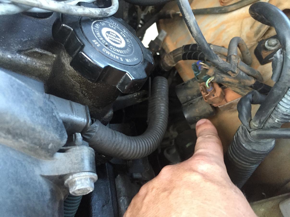

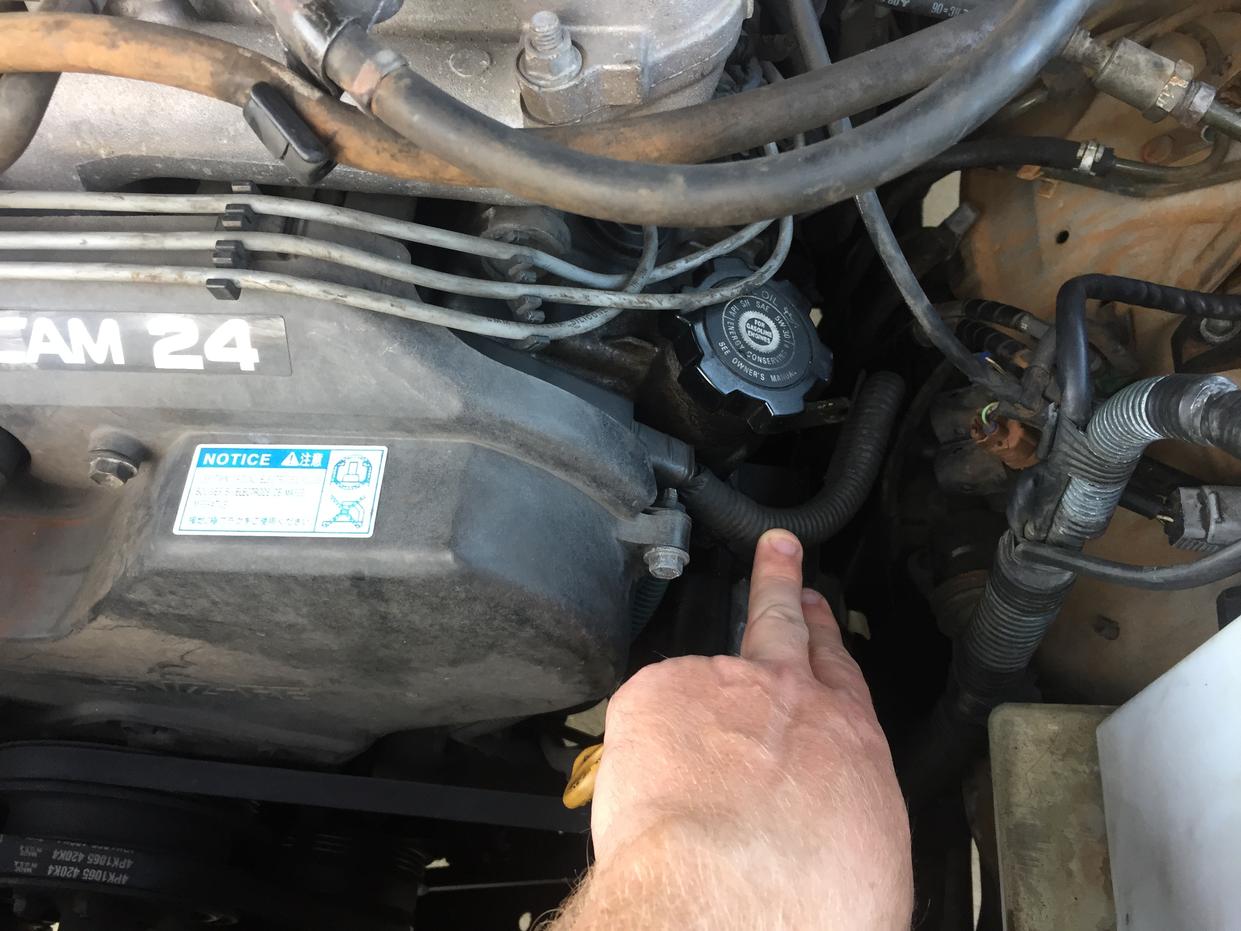

There is only one wire set from the engine harness on my 97 that attaches to the front diff. It is the same on both the manual and auto engine harness. It runs down the drivers side of the engine and near where the clutch slave is it clips to a short run that goes under the bell housing and clips into the rear bottom of the front diff. I am pretty sure that is the indicator light. I did not know that the 96 had a center diff lock. As has been said it sounds like somebody put a newer trans in. Nobody that I have ever met goes around unplugging a wiring harness for no reason and those plugs might clip together easily but they don't like to come apart!

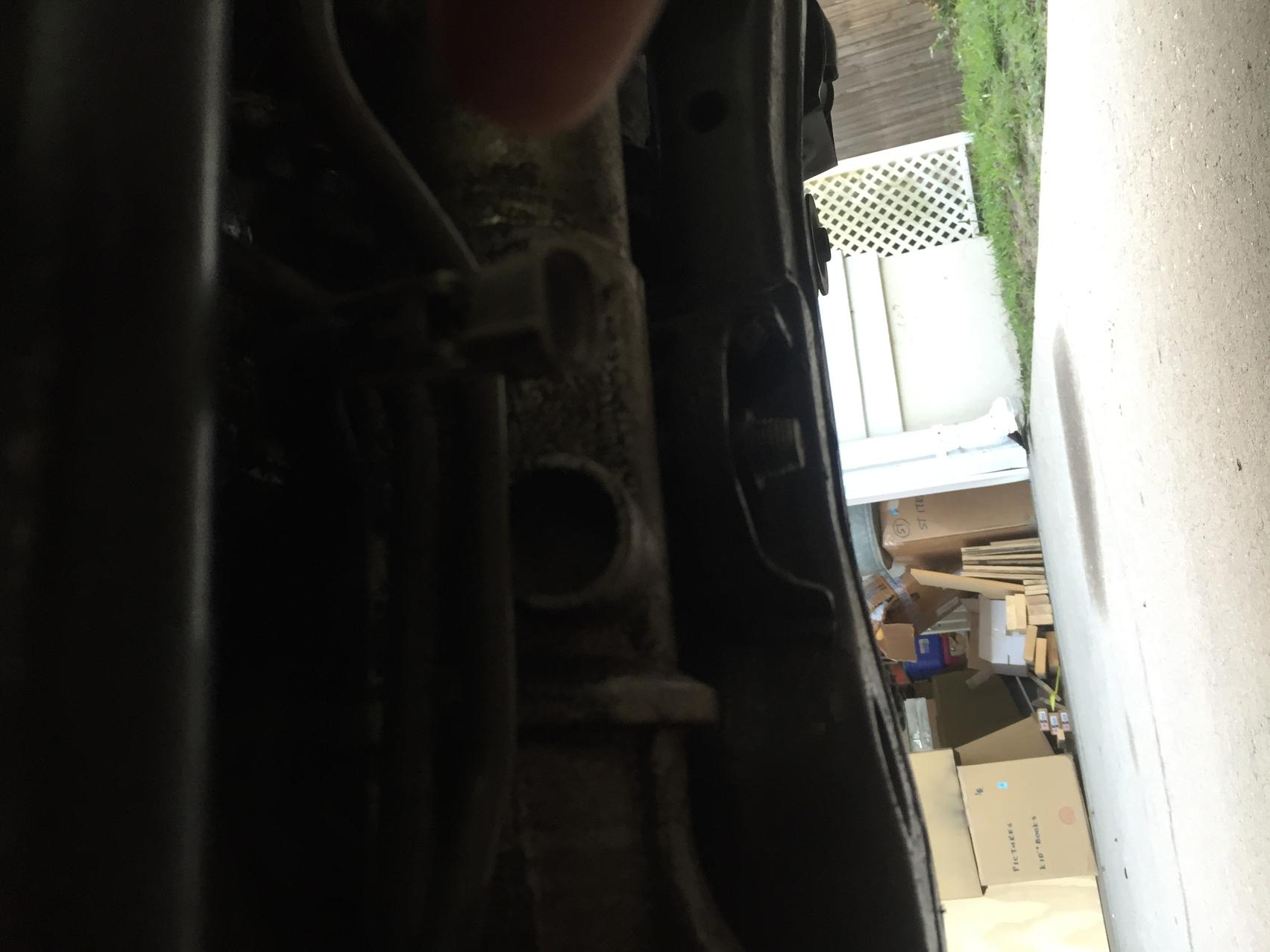

An SPDT switch to flip 12V+ between the brown side and the blue side of the VSV's should work just fine. Is the twin VSV assembly there on the driver fender wall with the hoses going to the front diff? Each valve would need its second terminal connected to ground.

make sure my understanding of the 96 T4R is correct? it engages itself just like a dana 30 on a yj via vacuum? and not electrically? so if that is the case I should just be able to do SPDT switch...right!! the only thing I can see on the front differential is this plug but have no idea what it does? I am assuming that it provides the logic for the 4WD ECU.... and then I have taken a picture of the VSV on the fender...
