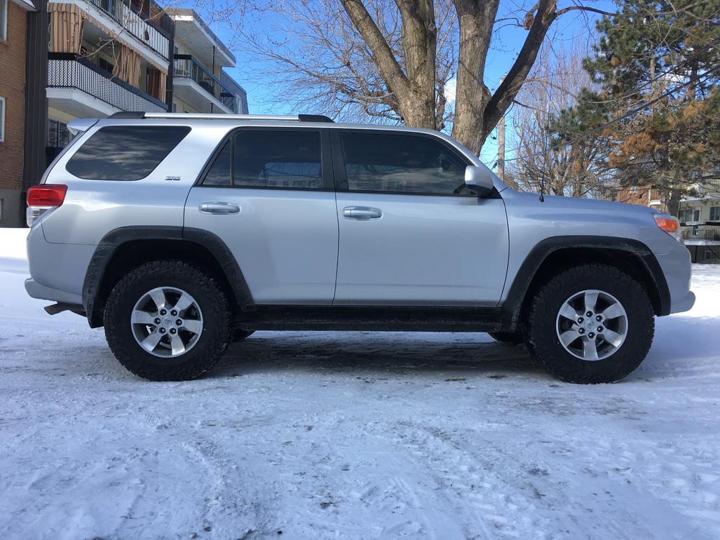

Before and After

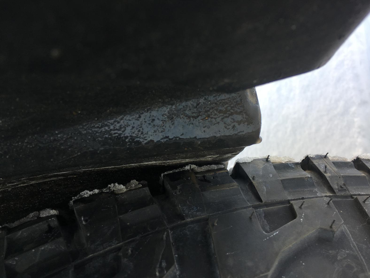

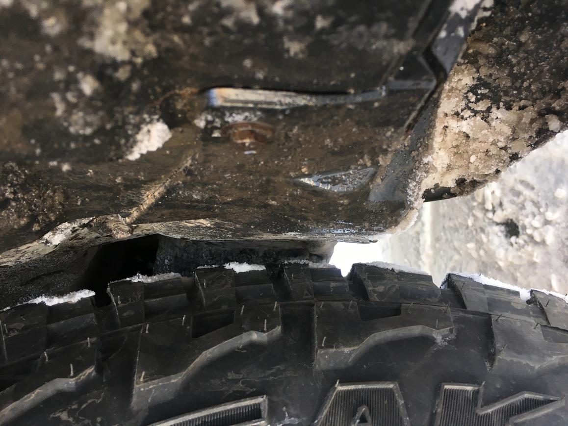

Front wheel at full lock right and left no run at all, even when driving. I had 1.5" front rear wheel space and 1" up front space at full turn. Again, this is with my set up.

Looks good, but I think it will rub when compressed off road, or over a curb etc.

Congratulations but don't get too excited. Remember that another guy with an identical 4Runner might mount those exact same tires and rub like crazy. Caster settings and stack up tolerances are key. You got lucky like several others here. For every one of you there is a guy with the same setup that has to mod to get rid of the rub.
So good for you but this is not a definitive fit.
The reason I say this is people might read your post and think they can do the same with no issues. This is not correct as every 4runner is slightly different. Looks good.
