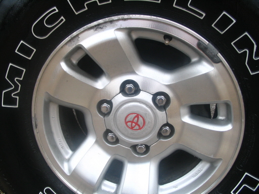

ok so i got out today and got lost in messin with the 4runner... i painted my center caps...i thought about white but then went red ya'll let me know what you think...

I personally prefer black or green(it matches with my car)
But it looks pretty good.
My center cap paint is really chipped. I'm looking to paint them because buying new ones would cost around $60. What did you have to do to paint it?
i popped the centers out, sanded them down, cleaned them with dawn dish detergent, sprayed 2 light coats of silver color, fingernail polish-ed the red toyota emblem let them dry and put em back on....

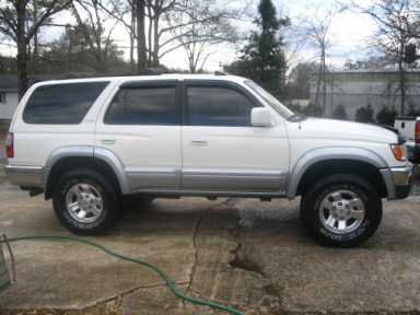

all together
heres what it looks like put together...sorry i just finished washing it and its probably bout rain out here...

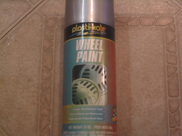

Where did you get the spray of silver?
How long did it take you?
I might run down to the store really quick, buy a can of silver, and paitn my caps.
wal-mart
i got mine from walmart in the automotive section...its plasti-kote wheel paint... barcode thing says silver/argent... sanding and prep took longest... make sure paint completely dries before second coat...took at most 25 min... fingernail polish took a while too cost about 4 bucks total..i like em :D
