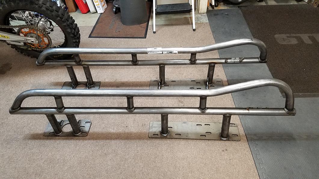

My sliders came in! Does anyone have any tips for going the rustoleum route? How should I prep the sliders...? How many cans?
Clean them up with some sort of grease and wax remover like the Duplicolor stuff, scuff them up, use a few thin coats of self-etching primer, then paint them. How many cans is going to depend on how thick you want it. You'll have time between coats to run out and get more if you need it, but I'd get 4-6 rattle cans to start. If you have extra cans when you're done just keep them for touch-ups or when you have to redo them.

I went OPOR as well and painted them myself. Prep is key, sand and clean them REALLY WELL first, I used 97% alcohol from Walgreens in a spray bottle. Then prime and paint.
I used Rustoleum self etching primer and Rustoleum textured matte black paint. The texture is very subtle but should wear well and touch up easily. I might put texture strips on my steps eventually if they start showing premature wear. 1 month in, looks great! I agree on bedliner being a sponge for mud. I dont think its well suited to sliders. A buddy of mine with a Tacoma also is having peeling issues 6mo into a $400 rhinoliner job on his sliders...not cool!

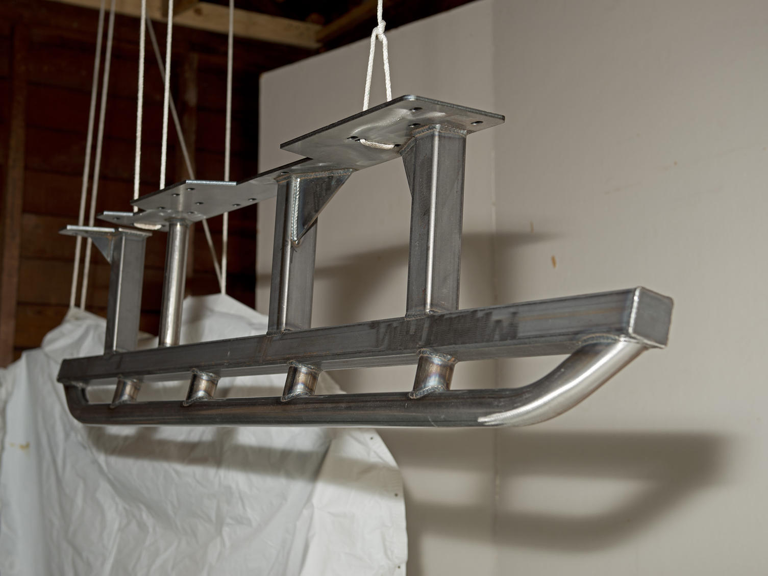

I'm spending my Saturday painting my C4 sliders. Started this morning and taking a break...
Started with wiping everything down with acetone. Removes any oil, grease, stickiness from tape/shipping.
Next hit with some light sanding to clean up any burrs and provide just a little texture to the bare metal.
Just applied 2 coats of Rust-o-leum Self Etching Primer. Should be dry by the time I send this!
Going to hit them this afternoon with several coats of Rust-o-leum automotive matte black.
I did get the step pads for the C4 sliders coated in Lin-ex. Get those back early next week.

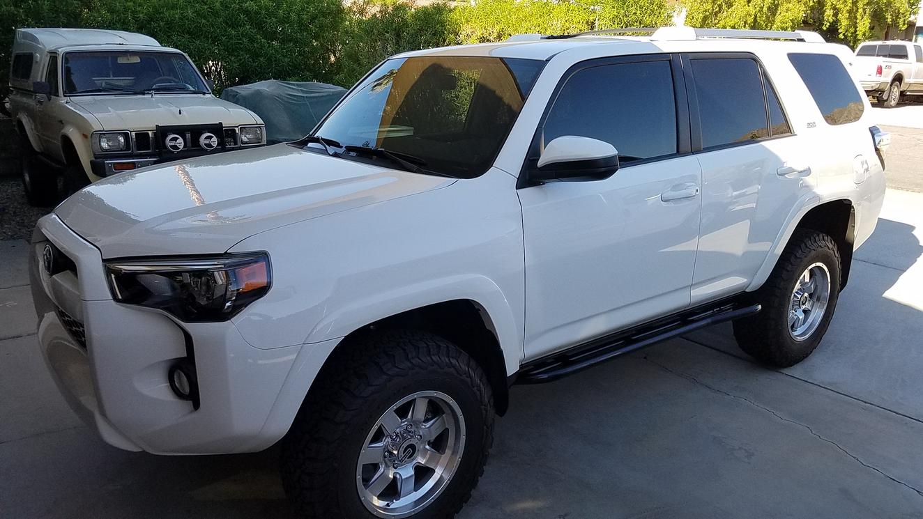

Painting rock sliders
I picked up my Domello rock sliders from their shop in Riverside, CA but went with the bare metal thinking I was going to save money. The time it took me was worth far more than the cost of powder coating. I painted with a brush and a quart can of Rustoleum primer and Rustoleum enamel paint. I have some of the paint (1/2?) left over for touch up. Very little if any prep. I hung the sliders with rope from the garage rafters which allowed me to paint all sides with every coat. I finished with a can of Rustoleum spray paint for a glossy finish, but I actually preferred the hand painted look before the spray paint application. It took a while but two years later it's holding up very well.
