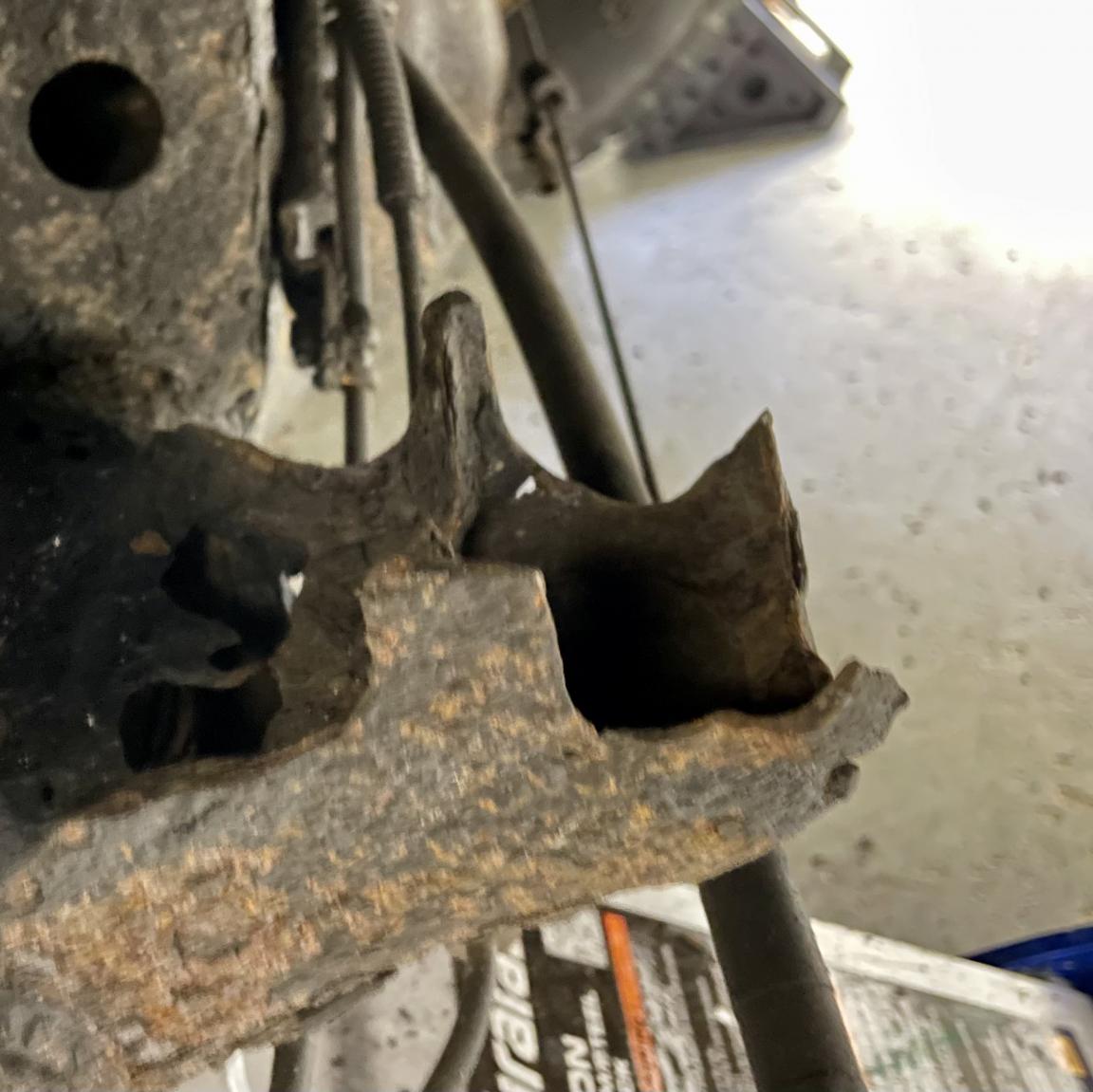

Advice on fixing rusted panhard bar bracket
First post to the forum, but have been living on this site since I started working on a 2001 that I picked up a couple months ago. Frame is in good shape, but have been updating front and rear suspension and fixing anything that is badly rusted.
I didn’t even realize I was missing the panhard bar until I noticed the rusted/broken bracket when replacing the rear coils. I know there are PCK brackets, but they all appear to fit on an existing bracket that is “fully there”. As you can see from this pic, I’ve lost the top half of this bracket.
I can get a welder to attach a new bracket, but I would prefer to give him a part that he can weld on instead of fabricating something custom.
Any advice? Thanks in advance!

It would probably be best to find a complete new housing... Who knows how rusty the rest of the axle is - it could start leaking out the back cover any time (which is where they normally rust through first).
-Charlie
Thanks Charlie. Was hoping to find something easier, but that may be the path I eventually need to take. I’ll start keeping my eyes open for a used housing.

Wow! If a new axle housing ($1065 here) or used axle assembly isn't in your budget, then you will need to fabricate a new panhard mount and then weld it on. If you find another 4runner to measure, the panhard mount fabrication would not be difficult for a good fabricator. You will also need a panhard bar, but there are probably people that have OEM units they've taken off to install an adjustable panhard bar. But with that amount of rust on the axle, I wouldn't be so certain that the frame is good...
If I were you, I'd find a used complete axle with a locker (may as well upgrade!) However, on a budget, make sure the used unit at least matches your vehicle:
  1. ABS or not
  2. Elocker or not
  3. Gear ratio match with your front diff ratio
You shouldn't be surprised if a used complete axle assembly develops (or already had) oil leaks. Rear axle seal leaks are a common issue, and something to consider when buying a used axle assembly.
Thanks for advice! Given the rust on the rest of the axle, I’ve started looking for either a used housing or complete axle. At this point, more concerned about getting something that works well (and will be easy to work on) then saving a few bucks.
