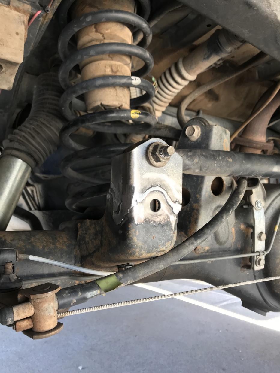

I installed my panhard correction kit from eimkeith on my 2000 4Runner. I just want to compliment him on such an excellent design. It's obviously well designed and a perfect fit, which made it easy to weld into place.
I've been saying for many years how it's theoretically best to keep the center point of the panhard bar as high as possible, so it's important to raise at least the axle end of the panhard bar. I didn't previously install a panhard correction kit because all that was available was to lower the frame end, which would flatten the angle, but would worsen the leverage of the body from the midpoint across the panhard bar. I installed both ends of the eimkeith kit and love it. I noticed a change in the ride after the first bump I went over. I wish this was available 15 years ago.
I already had the extended bump stops, so I don't have a concern about the axle end hitting when articulating.

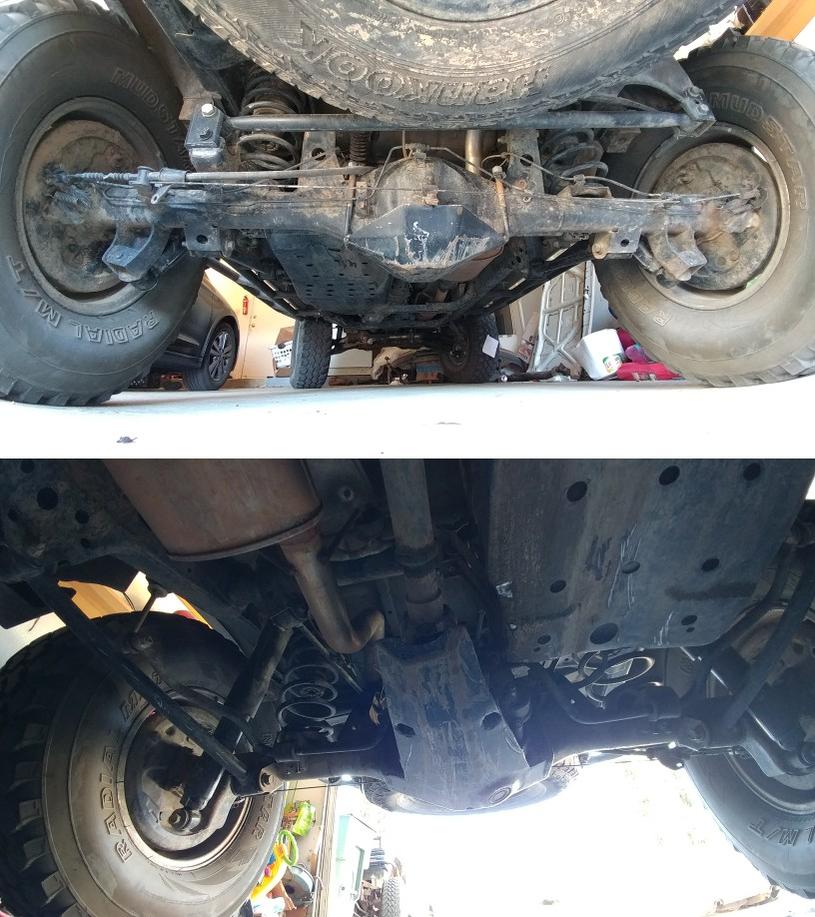

Here's a pic.

I got the Land Cruiser springs lots of years ago from someone else who did the research on that one. I actually forgot the details about the springs. Yes, it would provide about 4" of lift, but I typically carry so much tools and spare parts and recovery gear that it ends up at 3.5" or less.
The rear disks are included in the Front Range Off-Road Fabrication (FROR) full floater conversion kit. It includes Toyota Supra disks and calipers that allow the e-brake to be kept at the wheels (where I prefer it because there are more times where it's safer that way). The full floater kit includes really nice 4340 chromoly rear axles, which is overkill for 33's. One of the primary reasons why I got the kit years ago was because I was disgusted with leaky rear axle seals. The method of sealing the axle is different so I've never had a problem with axle leaks since the conversion (and no more drum brake issues). It's also reassuring to know that I never have to worry about the possibility of seeing my rear wheel and axle pass me on the road if the semi-floater axle/bearings decide to disassemble themselves.
I also had to get a little creative with e-brake cable routing since you might notice the cable is high on the axle and out of the way of rocks.

That's awesome!
I did in fact notice the e brake cable... Liked it, cause I have a rear diff skid plate and had to bend mine up and out a lil n wish I could realign it...

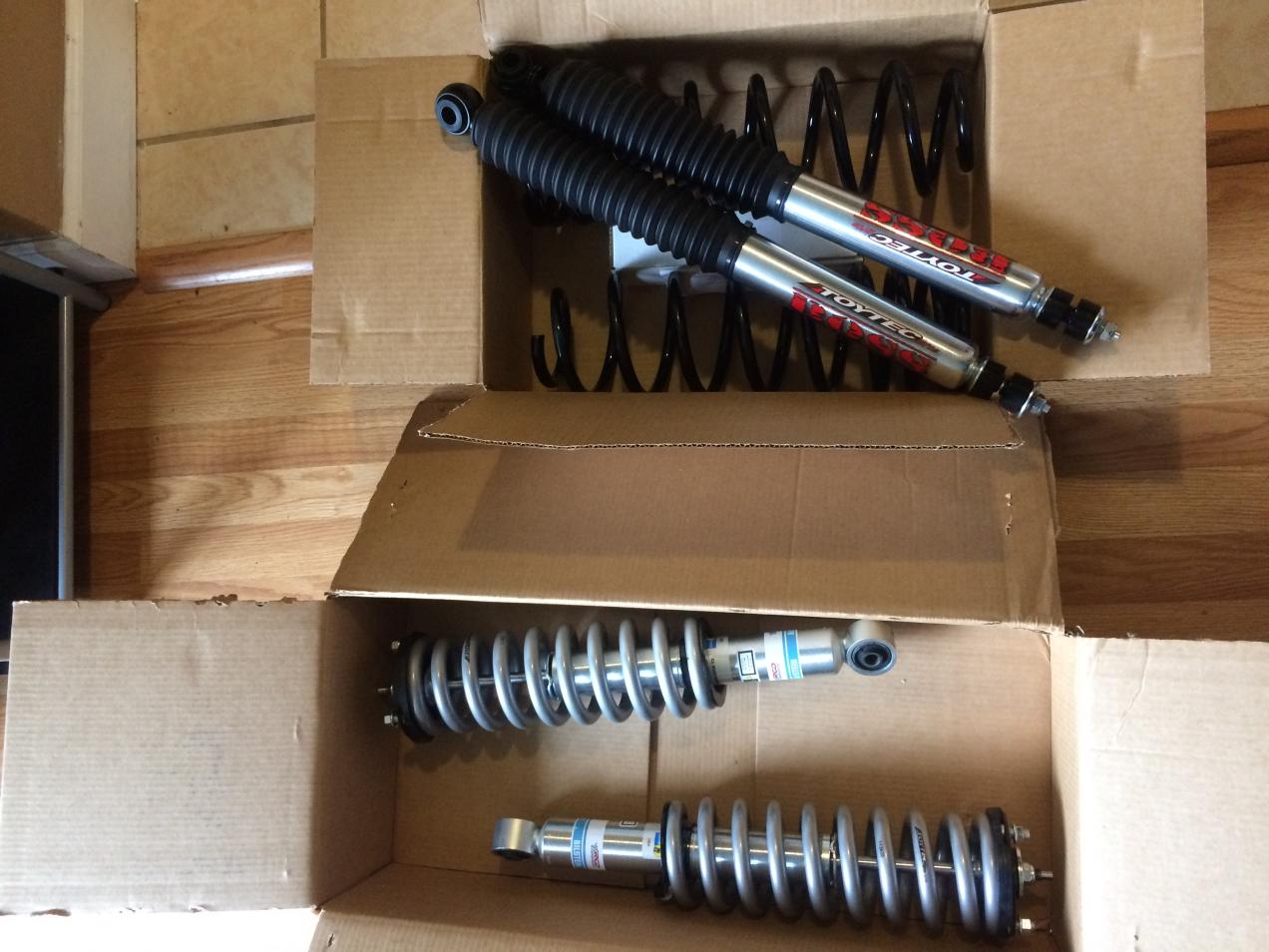

Installing toyteck superflex coils this weekend and didn't think of the panhard bar. Is keeping it stock for a few months or longer going to be a problem?
I drive my 4runner on the street but also in the desert sand whoops etc not high speed stuff usually though.
is there a simple answer to my question?
Won't be an issue keeping the stock one for a while. I did when I had superflexes for 6 months. Only thing you might notice is the rear axle being slightly off center (1/4-1/2").
