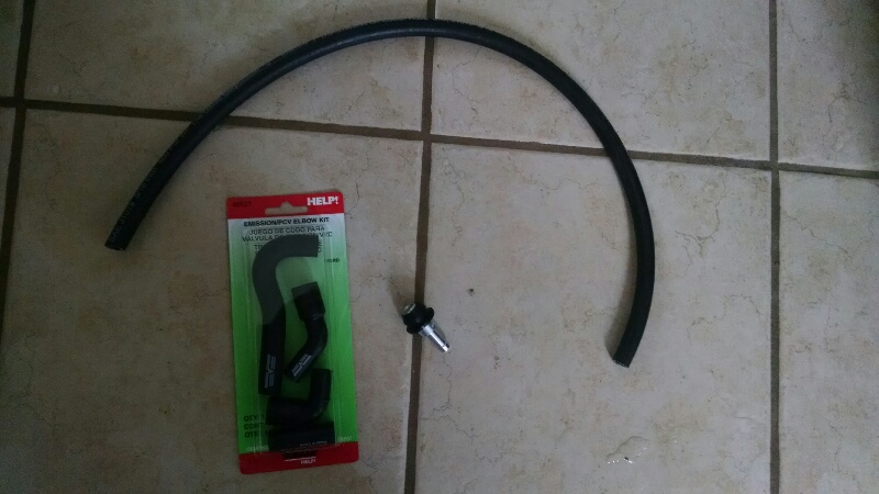

Here's what I'm planning. The PCV valve and grommet are correct for the vehicle. The Help blister pack and chunk of hose will be custom configured.
I will take the plenum off and the valve covers off and hopefully it won't take too long in the snow and cold.
