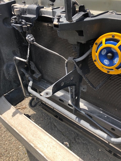

What did you end up doing with this middle bracket? Cut it or leave it?

I would leave it. That’s the bracket I used to attach the center support to
it's gone now
:sadwave:
Bummer sorry I couldn’t get to you in time. You’ll need to figure out some way to secure that center support. Otherwise your headlights and upper grill will be super flimsy. I ran it that way for a few months and the headlights would vibrate over small bumps. You could see it in the lighting pattern while driving

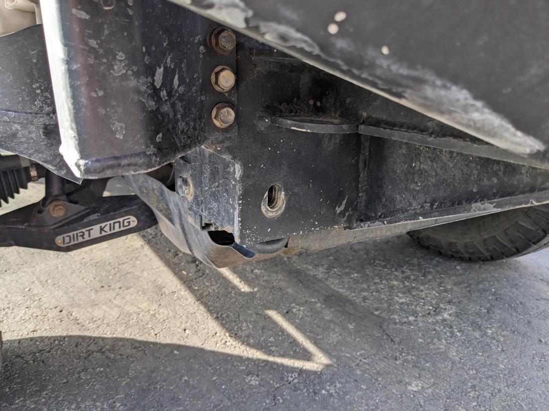

Can anyone tell me what bolt and nut go here? It's been a long time

Looks like you are missing the 'L' bracket that attaches to the bolt to the left and back a bit to that bolt hole.
PM me your phone number and I will send a pic of it.
Belay that; it looks like yours is a bit different than mine. The nut/bolt that is there is about 1.25" long by 1/2" I believe.

This is what it’s supposed to look like. The bolt size is the same every other bumper manufacturer uses as it’s a common attachment point. While you’re in there I would check your frame mounts. This bumper is notorious for cracking right at the frame rails. Mine was doing exactly that and I had to retire it because of it.
Here’s a shot of mine in that area
Yours looks like a newer version of Tristero's bumper.
Youre right it does look a bit different. Maybe the older designs were better? I got my bumper right before they went out of business so I'm sure at that point they were already taking shortcuts
