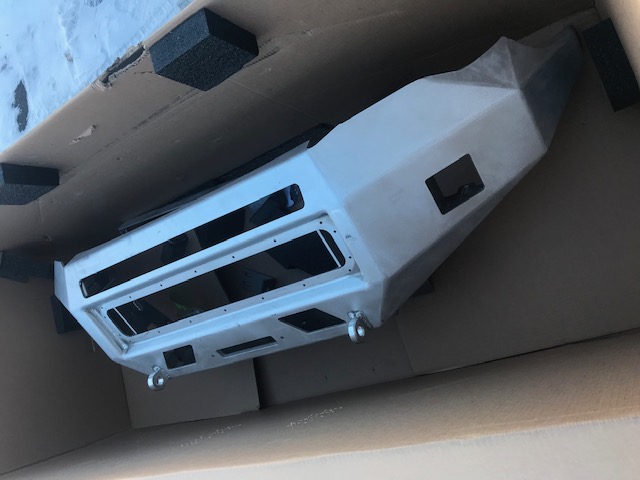

Bumper showed up this morning - aside from minor scratches and dings (which I was expecting after moving from SoCal to NorCal), the thing looks awesome. Hoping that whatever powder coat place I bring it to can blast out the blemishes easily.
Not super happy it's 10 degrees outside right now. Need a major warm up before I can throw this on.

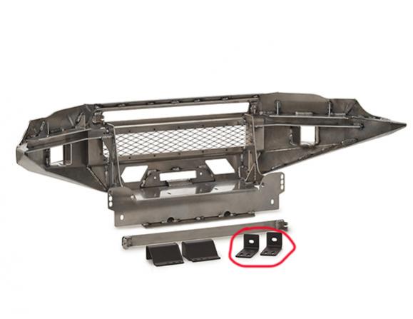

Drove out to BAMF on my lunch and picked up this morning. I thought I got everything until I started reading the install instructions—I'm missing the lower L bracket supports...
:frusty:
Curious if those that got bumpers from BAMF received all the parts? I just emailed Jerry, and I'm sure he'll sort this out.
