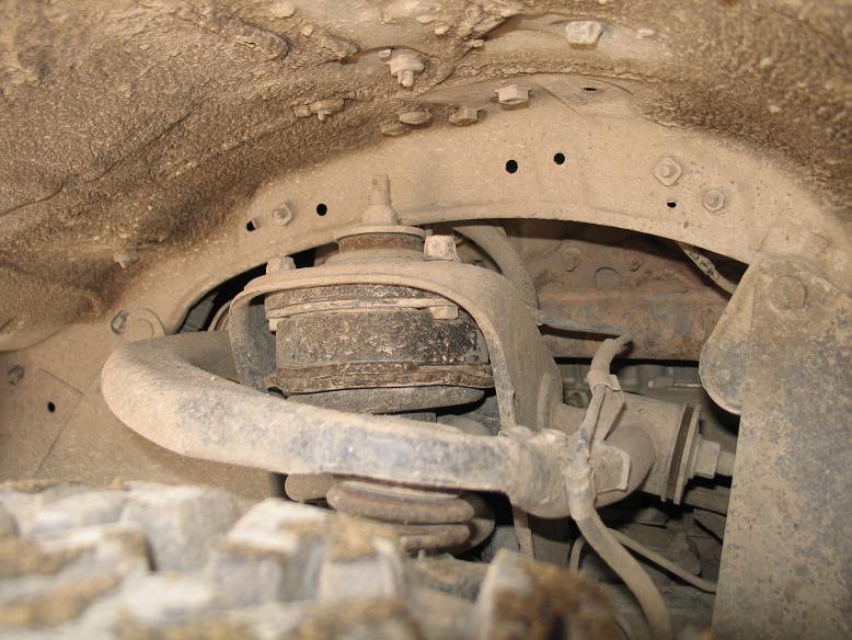

Yes, you're right. First kit was 2+1, second 3+2. First kit I was testing for Cornfed when they used some new materials and they were interested how it rides, wears etc. After I done the research they send me a new kit (3+2). Interesting point, both kits were UHWV rear spacers and UHWV lower front + alum upper front. I can take some pictures of my present setup and post it here tomorrow.
What is the thickness of the lower front spacer on your current front? I think I had heard that the guys at Cornfed had a few different early variations to the Poly spacers and that some re-used the factory rubber isolator. Yours may have been one of those, you might try contacting Burtman Ind. or even Cornfed Suspension directly to find out more info on that.
I reused the rubber isolator. How thick??? I'd need to take a measurements. Will let you know tomorrow.
Front:
Upper ~3/8-7/16" aluminum
Lower ~15/16" UHWV
Picture:
