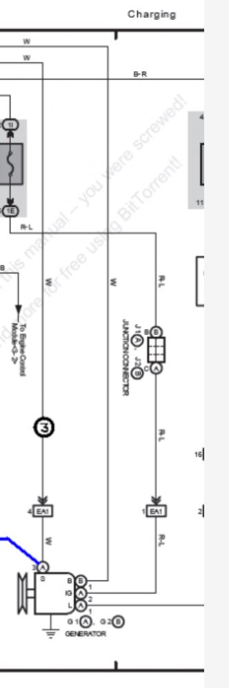

I realize this is an old thread (but still alive) and I appreciate the information, and plan to run some of this wiring. However, there is a problem, and a SERIOUS SAFETY ISSUE with this upgrade, specifically wire #8. The factory fuse link and 120 amp fuse are designed to protect the alternator, and the fuse link the rest of the vehicle wiring and components. By adding a second circuit with another 120 amp fuse, you are providing a 240 amp circuit when the engineers design it for 120 amp as a safety feature.
For example, if the fuse link blew (to protect the wiring and components in the vehicle), there would still be the second 120 amp path back through the fuse box via the alternator wire (#3 in your diagram). In reality, the fuse link would probably not blow at all until the total load reached 240 amps, when both fuses blow together (and maybe the fuse link). To make it simpler to understand, if the load reached 120 amps (the point the fuse should blow, by design) with this scenario, each circuit path would only have 60 amps flowing (since the current would be flowing equally in both paths), so neither fuse would blow (and your 4Runner might burn to the ground). In order to blow either 120 amp fuse, the load would have to reach 240 amps.
If you are going to use wire #8, you should pull off the fuse link (wire #1) and jumper the 120 amp alt fuse in the fuse box (or leave it be - a 120 amp fuse is essentially a jumper as far as the 30 amp fuse before it is concerned). That way the current from the battery will have 1 path, with a 120 amp fuse, to feed the fuse box and vehicle circuitry. The other option is to put a 60 amp fuse in each path (replace the 120 amp alternator fuse with a 60 amp, and use a 60 amp fuse on wire #8), for a total fuse capability if 120 amps.
I accidentally reversed the jumper cables while jump starting my wife's car recently and it blew the 120 amp alternator fuse, and 7 or 8 smaller ones. The 120 amp alternator fuse saved the alternator, ECM, and who knows what else. If it hadn't blow, I'd have been replacing lots of components and wiring harnesses (and maybe a car!) instead of 8 or 9 fuses.
Also, in your diagram, wire #8 connects to the 'B' terminal on the alternator, and the wire labeled as #3 is also the wire running from the 120 amp fuse to terminal 'B' on the alternator.
So what you are saying is that looking at the diagram, the components to the right of the alternator are now exposed to a 240A short whereas before they were only exposed to 120A .... ?
Because the components to the left should be fine. Each path will blow if 120A is exceeded, same as factory.

No. Two circuits (with the same resistance) in parallel, which is what this is, divide the total current flow equally between them. Since each path will flow equally, it will take 240 amps of current to blow EITHER of the fuses, which is twice the factory rating. As I said, if the total flow is 120 amps (which is where the factory fuse should blow) each fuse will only have 60 amps flowing through it (half the total current flow), so neither fuse will blow.
The safe way to do this is to remove (or disconnect) the wire from the fuse box to the alternator (wire #3 in the diagram) so there is only one fused path between the battery and the alternator (leave the fused link connected to the battery).

Let me start by saying I think the big 3 is big to do about almost nothing. I haven't done it to mine, nor do I intend to. 175K and no indication I will need it. Still I see the benefits IF, there is an alternator upgrade, or additional batteries, or you have not maintained the terminals/wires. So now to the problem.
Too many assumptions here. First the resistance in the two branches is NOT the same, that's the whole purpose of the upgrade. 2nd, if there would be a short to ground drawing big amperage, it would happen in an individual branch of the circuit. Since the current would take the path of least resistance, one branch fuse WOULD blow, most likely the added circuit breaker because that would be the path of least resistance. Of course you'd still have voltage, and therefore current flow because the 2nd branch would still be live. I haven't tested this, but I do think the 2nd fuse would then blow.
Now, if the alternator itself caused the short it would most likely draw all the battery could give, in which case 240A is nothing. Hell the starter could draw that much. Of course by design a short circuit anywhere in either branch would be just as catastrophic in terms of amperage draw.
And THAT is why this is really NOT a safety issue at all. Unless someone tells me that people doing the big 3 are burning their rigs to the ground.
That being said I agree with Ozark dude in that bypassing the original alternator circuit would be prudent. The redundancy is unnecessary anyway, and who wants to have to deal with a blown factory 120a fuse. Let the breaker do it's job and move on.

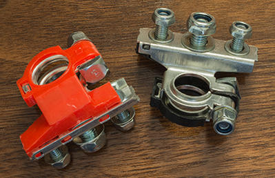

Other than my positive post being rusted together and my new terminal post being too big, this wasn't too bad. If if weren't for those hiccups I could have had it done in 2 hours or less.
Here are the battery posts that I bought from Napa they are military grade. Negative post us on the battery and the positive is not yet, due to me not finishing the POSITIVE wires upgrade with 120amp.
NOTE: Stud for wires are facing sideways, compared to facing upwards.
Just got these off eBay for $12 shipped and wanted to show them to the members looking for multiple post connection points.
Will be ordering ready made 4AWG cables after I take some dimensions. Great thread...
These are nice. Are they military grade?
I don't know what military grade actually means - care to offer a definition? They are eBay grade! You know what that means...
They are well made and plenty stout, and I hope the 'gauge' of steel used is equivalent to the electrical need. The nuts are Nylocks and the plastic pads are nice and heavy so I'm expecting them to be an improvement over other post designs.

Ok, so in regards to the numbered wires in the original post, you are saying to remove #3 and just run #8?
