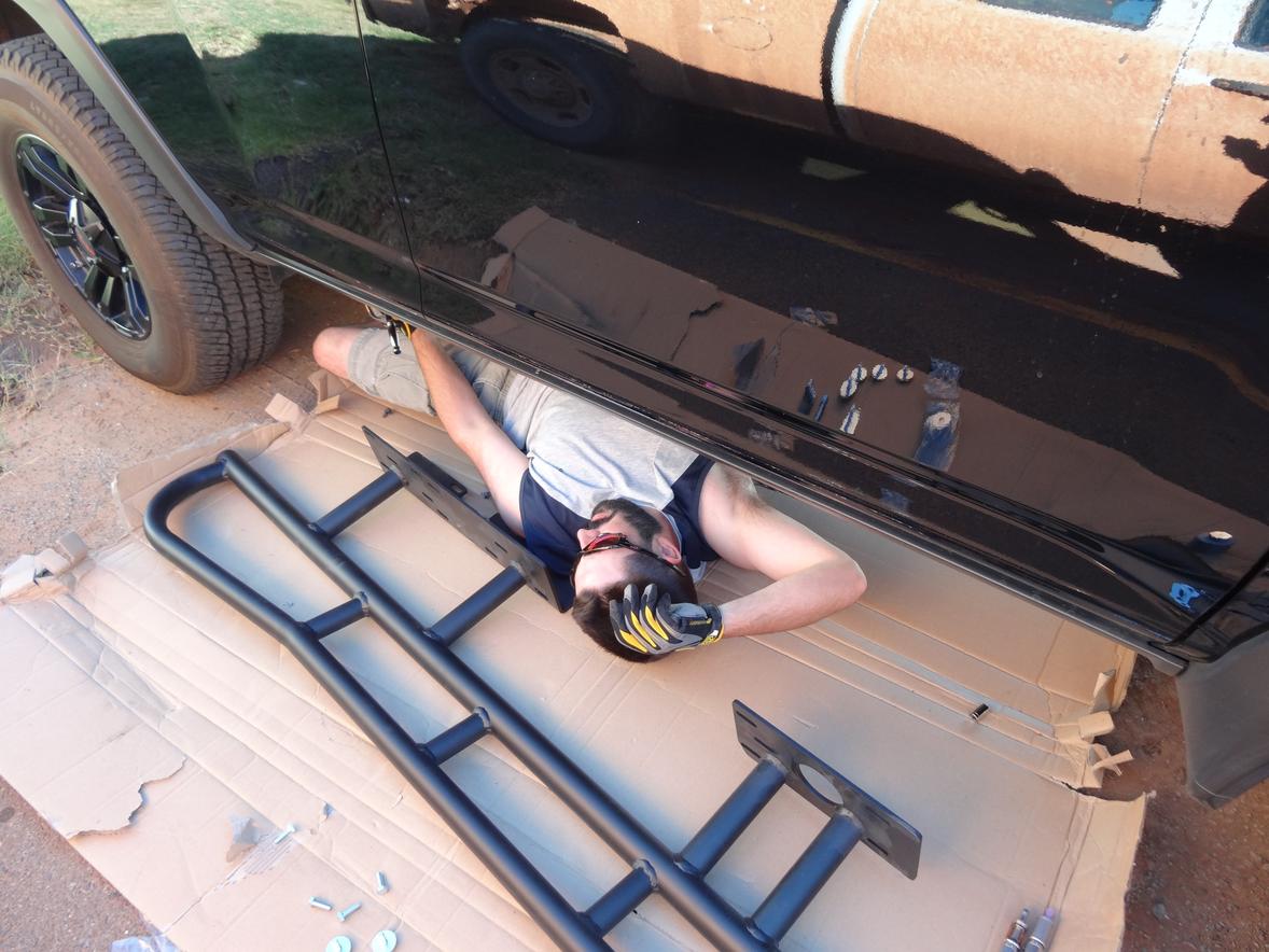

Next mod was the Bud Built bump out sliders (not beefy). They are awesome! Can't say I have really beat them up on the trail, but I'm sure they will be functional too. I had to install them in the parking lot of my apartment building in Elk City. Install wasn't too bad minus the lack of garage, equipment to hold them up, and the crazy western OK heat.

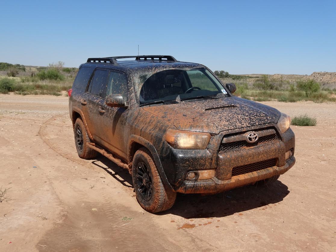

Then we took our first wheelin' trip to Texas, a few miles North of Amarillo to an ORV park right off the highway. It was pretty fun - you could drive down the Canadian River and they had some decent hills and trails. I did scratch the crap out of the T4R (even the hood and roof!) but we all had a great time. Our girls had never done anything like that and absolutely loved it! I even pulled a stuck quad out of the river.

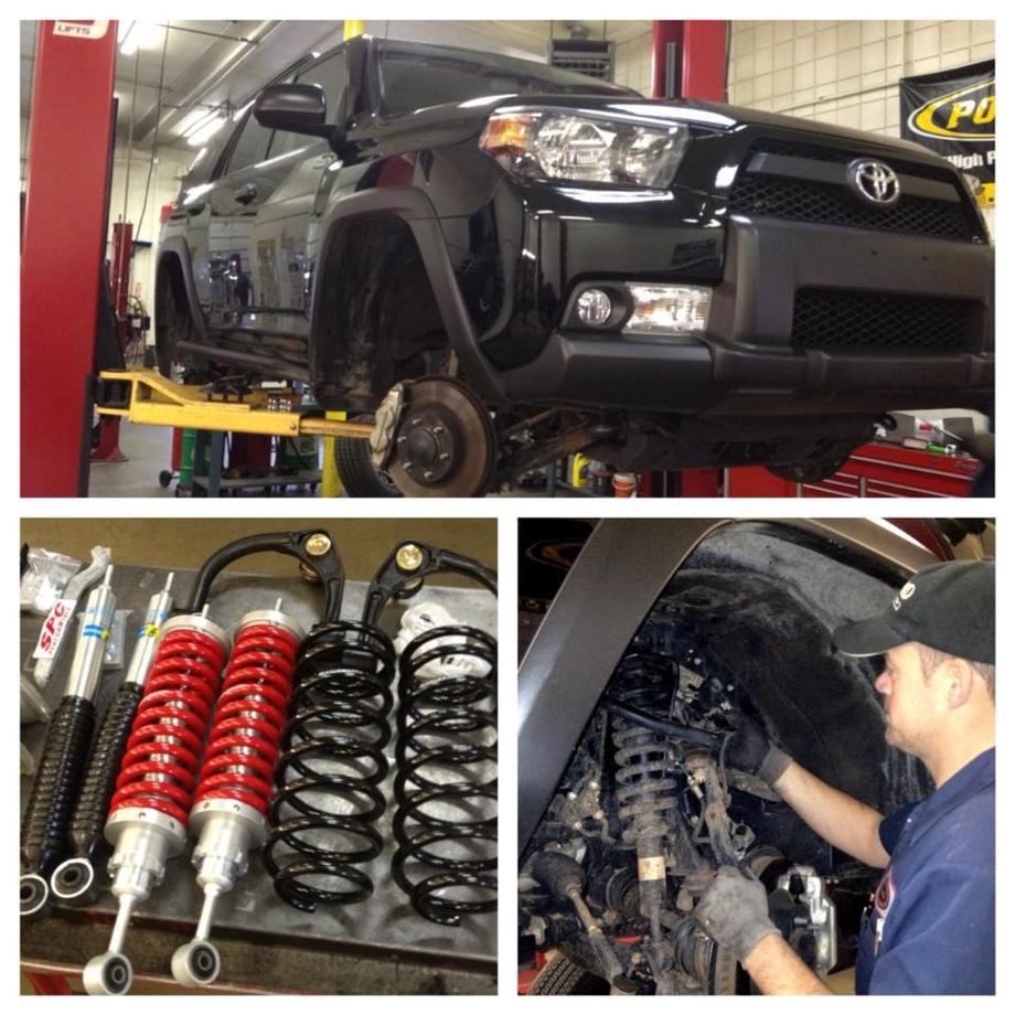

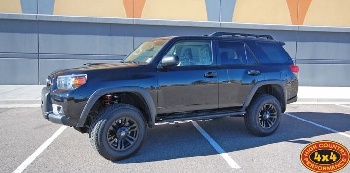

Next mod was the Toytec Ultimate lift. I drove back up to Denver to get the lift installed after asking a couple shops around town. First shop didn't know what a 4Runner was, next one thought Toyota was a division of Ford!!:frusty:
Needless to say, I wasn't going to let them touch my baby, so it was well worth the drive. I had a friend in HS who got a bunch of work done from High Country Performance 4x4 and they came recommended from Toytec, so I went with them. Couldn't have been more impressed. Chuck, the service manager, was great. I asked so many questions and he never got tired of answering them. I was particularly nervous with the small time frame I would be visiting but they had all the parts and did a great job.
I decided to do the LR UCAs, might as well not cut corners. I had them set the front about 0.5" lower to keep some rake on it. The alignment came out great and I can agree with everyone that has said it, this is the way the truck should've come from the factory. I love the way it sits and handles. They had no problems with KDSS or warning lights, etc. I have the alignment sheet somewhere if anyone would like to see it.
They took pictures for their website as an added bonus! After the lift I headed up to ToyTec to show it off and pick up some stickers. They are really nice guys too. I would highly recommend both ToyTec and HCP4x4.

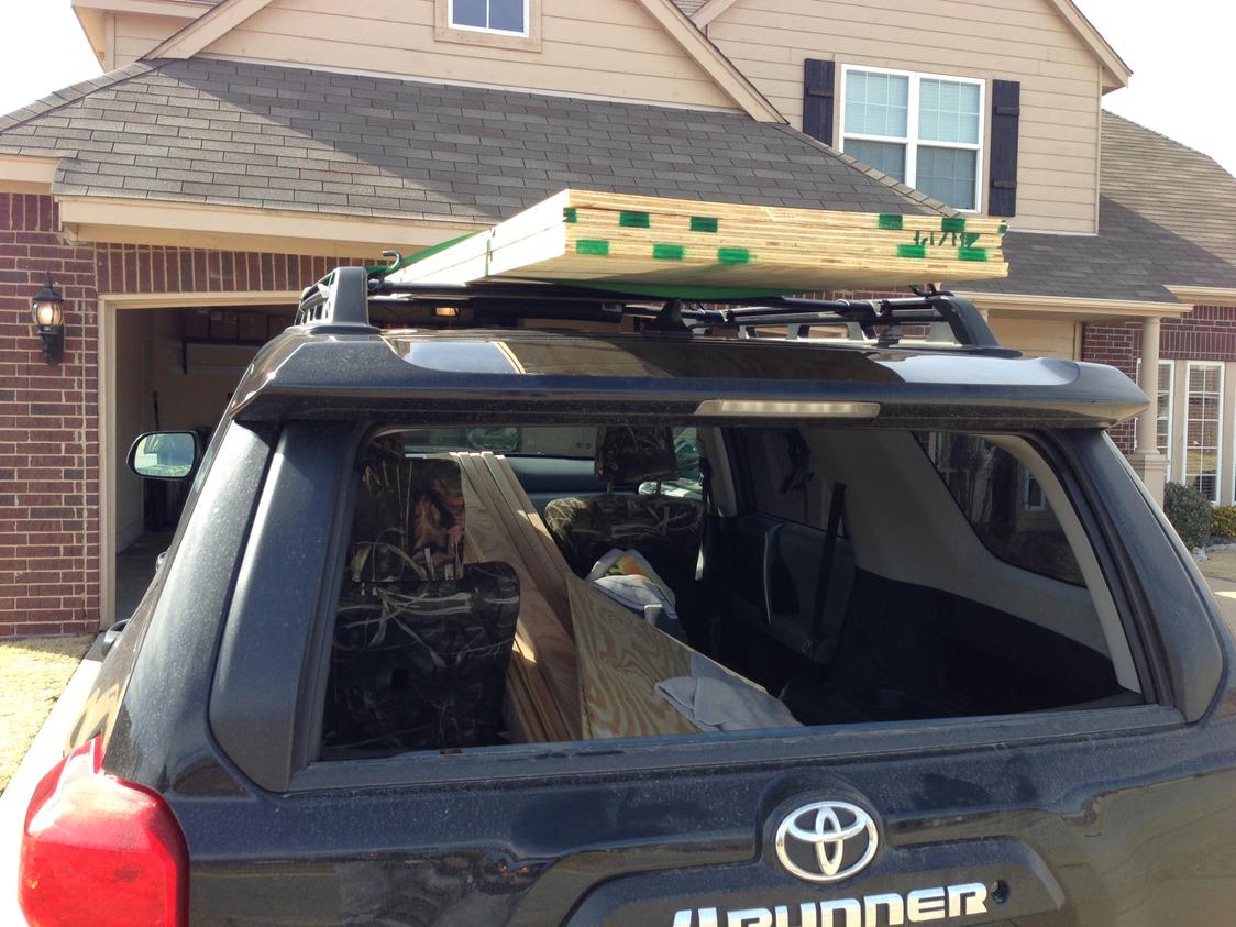

I started building a workbench for the garage today and took a trip to Lowes. I have 8 - 2x4x8' and 2 - 2'x4'x.25" inside and 4 - 2'x8'x.75" on the roof. Luckily it was a short trip cause a hard brake would have meant new windshield. I wasn't sure that the roof rack would handle it, but it worked out pretty well. Even if it got bent I figured that would be a good excuse to get a new rack sooner. This thing is a workhorse!
This picture also gives a good shot of the seat covers, great coverage on the back of both rows of seats. I had pipe insulation protecting the rack crossbars but we hit a bump and lost the rear one to the wind.

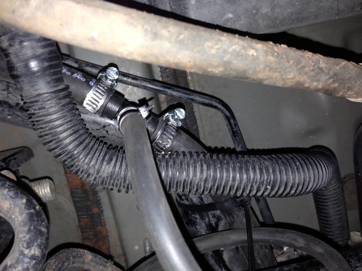

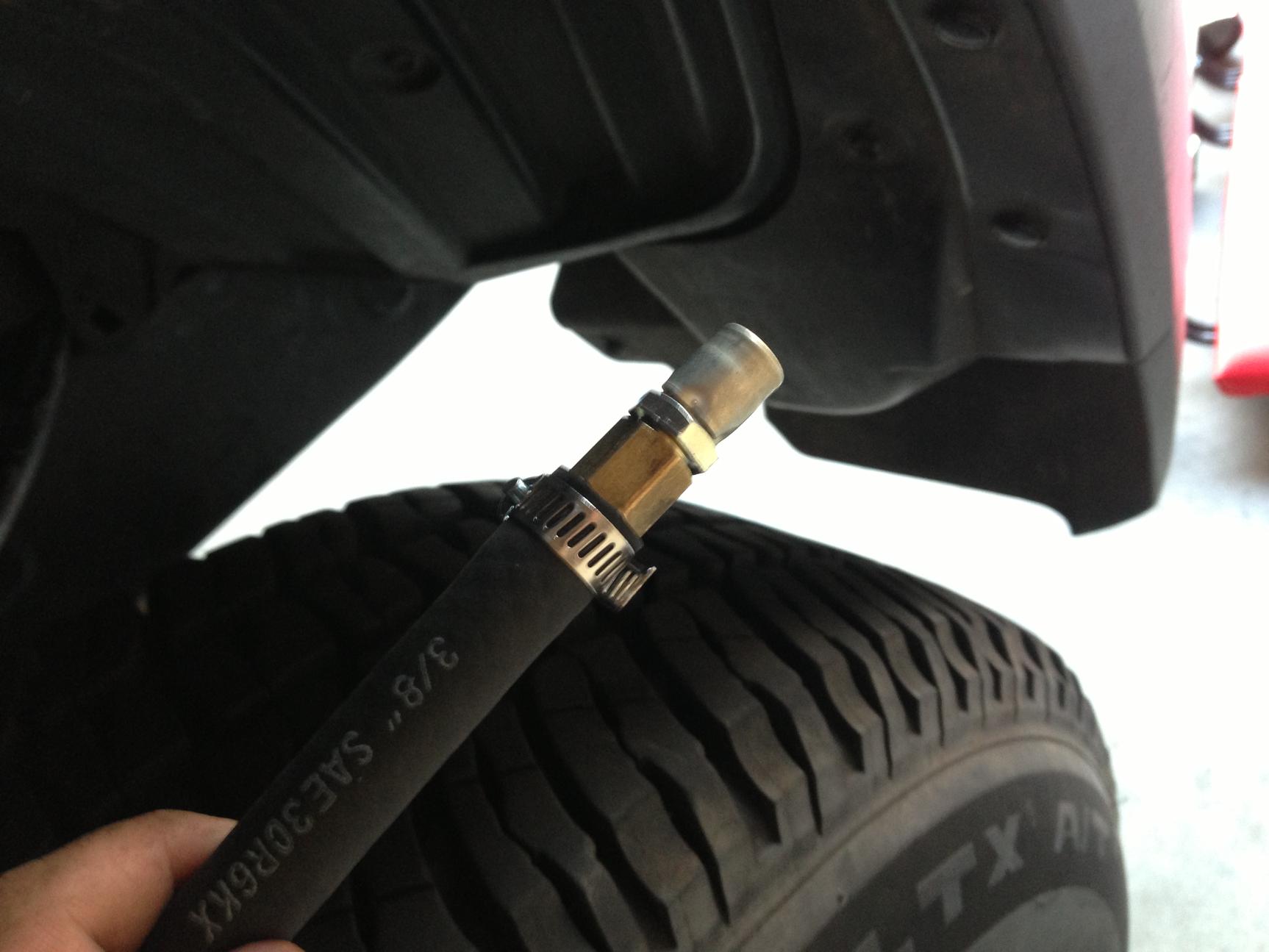

I did the breather relocate. Thank you to everyone for their write-ups. I took some pictures that give Antman a run for his money, not only with a cell phone but rather blurry to boot.
I combined the two breathers with a barbed t-joint and ran the new breather valve (OE) up on the filler neck. I didn't like the idea of cutting into the tank filler area so I zip-tied the hose and breather just on the backside. That area is pictured and easy to access through the wheel well. I put a generous loop in the line to allow for suspension articulation and all of the joints are zip-tied or clamped. One other note regarding the clips holding the plastic in the wheel well. Allegedly, there is a tool that allows you to push in the tabs on the backside to slide them out. I took the rip into pieces and destroy method, which worked well but I had to purchase new clips from the dealer at $1.75 or so each. This is a good cheap mod for piece of mind.
For the life of me I can't get the first or last pictures to rotate, my apologies. Let me know if you have any questions, I know the pictures are not terribly clear.

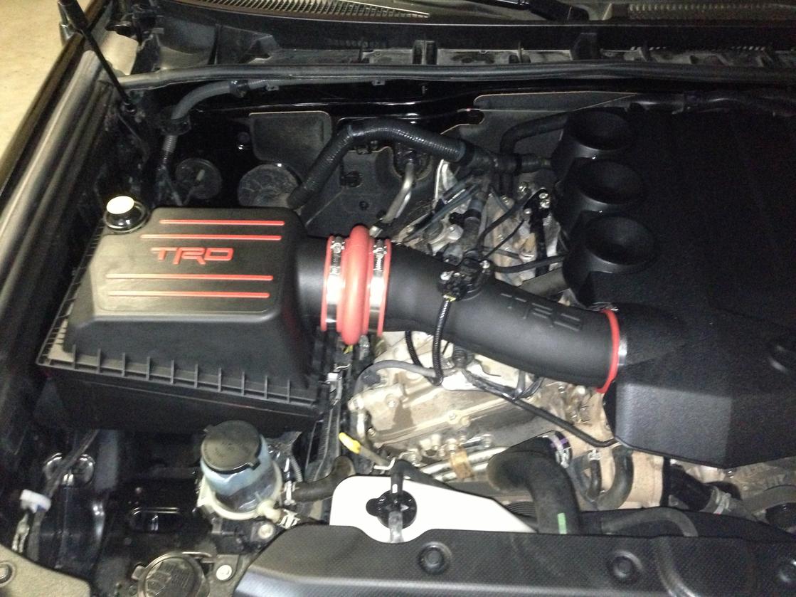

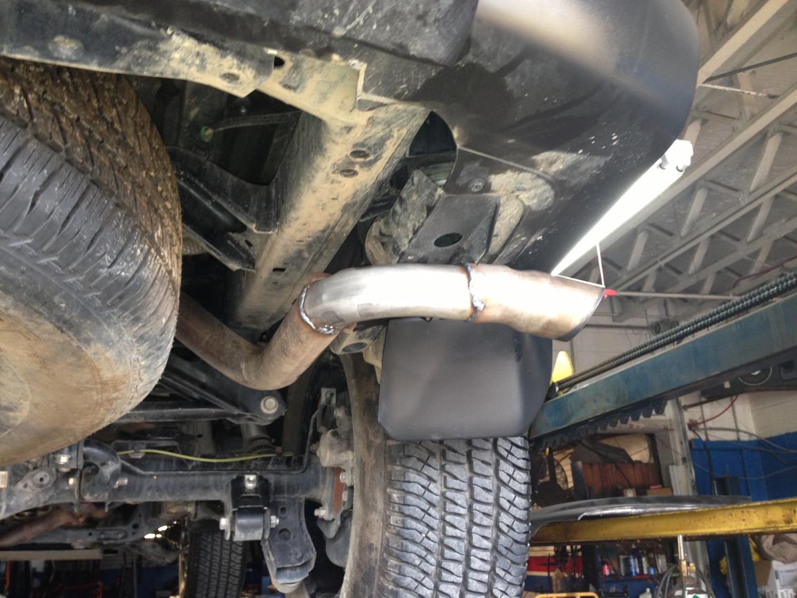

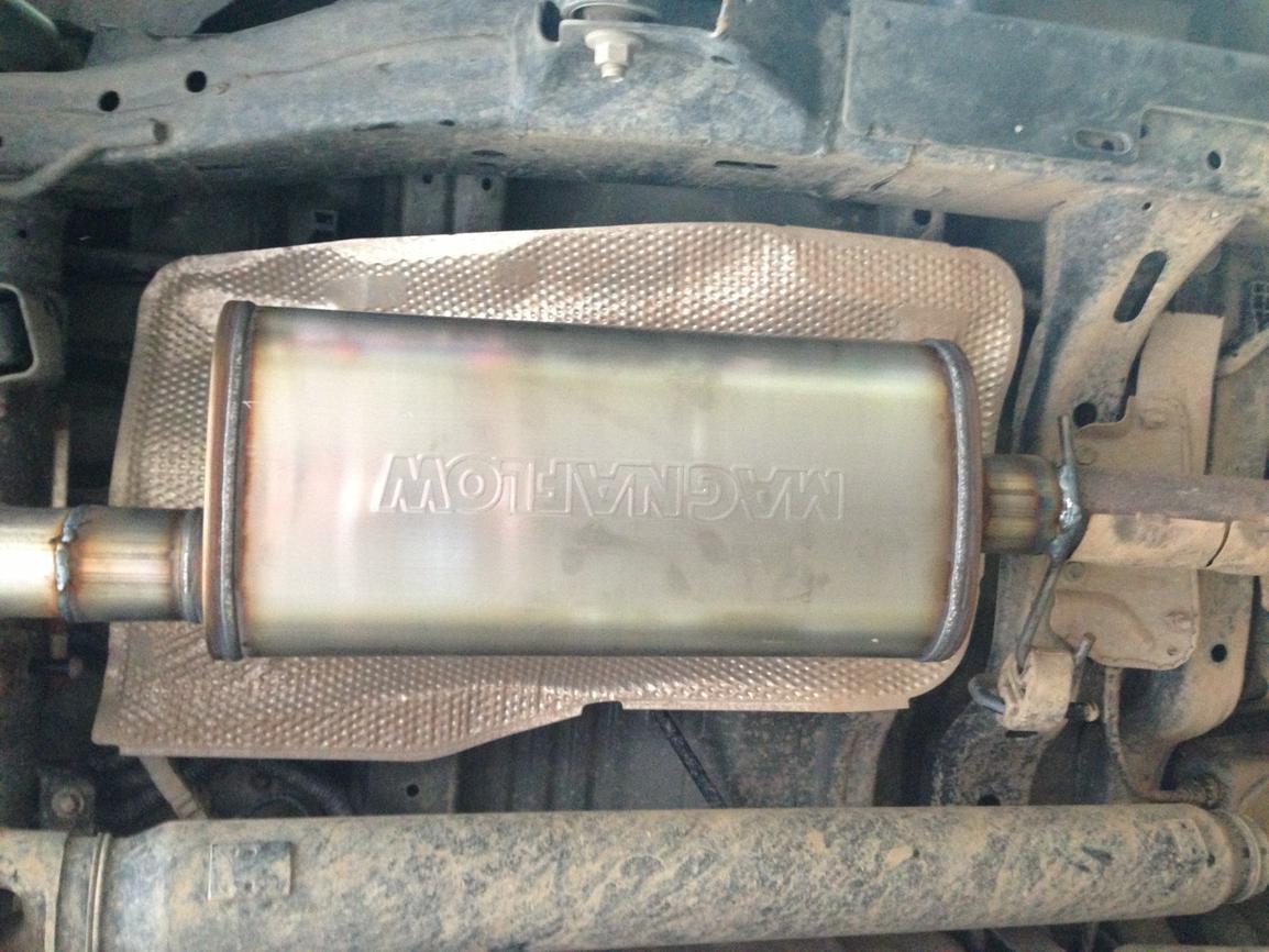

Next up for me was the TRD CAI. I think it looks great and sounds pretty good too. At the same time I threw in a Magnaflow 12256 which is the same that Harper7 and Sundog7121 have installed.
I used TOYSTRY's Fantastic Write-Up that is linked. It saved me a lot of hassle and gave me some confidence that I wouldn't trash my engine by installing it wrong. Every thing went smoothly with one exception: I failed to check the parts bag before ripping everything apart and of course I was short one hose clamp. :ybrick: Don't forget to check all the parts before you start taking stuff apart! Luckily I got to the hardware store a few minutes before they closed in the wife's car. I really have nothing to add to TOYSTRY's write-up except that putting the last tube on the throttle body is a PITA. I had a moment of doubt doing that part but it finally went on.
The Magnaflow 12256 muffler was put on by a local shop. It probably could have been a little cleaner but they also turned the pipe to the side for no extra charge. I had them notch out the fin behind the mudflap in order to tuck the outlet as high a possible. It is much louder now, probably a little too much for some peoples liking but it needed something more than the stock sound IMHO. I'm sure the next size up is a little quieter if that's what you want.
I ordered the CAI from TRDParts4U.com and the muffler from Amazon. They had the best prices I could find at the time.
Again, sorry for the crappy pictures. I have a nice camera but I never remember to use it! Ooops.
