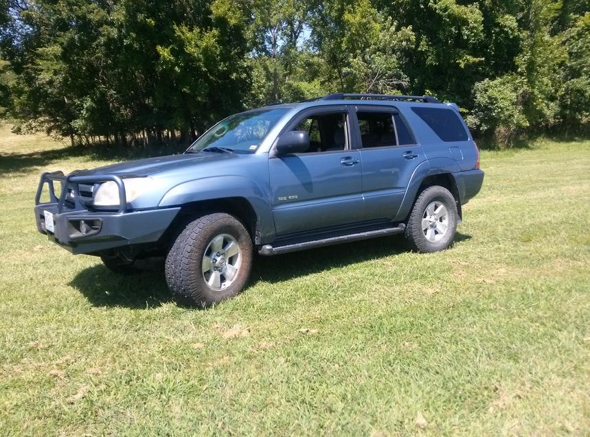

Here are some photos of the production version of the ARB bull bar for the 4th Gen 4Runner.
It took me longer to install this bumper than it took me to install my Daystar lift by myself. The instructions ARB sent were good, but there were just lots of little details to work out.
You might notice a few things, including:
1. The fog lights are not the IPFs. Instead of paying over $300 for a set of IPF fog lights that won't do much, I decided to pay $55 for a set of Pilot fog lights that won't do much. The ARB bar has some sort of proprietary mounting system for the IPF's but it only took a small measure of redneck ingenuity to get the Pilots to fit okay.
2. The inner fender liners were trimmed a bit, but I also took a torch and heated the plastic to the point of bending easily, and then bent them inward so there wouldn't be any rough edges showing,
3. On the 2003-2005 models (but not 2006), the ARB has a gap between the bumper and the grille. ARB advises us to cut up the original plastic bumper, but I didn't have the desire to chop up a pristine OEM part. Instead, I took a piece of vinyl drip guard for gutters and made the gap filler for less than $4.

I didn't have a method of weighing it, so no idea there...
Driving - the weight is not that noticeable. Ride and braking are about the same. I can feel the added weight when accelerating. The change in rake is the main thing I noticed. The front end sits about 3/4 to 1 inch lower than before, and this is detectable from the driver's seat. (I have a Daystar 2.5 inch lift)
One major thing for me to get used to is being able to see the bumper from the driver's seat. It's like driving around while looking through crosshairs. :gun:

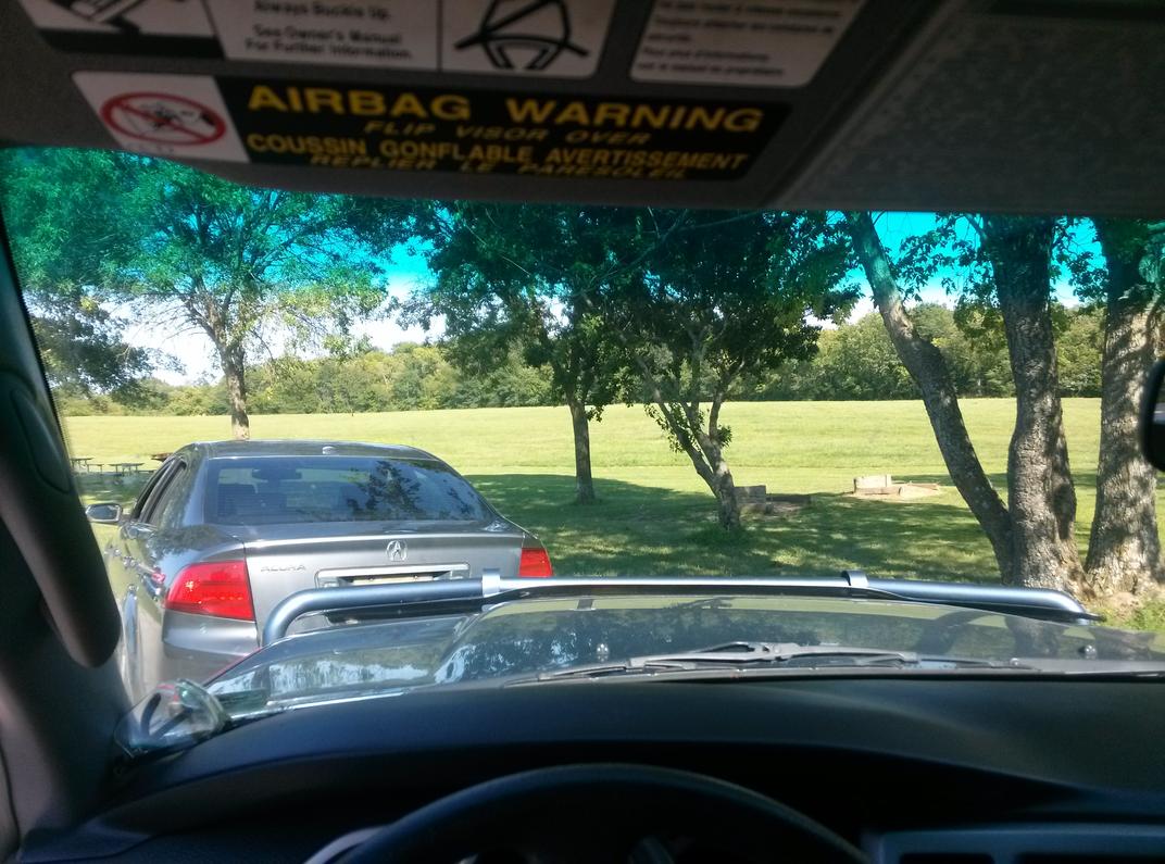

Is there anyway someone with the ARB bumper can take a photo from the drivers seat so we can get an idea what it looks like from inside the truck?
Thanks!

ARB look,
Someone asked what it looks like from the inside looking out with these ARB bumpers; while this doesn't really give you the full effect of the overall look, hopefully this helps.
Oh, and try not to judge my Acura... she's old and 400,000 miles... I know, put her to pasture... sheesh :sorry:
