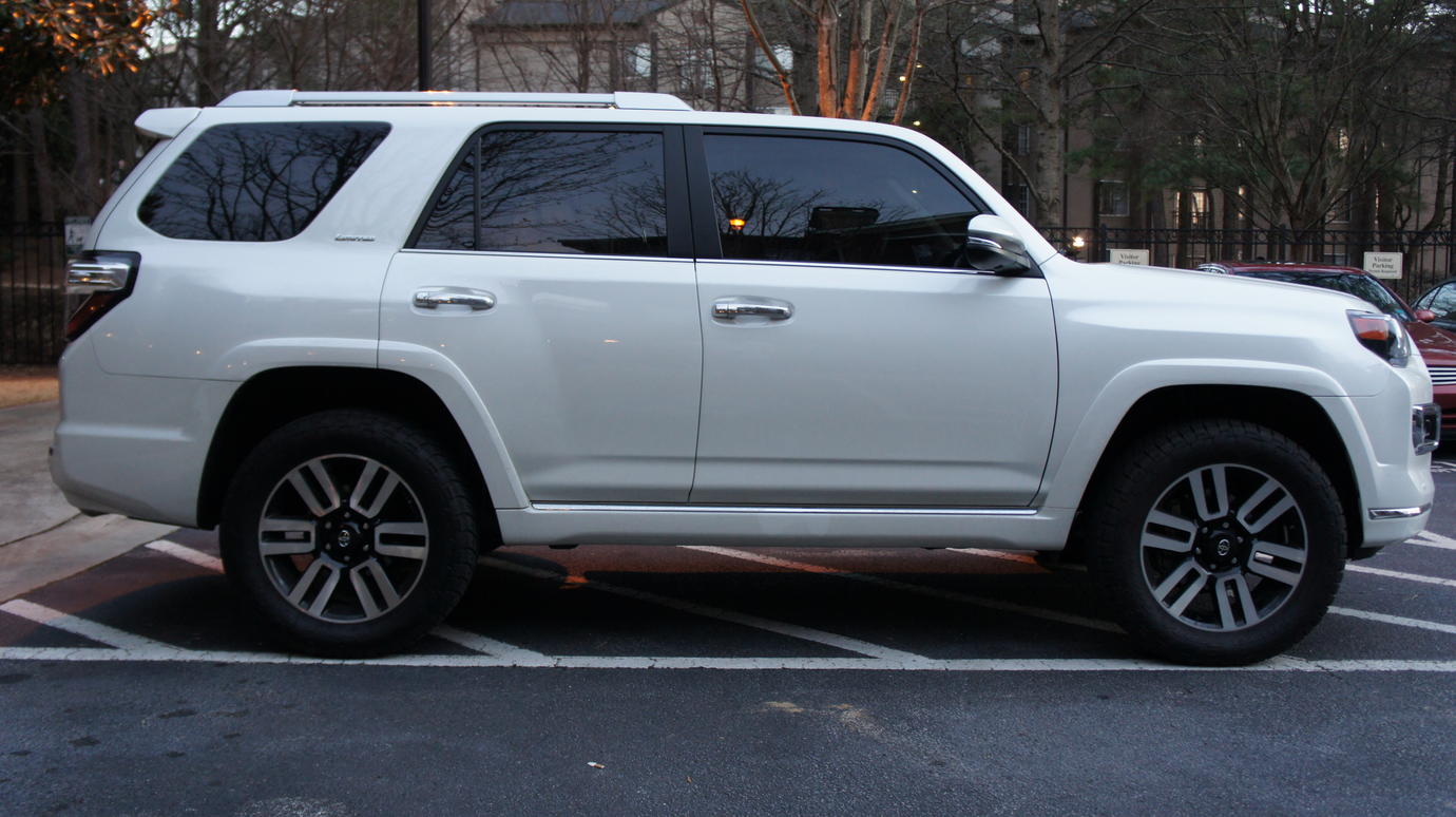

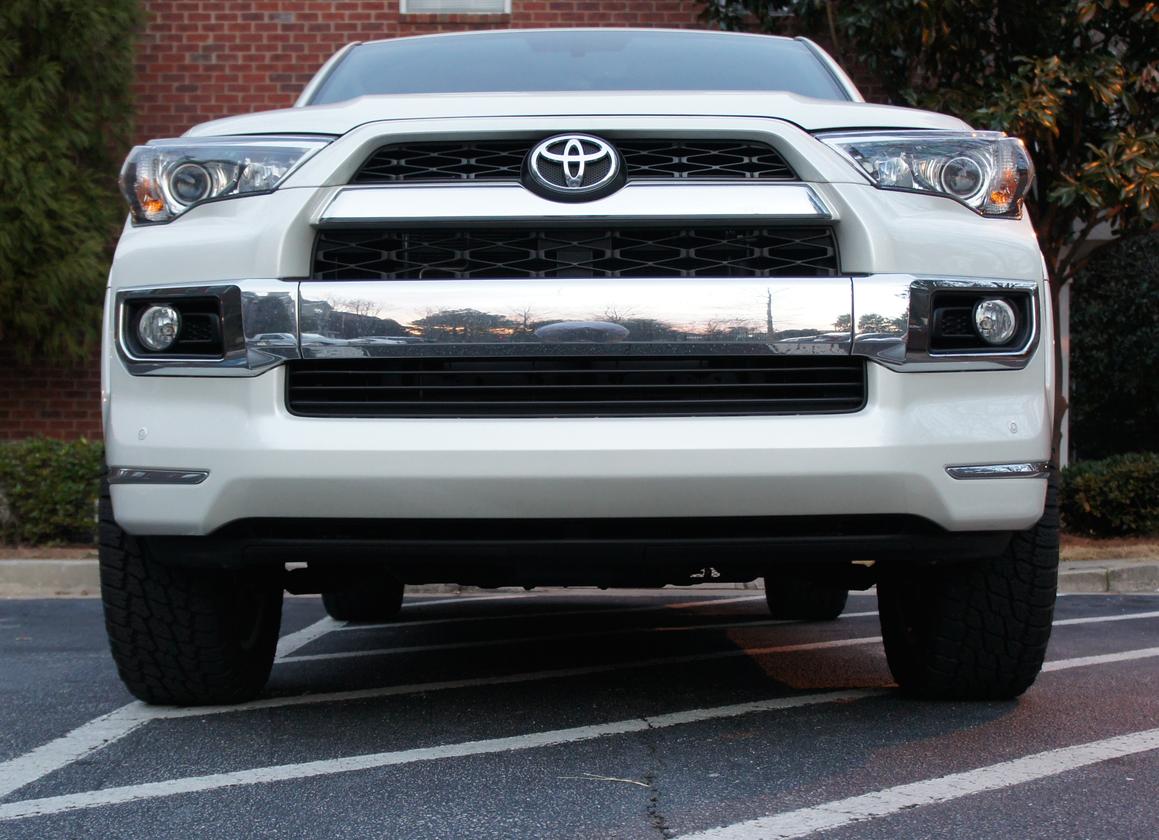

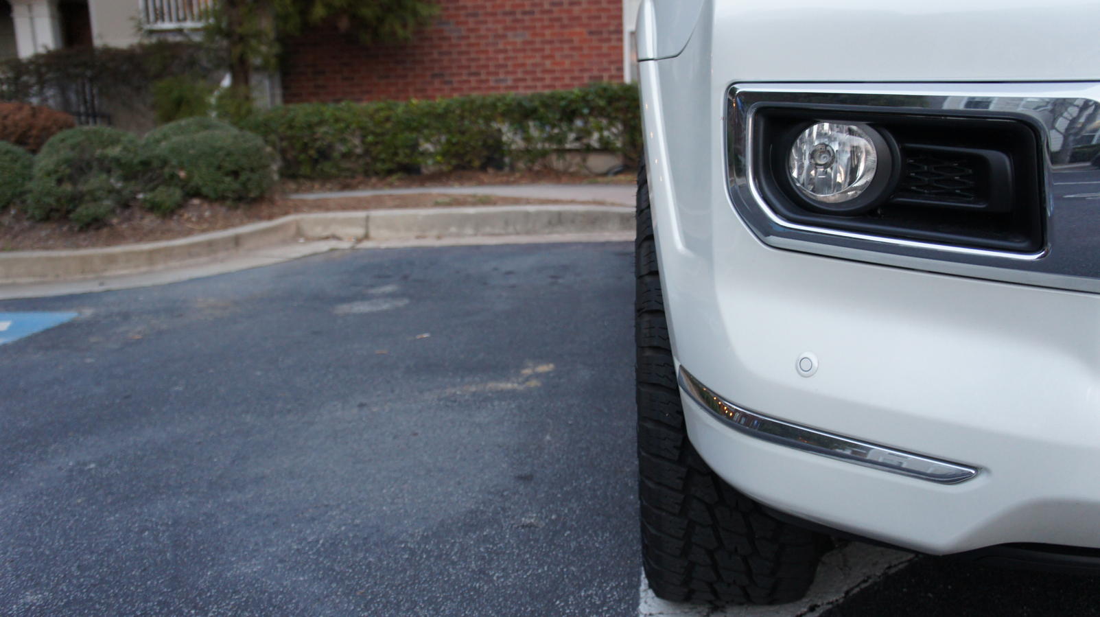

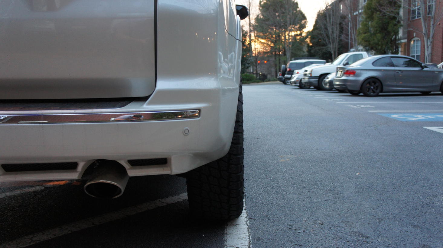

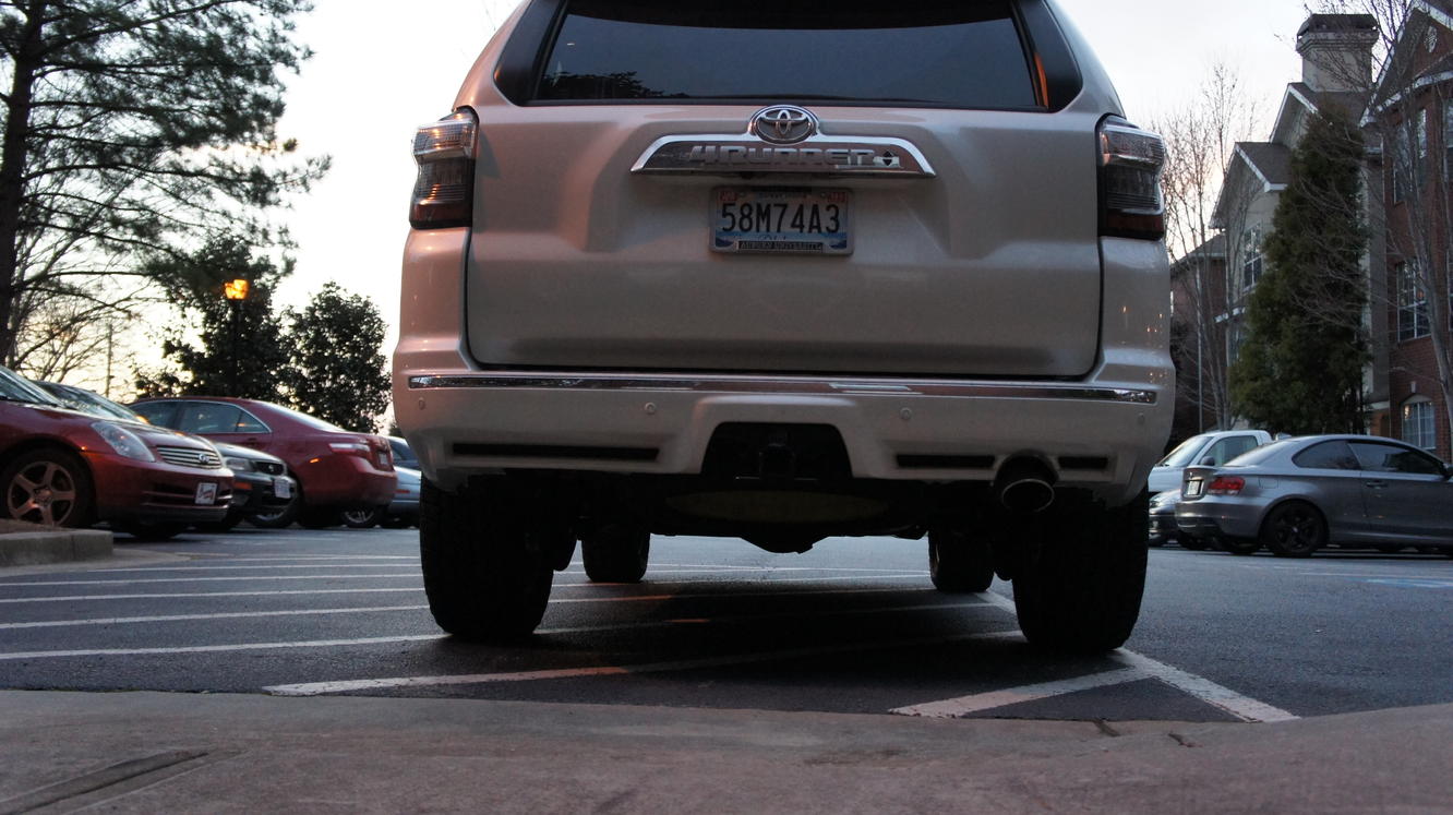

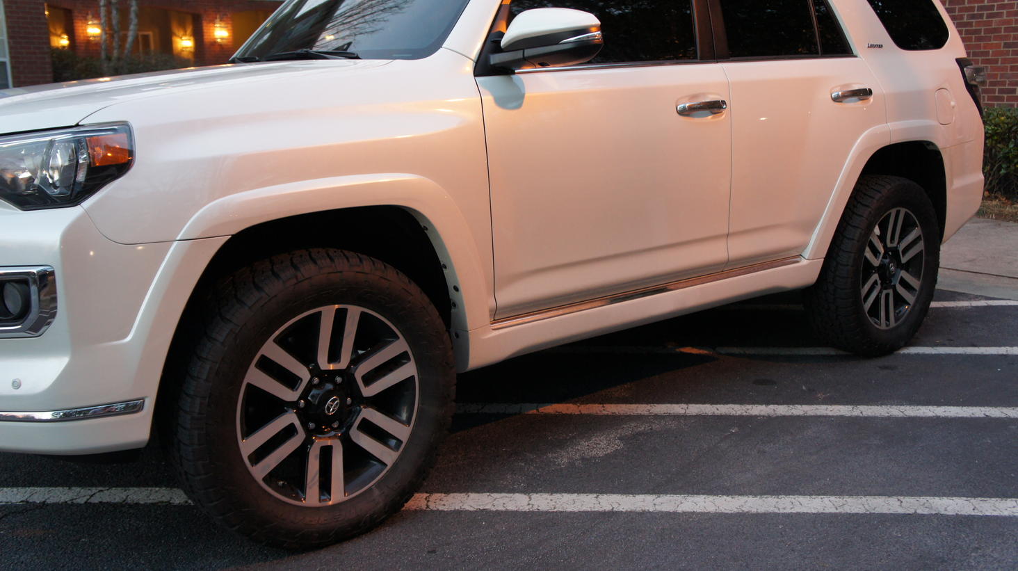

***update w/ pics***
I decided to install the spacers today.
275/55/20 Nitto Terra Grapplers
Toytec leveling plate
Allpro 1.25" spacers
Pics....

Your truck looks great! I have the exact same one and am looking at putting the same tires on. Do you have any rubbing with the Terra Grapplers? I'm installing the DS 2.5/1.5 levelling kit and possibly spacers.
How do you like the overall ride? Did it change much from stock?
