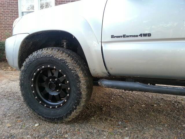

I have the Standard.
Cooper S/T Maxx 285/70/17
17x8.5
4.5 backspace
Front bumper trimming required. No body mount chop needed.
