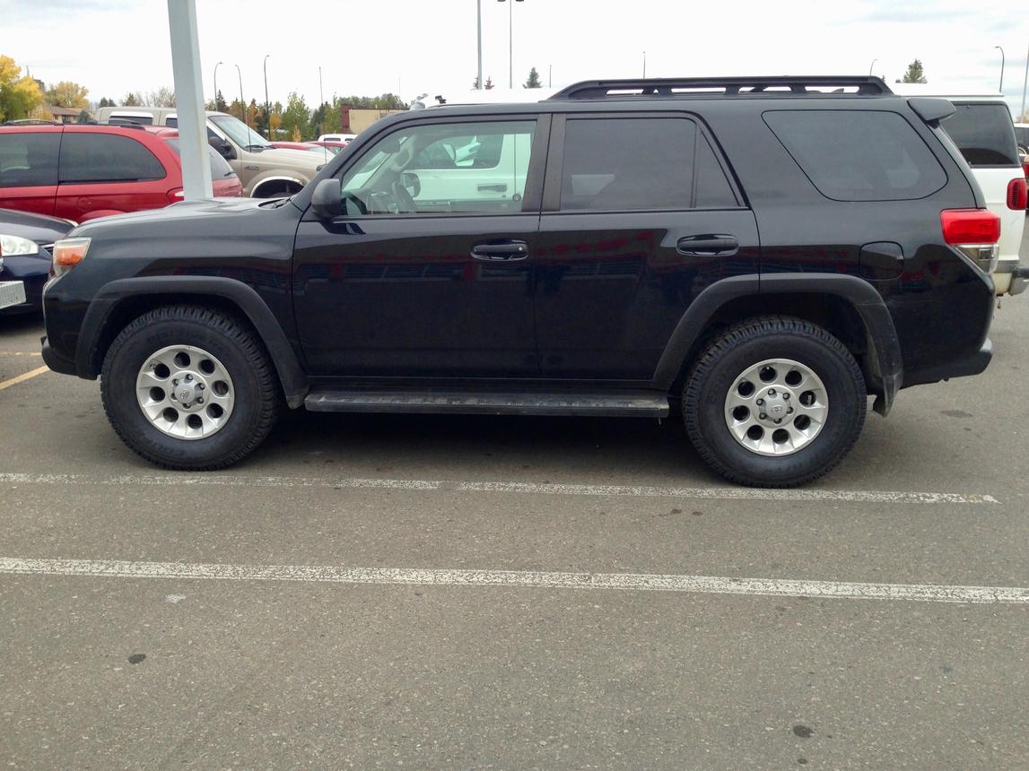

I'll be getting 285/70/17 Cooper AT/W put on my stock Trail tomorrow. I've already pulled the front fender liners forward and used the heat gun on the front mud flaps so hopefully there won't be any rubbing. I'll let you know how it goes.
As promised. No rubbing while driving around today on pavement or over curbs and speed bumps. I'll have to get out and have some fun with it soon and see if there is any rubbing under compression but it looked pretty good to the naked eye.
