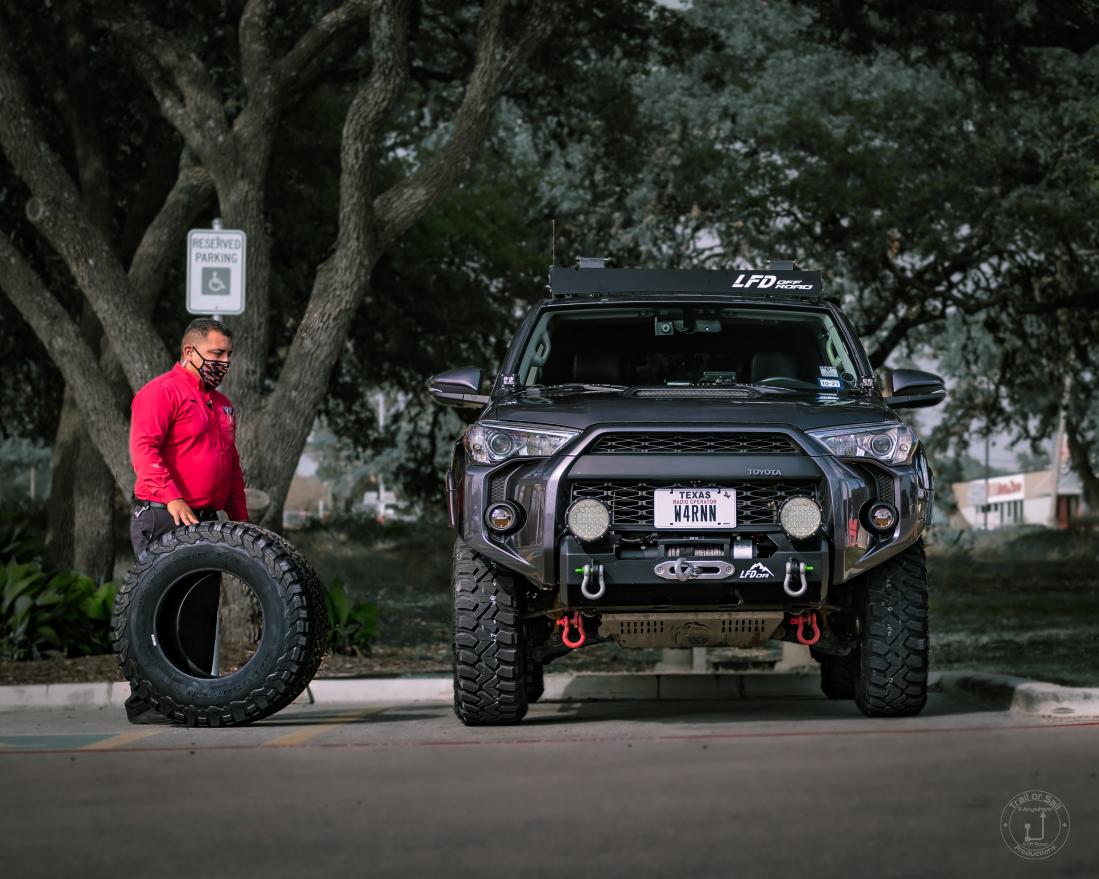

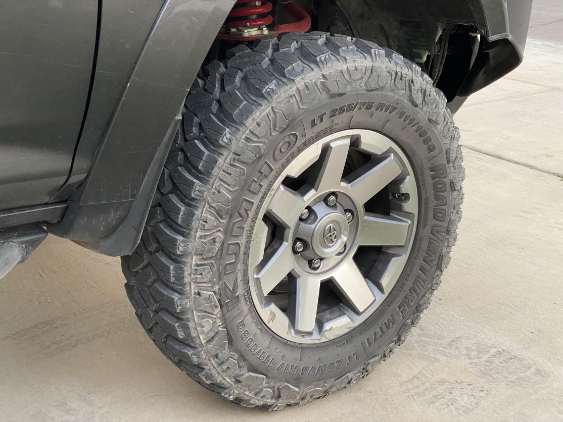

Well... I went ahead and got the 255/75R17 Kumho MT71s in Load C.
While I love the weight of them, I'm not sold on the looks quite yet. I am going to go ahead and order a set of 285/70R17 Kumho MT71s in Load E - just to see them side by side.
In general, these are not that loud on the highway, the weight is great, the roll resistance is fair, ride quality is really good, and the traction is amazing on dry roads on gravel. ...its literally just the looks that have me questioning my choice. Yeah, I'm that guy. :frusty:
I really appreciate the fact that my local Discount Tire has been so patient with my indecisiveness.

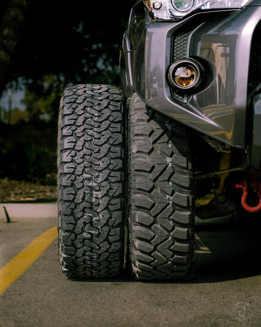

ALSO - For reference sake. Here is a BFG KO2 (AT) 285/70R17 Load E side by side with the Kumho MT71 255/75R17 Load C... These tires aren't comparable by design, but this gives you an idea of the difference in dimensions..
*****BFG KO2 (AT) 285/70R17 Load E*****​
*****Kumho MT71 255/75R17 Load C*****​

255/80/17 Cooper St Maxx installed yesterday. Dobinson IMS 2/1 lift. No rub, it's close on the front fender liners, may push them back just in case.
