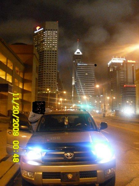

Getting HIDs in a non-projector housing like your 04 is a bad idea as you will get flashed and the housing itself is not meant to direct the light.

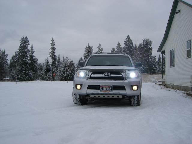

6000K for headlights 3000K for Fogs I can never switch back now haha. But one thing I need to do is install a relay with it...it flickers a bit

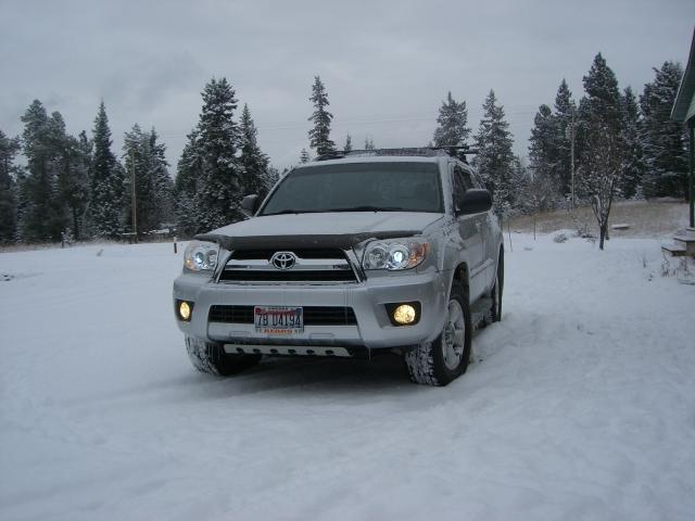

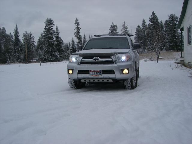

This is before I put in the 3K HID Fog Lights. Still haven't got a pic of that but those factory fog light projectors are awesome at spraying light evenly out and everywhere.
P1020466.jpg~original
what parts did you need to convert to the 06+ headlights and fill the gap?
WHich gap are you talking about? The one under the headlight, or the triangle grill gap? All I originally purchased was the headlights on ebay, OEM. And then I bought the filler panels on partznet and I want to say they were around 60 each, and the wire harness which was 25 ea. This created a small triangle gap where the headlight meets the grill. The gap looked like it belonged there, and to me it looked great. If you do buy the the filler panels make sure you buy the little clips that secure them to the body, because the 03-05 clips are different.
