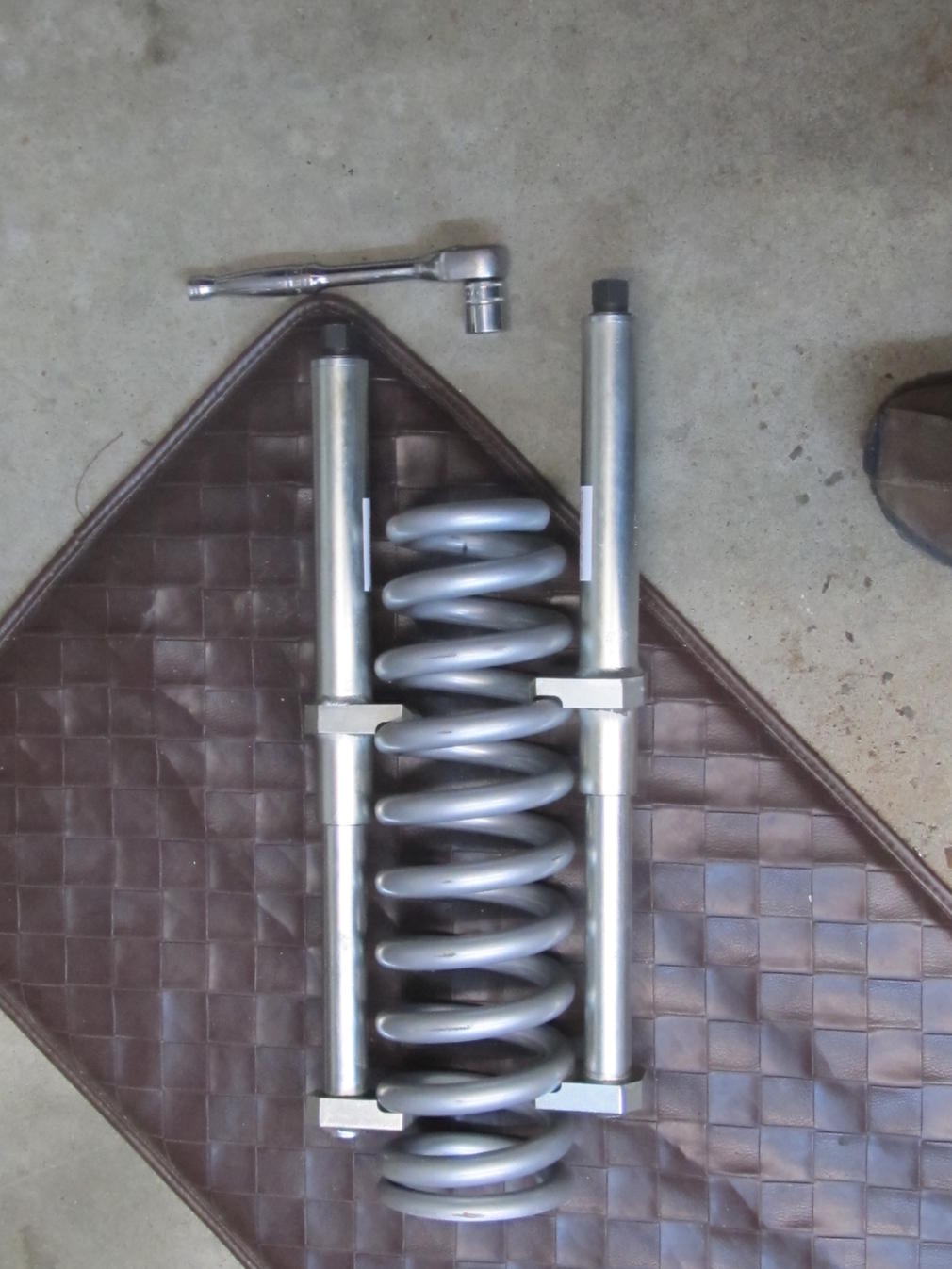

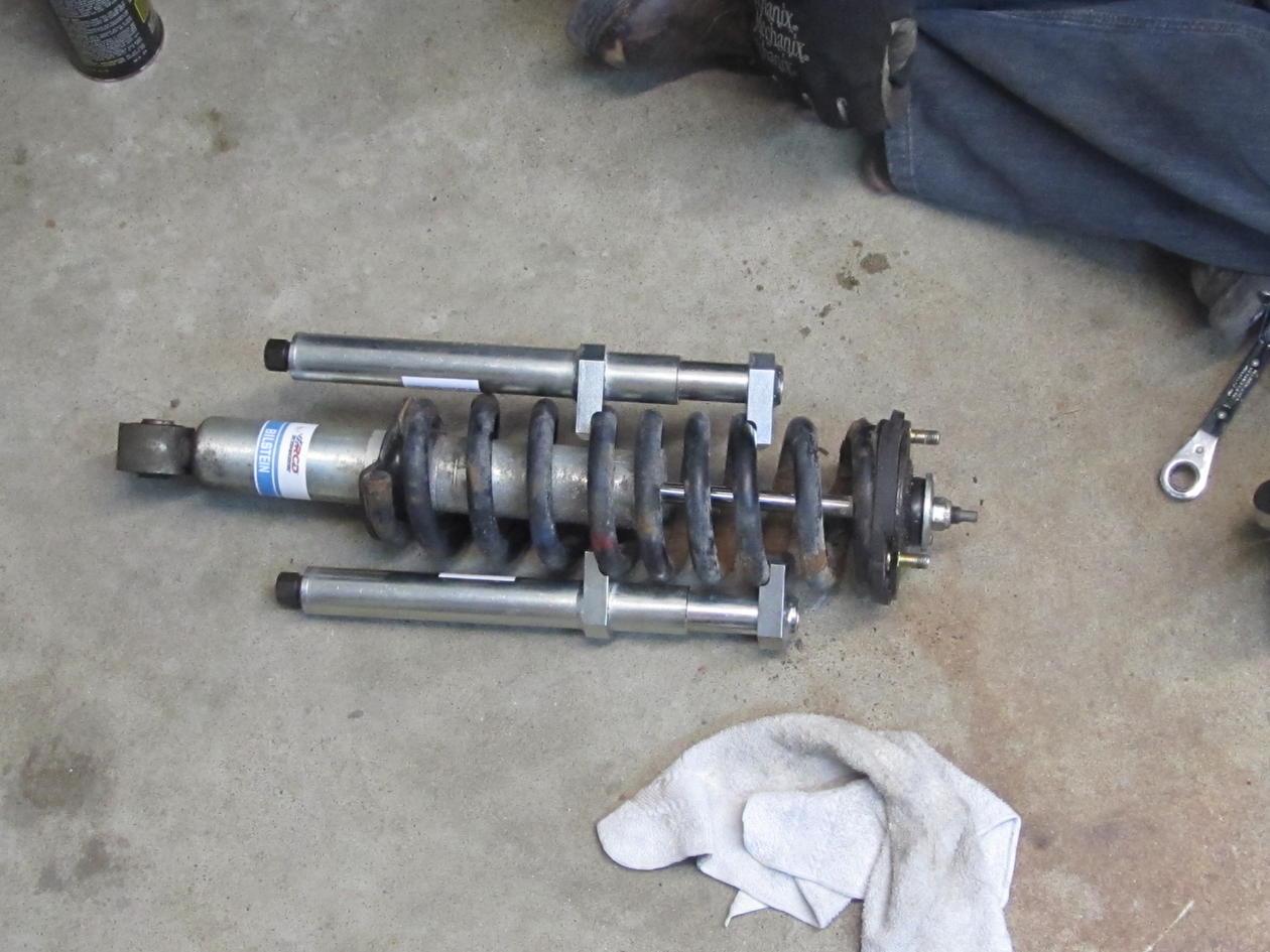

You're good to go with the Taco 5100's and the 3" Eibachs. Leave the shock at it's lowest setting (Tundra or Taco) for about 2.5"/3" of lift. If you place the shock higher with the Eibachs, You're gonna get wayyy more than you need and will surely anger some other things. Everything else posted above is perfect. Maybe think about replacing all the sway bar/end-link bushings with poly's whilst it's all apart. Check the control arm bushings while your in there (Toytec sells a ES poly set if needed). Also a good time to do LBJ's if needed. My preferred way to install the new coilovers is just unhooking the LBJ's anyway. Your CV boots will most likely fail after lifting and diff drop install. Keep that in mind. Them thar Eibachs require some pretty good spring compressors to get them on. Be careful.
