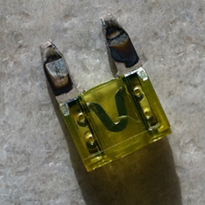

I cleaned the MAF (turns out it had been 30k miles since I had done it) and cleared the code. I also replaced this EFI fuse. I was surprised how bad it looked when I removed it. Much corrosion and pitting. 4runner seems to be running fine now. Starts up quicker too. Thanks.
