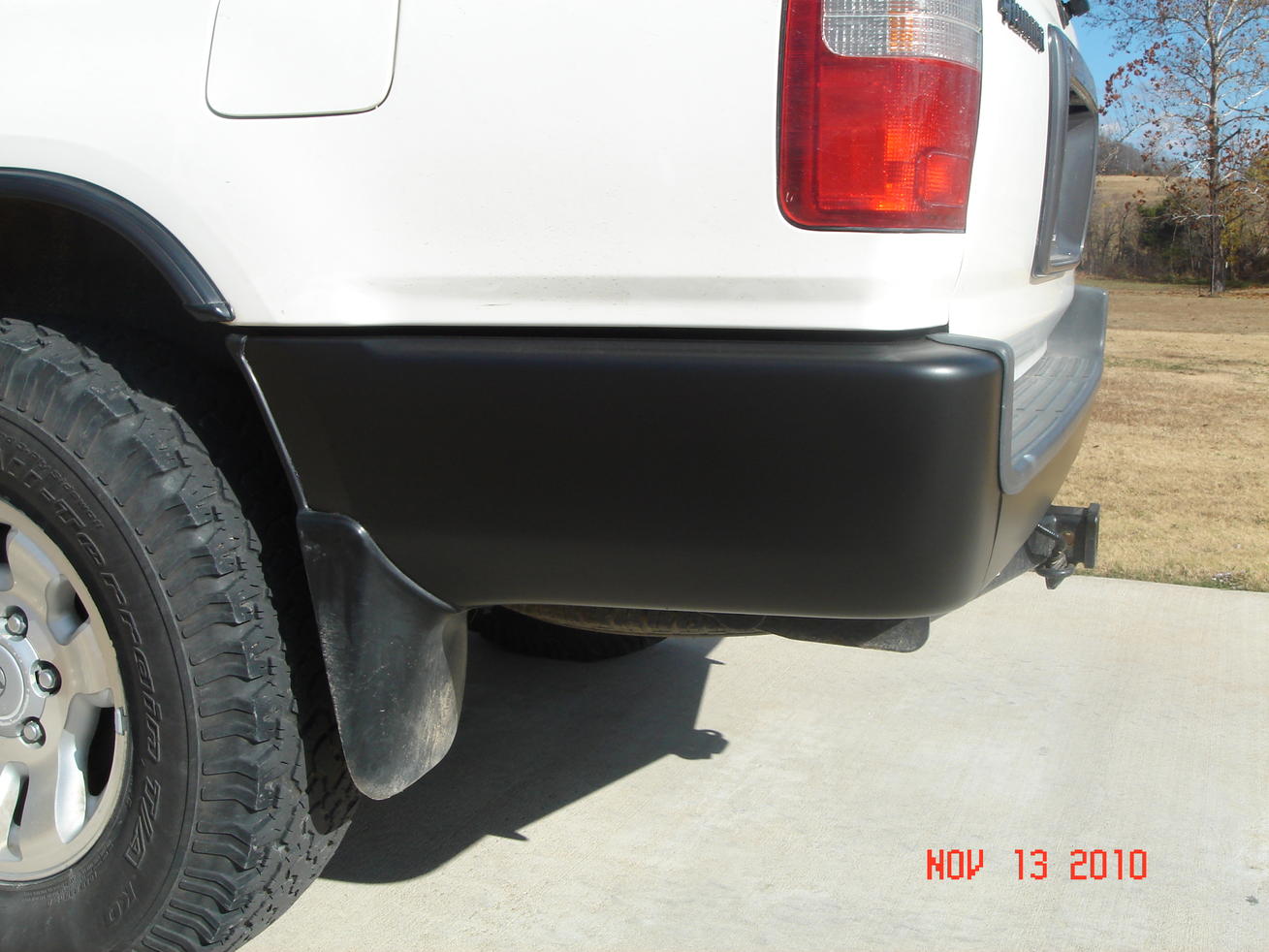

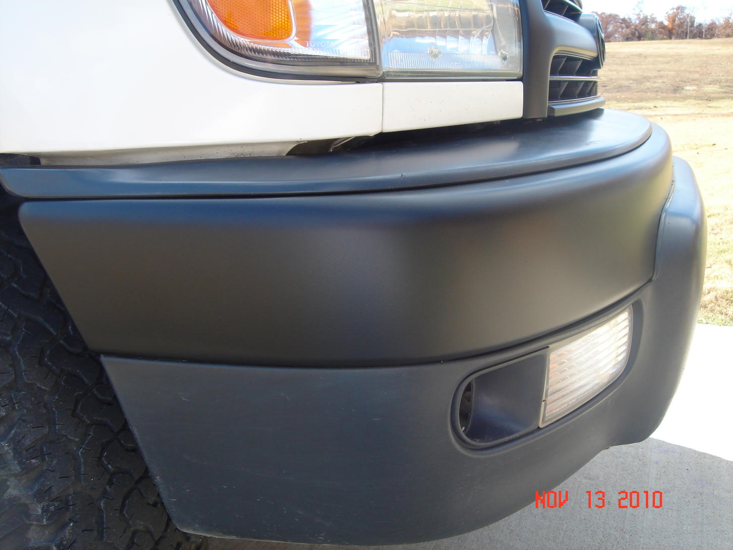

015.JPGhere are some pictures of my bumpers,grill,and chrome strip on flares all sprayed with plasti-dip what do u guys think

I just cleaned them and wiped them down with xylol taped everything off and sprayed them.Yes it will peel back off and go right back to chrome.I did a sample on a chrome thermostat housing before i did the bumpers after it dried i peeled it off just to see how well it would come off.The one thing i don't know is how durable it is i guess only time will tell i will keep you posted.

bak3rme i used two and a half cans i put two fairly heavy coats i didnt want to do to many cause im not sure how well it will hold up but so far so good. piperoo thanks for the input i realized after i pulled the tape and masking paper off that i should do the plastic parts on the bumpers but was unsure how well it would do on the plastic it did do well on my grill so i guess i should get out in the garage and finish it up .Thanks for the replies

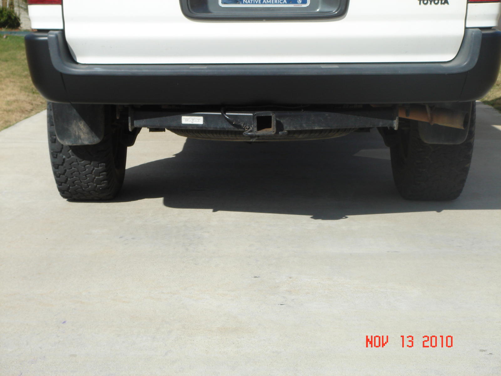

Can you post a pic of the rear bumper with the plastic part Plastidipped too please?
