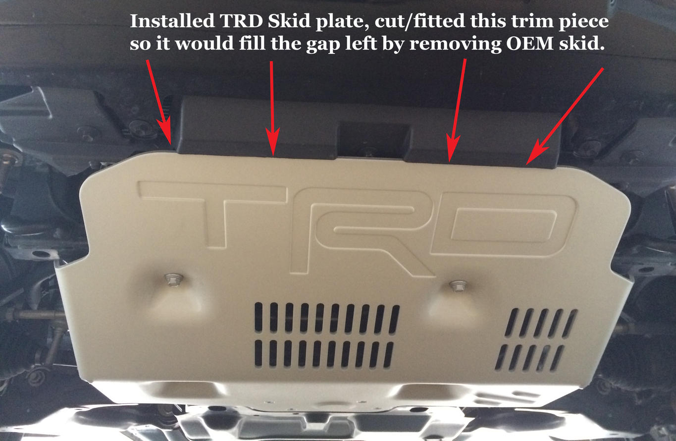

When the TRD Pros came out, the port was famous for throwing them away instead of cutting them to fit the gap.
Here is a pic on my other T4R after TRD skid plate install.
130770d1614643289-trd-pro-parts-trd-skid-t4r_1-jpg
The factory instructions for installing the TRD skid plate says to discard that panel: https://images-na.ssl-images-amazon.com/images/I/817mB4nXCGL.pdf

I took a few minutes and cut mine on both of my T4R's and put them back on. When I remove my TRD skid, trim stays in place. It doesn't get in the way

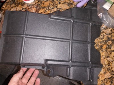

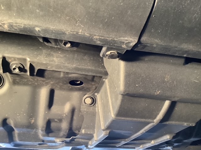

It has 4 clips that go into the engine skid. and I remove it so the other plastic part that it covers in front can be removed so I can remove the engine metal skid hooks .
There's 2 plastic pieces, the wide radiator cover in the front with an air scoop and the air duct that tunnels air from the scoop right in to the hole in the skid plate. Which is the part I think the OP posted. I suspect most 4runners are missing this piece because it gets tossed in the trash by the tech doing the first oil change.

This must be an older 5th gen 4runner or other gen 4runner. I installed the TRD skidplate on my wife's 2020 4runner back in July. The standard steel skid plate, which sits under the oil filter, was replaced with the TRD part. The TRD/Toyota instructions said to not reinstall the other plastic cover that Saker posted. I found that odd, but my guess is they said not to reinstall because plastic cover would need to be modified to fit like Saker noted.

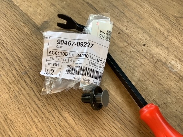

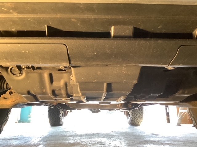

from a 2015 Limited. The air duct piece (Engine Air Intake Hose 5281235010) and the horizontal piece (Radiator Support Air Deflector 5210135700) both need to be removed before the regular skid plate can be removed. You can see one grey, round plastic clips on the Engine Air Intake Hose. I have "trim tool" to remove those. They are difficult to remove with out the tool. Its not much hassle with the tool. I like the protection these two covers provide. I thought the air duct piece/hose was only on limited awd and the horizontal plastic radiator support air deflector was on all models. Research shows Sr5 with the "appearance package" also had the Engine Air Intake Hose.
