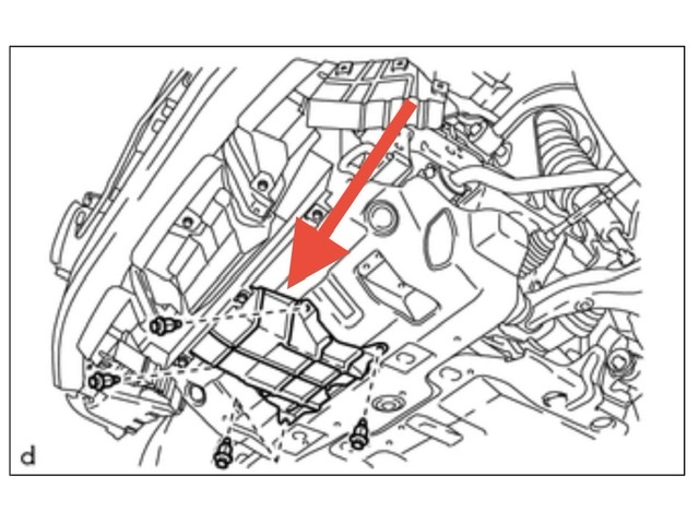

I was on the Toyota TIS today and looked at the Repair Manual section. Under the oil change procedure it had you taking off the Engine Under Cover Seal. Then to “REMOVE COOL AIR INTAKE DUCT (for 4WD with Intuitive Parking Assist System)”,
Going to the link provided for this it shows a drawing of this duct.
So it seems the Limited models which have Intuitive Parking Assist (parking radar?), and have this cover/duct to channel air to help cool the system I presume.
OP, you have a Limited?

Interesting. I bought my 2016 new and have done all oil changes. That "scoop" wasn't there from day one. The hole on my skid is open to front with only wire mesh in it. Now I'm curious and will have to start looking under the fronts of parked 4Rs, although that might look odd. 8^) Thanks for info.
I worded it poorly but it's explained with pics further down the thread. The scoop and duct are pieces of the same package but the scoop is clipped to the radiator deflector and doesnt need to be removed to take off the skid. The tunnel annoyingly needs that pry tool to get off to do an oil filter change. Long story short you aren't missing anything.
from a 2015 Limited. The air duct piece (Engine Air Intake Hose 5281235010) and the horizontal piece (Radiator Support Air Deflector 5210135700) both need to be removed before the regular skid plate can be removed. You can see one grey, round plastic clips on the Engine Air Intake Hose. I have "trim tool" to remove those. They are difficult to remove with out the tool. Its not much hassle with the tool. I like the protection these two covers provide. I thought the air duct piece/hose was only on limited awd and the horizontal plastic radiator support air deflector was on all models. Research shows Sr5 with the "appearance package" also had the Engine Air Intake Hose.

I'm new to our 4Runners since I just bought my '23 Limited back in September and have only done one oil change since I got it but it looked to me like it may be a cooling duct aimed at the front diff since the rest of the cover blocks the air that would cool the front diff.Just a thought.

I have been running without mine and I have had zero issues. It actually would hang down on my 2012 limited and I removed it as well as that black plastic trim below the bumper to have better access to my front recovery loops. I have the factory skid plate and that air duct guides air through the mesh of that front skid plate. if you remove it air can still get through but maybe the odd leaf etc. might get stuck in there. I've driven through deep snow, mud, water and it's fine don't worry about it

My view on that is it keeps the air from exiting through the least resistance (out the bottom) and with that closed it forces the air to pass through the radiator. Thats why I cut mine and re-installed it.

Neither our 2014 SR5, nor our 2023 ORP came with this plastic ducting piece. Both came with the plastic shelf that goes between the skid and the bumper but that gets deleted when you install a TRD skid. The radiator has a 360 degree shroud directing all air to the fain.
